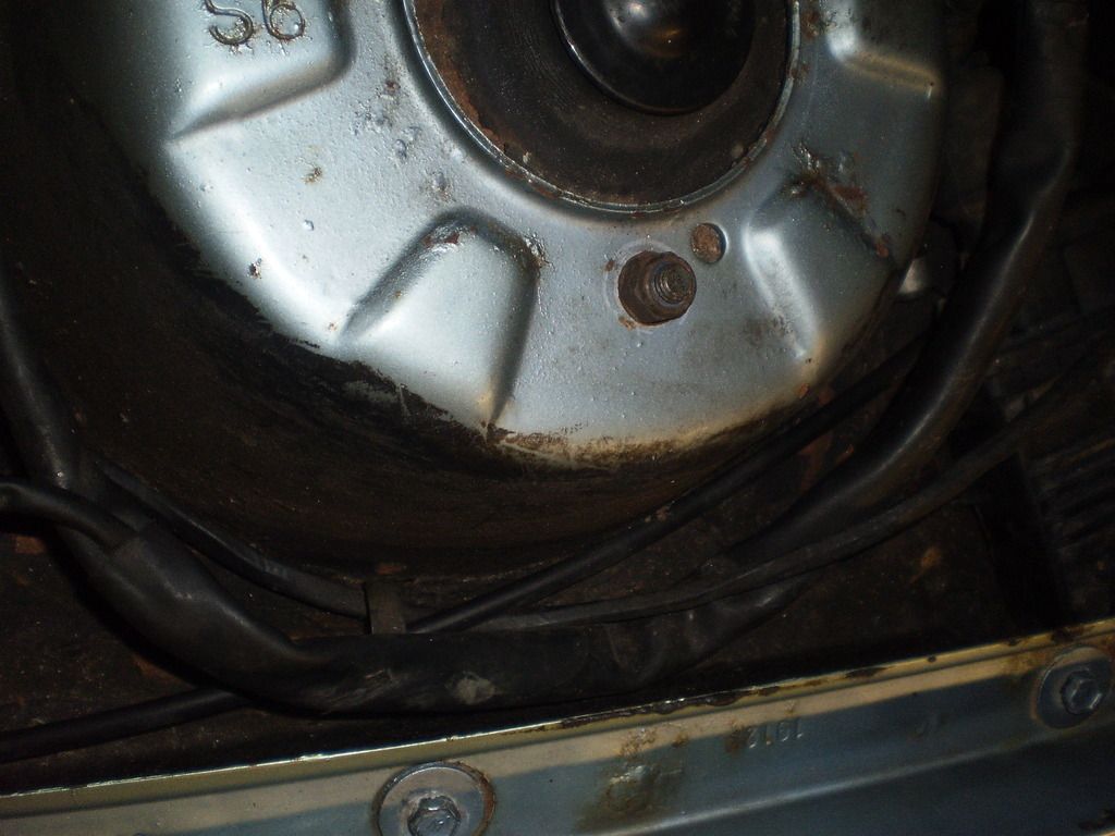

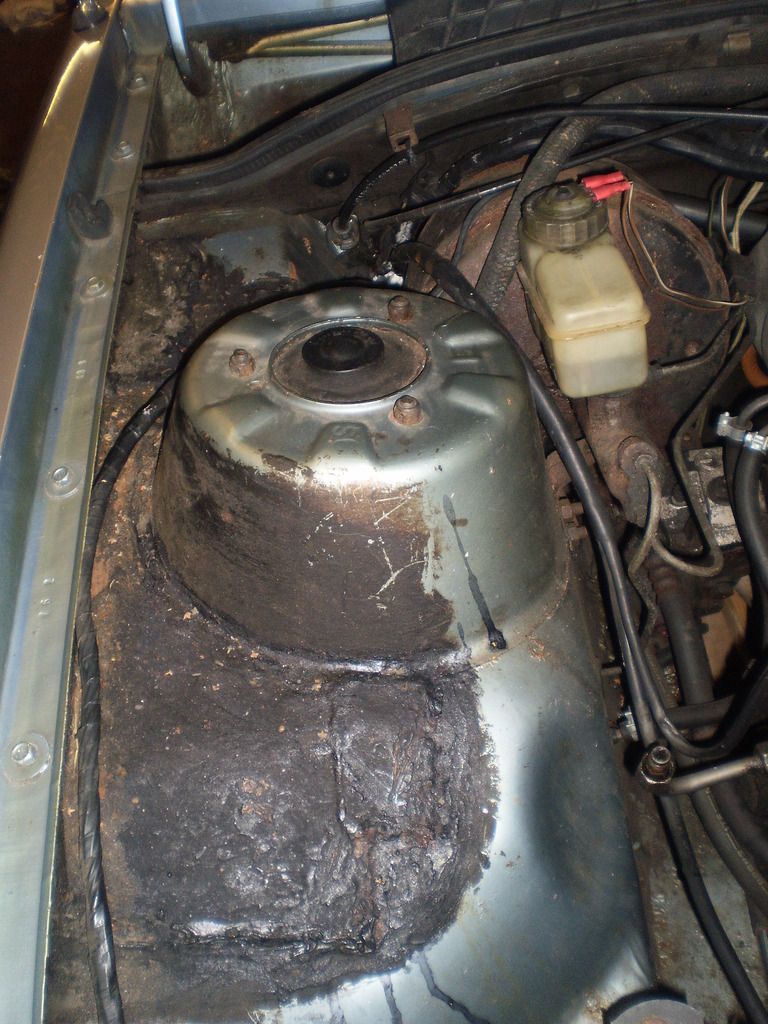

The strut towers have been welded-see below
They look very solid from below and above.

Steve, if it were mine I'd whip the front wings off and have a look what the panels are like underneath.
I wondered if a strut brace would stop the towers moving about?

Thanks for the advice Bren- I know the towers are a weak point-I've had a good look at them and think they are pretty solid-but as always you never know unless you dig deeper!

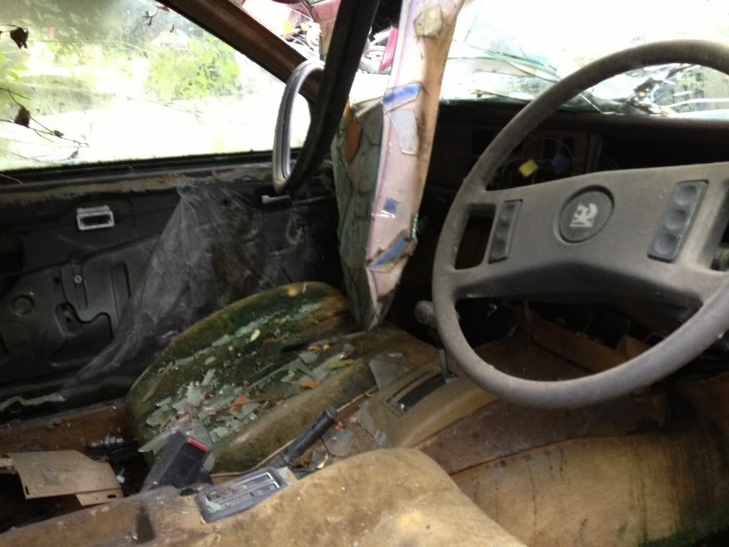

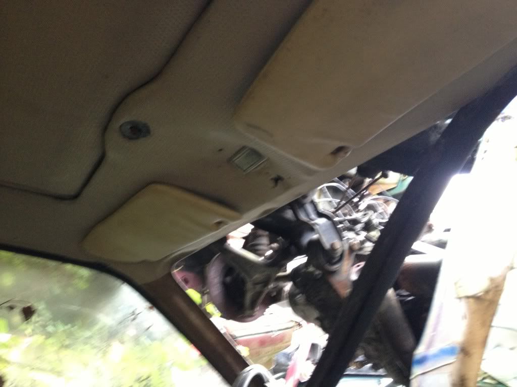

I found a few pics of the one that's been in my local scrappy for years, as you can see it's " Royalee fucked" but may have some useable bit's for you, can you do a wish list as I'll likely be down there over xmas break and see what I can salvage off it for you, I know you wanted headlight wiper mech but can't remember what else

Thanks Omegod-does look a little rough!
I am after the headlamp washer motors and mechanisms-but they look a little hard to get at!
