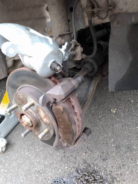

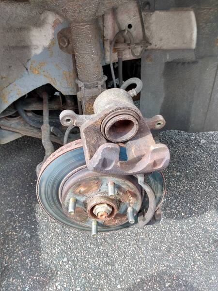

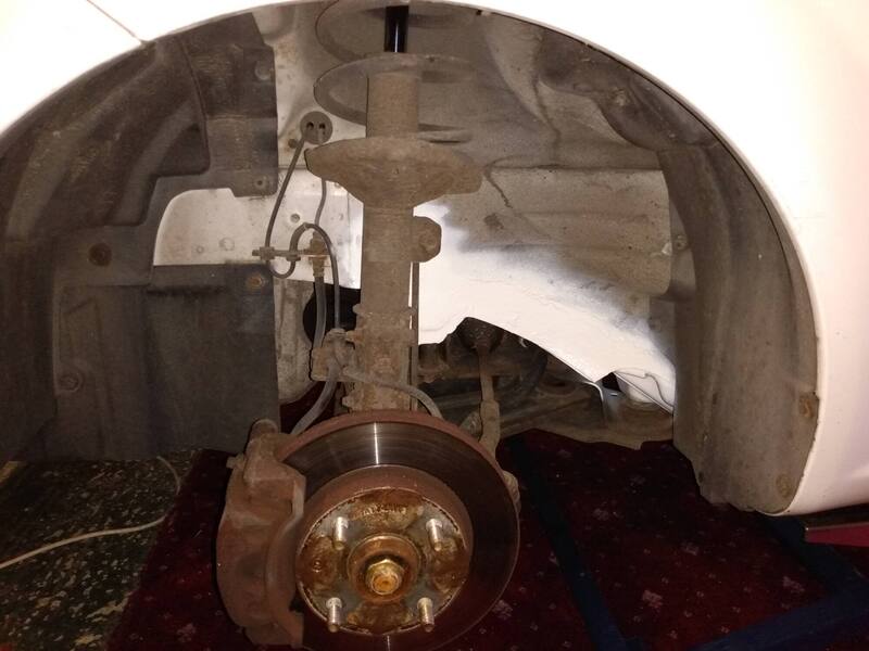

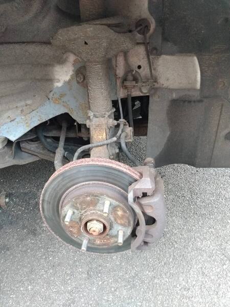

Full of optimism I went out, jacked the Daewoo up, put it on a stand, removed the wheel and dismantled the caliper. It was binding quite badly, I couldn't turn the wheel in neutral with the wheel off the ground so it definitely wasn't happy.
I got the caliper off the carrier with a crowbar and screwdriver, undid the brake fluid reservoir cap and then tried to push the piston back into the caliper with a g-clamp
And it wasn't having any of it. I should have stopped here in hindsight and put it back together again. But I didn't. I decided that the best thing to do was gently push the piston out by havign my daughter press the brake pedal, this went fine, the piston slowly pushed out a bit allowing me to inspect the condition of it.
thats not great is it? I didn't go any further than this, as I didn't want the piston to pop out entirely. Seeing the state of it made me think I needed at least an overhaul kit with piston and seal but this would need to wait for another day. I then tried to push the piston back in. NOPE
Because its come out wonky hasn't it? FFS. I spent about 2 hours wiggling, clamping, twisting, and using plumbers wrenches to try and straighten the piston up and get it to retract but it wasn't playing ball. I wedged both pads in against the U-shaped other side of the caliper and then used the brake pedal to push the piston out to try and straighten it up, but all that happened was the piston pushed out lop-sided again. FUCKING THING.
I've now given up, I put it all back together minus the pads on that side and need to carefully consider my next move. I can take it to my local garage if I go slowly and only use the handbrake - so possible if I either go late tonight or early tomorrow morning. They may have tools that will allow them to extract this piston and replace it with a new one, or do we think its too far gone now (as the surface is pretty pitted and is clearly getting jammed on the bore of the caliper?) and its new caliper time? TBH the brake fluid could really do with being changed and the garage will be able to do this at the same time with their gear but it'll not be cheap I fear.
Any other ideas people? How do you straighten up a piston into a caliper? its not having any of it, even with force spread evenly using a bit of scrap 2mm steel over the end of the piston and using a stout g-clamp, it just refuses to retract. Luckily, there is about 3mm clearance between the end of the piston and the inner side of the disc so it can still turn without contacting the disc and fucking that too.
Incidentally, the sliders still slide fine, its definitely a damaged piston thats causing the binding.

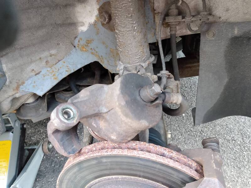

An entire brand new caliper is £80 from ECP after discount and with rebate from returning the old one. Realistically the work at a garage isn't going to be less than that is it? And all* I'd need to do is clamp the flexi and undo the union on the old caliper then screw it into the new one, undo the clamp and bleed it through a bit, right?
Yes that's right that's all you need to do, trying to sort the knackered one just isn't worth the aggro.
Looks pretty borked.
You could put something square and solid in that just fits between the furthest out part of the piston and the "fingers" on the caliper and pump the pedal to force the piston out onto it to and square it up, then push it back in, a little rotation of the piston wouldn't hurt to move the corroded patches away from each other.
With a bit of lube and some wet n dry that would buy it a bit of time untill you get a new caliper.
If you were desperate you could get it going again with some wet n dry and a bottle of brake fluid, pump the piston all the way out and disconnect the caliper and get it onto a bench.
Clean the piston up with WD40 and fairly fine wet'n'dry and possibly also the bore. Get the seals out with a pick tool and clean out the grooves too.
With the rust and gank cleaned up as well as you can reassemble, lube up the seals with brake fluid and the piston should go back in under firm hand pressure.
If the piston is pitted after cleaning it will need replacing eventually, the pitting will wear the seal but it'll be reet until you can order a new one off eBay.
Or just get a rebuilt caliper from ECP, depends on your £/time ratio.
I tried twisting the piston in the bore but it wasn't having any of it, I also jammed the pads one on top of each other in between the piston and fingers of the caliper, but pumping the brake pedal - even with the engine running - only resulted in the piston coming out the bore wonky then jamming. It resolutely refused to retract at all, or come out - so even if I got a new piston in an overhaul set I couldn't get the current corroded one out the piston. I suspect any more force will also bork the caliper so easier to just replace it I think.
It'll need doing either way, once I factor in an overhaul kit, brake fluid, wet n dry and seal I'd halfway to an entire new caliper anyway, and thats before I ham it all up after spending 11 hours in the sleet getting this one out!
Gotcha, think I missed that you had already tried pumping it out further.
Unless you are hell bent on saving every penny a rebuilt caliper is always less faff.
Just been out to check on the union 'twixt caliper and brake line and its a banjo bolt, not a 'normal' brake union fitting like I had on the Geep. Anyway, I tried loosening the hex bolt a bit (expecting it to be seized solid) and to my amazement it cracked off and brake fluid seeped out. I did it back up and squirted it with some penetrating oil for good measure, but that bodes well for caliper replacement in the week, should be a case of whipping the bolt and banjo thing off, giving it a quick wipe off to remove any muck and then fitting it to the new caliper before I lose too much brake fluid. Hopefully it'll be relatively painless and braking performance will be restored.

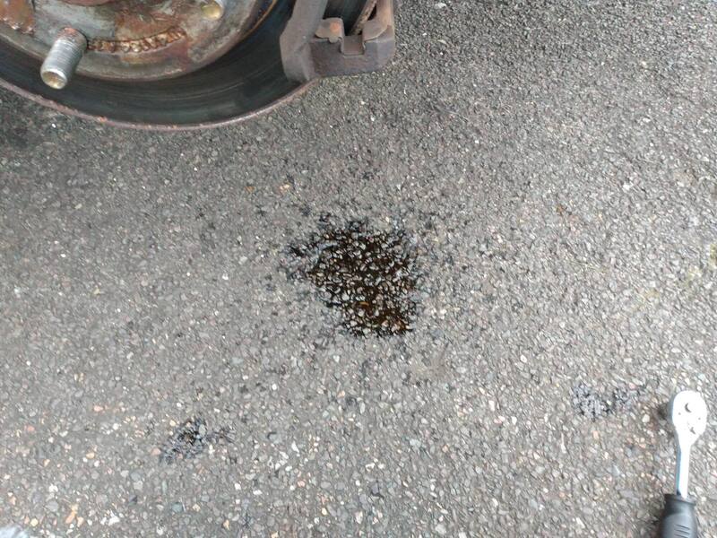

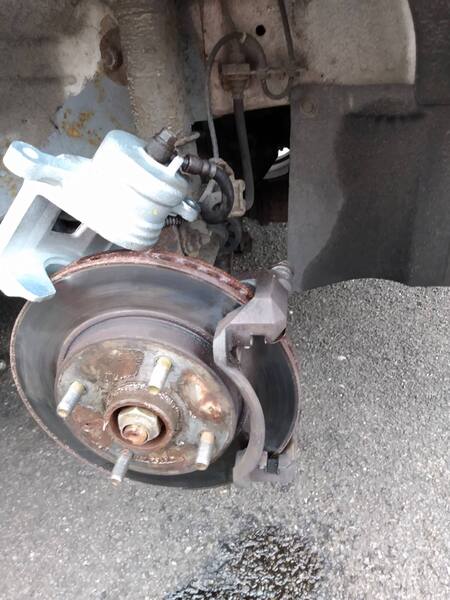

New caliper in old box.
I deftly undid this with my rolson mini socket set, rapidly wiped it all off with a cloth and then screwed the banjo and bolt to the new caliper. Then remembered I'd forgotten to fit the copper washer so took it all off again and then did it back up properly. Leaving the scene looking like this
only minor brake fluid leakage all over the disc, and on the road
I sprayed the disc and general area off with carb cleaner and wiped it all up with a rag, leaving this

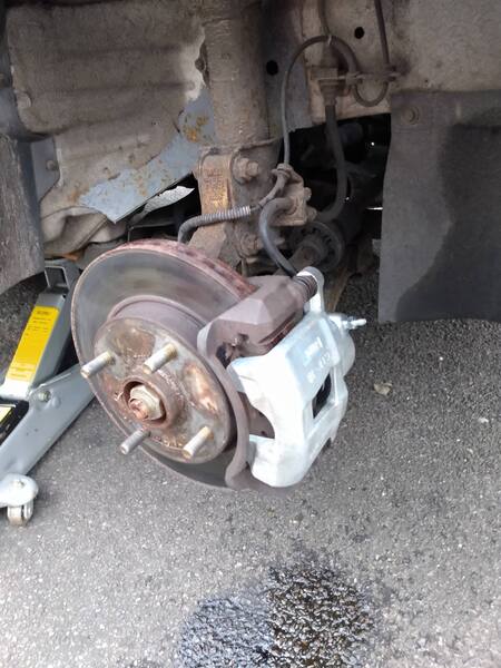

Looks alright. Next up was refitting the pads to the carrier which was painless. I cleaned them up with a wire brush so they fitted properly and copper-greased the anti-squeal shims into place. There is plenty of meat left on the pads and I didn't want to buy two new sets because I'm a mingebag.
Next up, fitting the new caliper over the old carrier and whatnot. Easy enough as the piston is fully retracted giving loads of space to play with
In place and bolted up to the sliders. As you'll be able to see, there is loads of gap between the new piston and the old pads, so I started the car up in P and gave the brake pedal a good squeezing several times to get the slack taken up. This pushed quite a bit of the manky old fluid down into the new caliper so i topped the reservoir up with fresh dot4.
Wheel back on and tightened up, and tools put away.
With the slack taken up, I went out for a tentative first drive to see what it was like. I'd not bled the system yet, so apart from 3" of pedal travel with no discerable effect (underpants in wash at time of typing) its loads better. No binding, car brakes nice and straight even under hard braking from 50mph on an A-road. Driving normally with hands off of the wheel it gently pulls to the left with the camber of the road and having got back from a 20 minute run all 4 wheels were still barely above ambient temperature, suggesting the bind was indeed only that wheel and its now fixed.
Tomorrow I need to bleed this caliper, but I'm optimistic that the bleed nipple will cooperate as its brand new* (refurb) rather than rusted to buggery original. I also need my father in law to assist with the pedals end of this operation and he was out this evening so it can wait for now.
I aim to do the bleeding tomorrow and then be back to full working order. I'll take the totally FUBAR old caliper back to ECP at the weekend for my £50 rebate. Incidentally, I'm astonished that if I get a £50 rebate on this caliper, Pagid can actually make money selling them to the public via ECP at £80 a shot. Considering refurb costs, new pistons and seals and stuff, distribution and the cut that ECP need to make on this stuff (nevermind delivery to the branch) £30 doesn't seem like very much? Whatever, not my problem. I have (spongy) brakes again now.
Are the sliders in a condition to slide and suitably cleaned and lubed?
Yes sliders are all clean, freshly greased with silicone grease and boots are in good condition. I have a spare set of boots if needed, but as the current ones are OK I left them alone. I need to find a short bit of hose to bleed the caliper with now...
You can bleed single handed if you're careful and keep an eye on the reservoir. Sometimes you can simply crack off the bleed nipple and let it sort itself out if you leave it for a while.
Caliper bled and normal function restored, my father in law did the pedal while I opened and shut the bleed valve into a jar of new brake fluid. It farted out a big bit of air, then subsequent goes just pumped fluid out so I stopped after 5 goes. I topped the reservoir up afterwards and took it for a drive and the pedal feels fine now. Normal levels of travel to slow the car down. The car tracks fine on a run up to 60mph and slamming on the anchors from 60 > 20 and it braked in an absolutely straight line.
After the run the wheels were all only just above ambient temp so I'm calling that fixt.

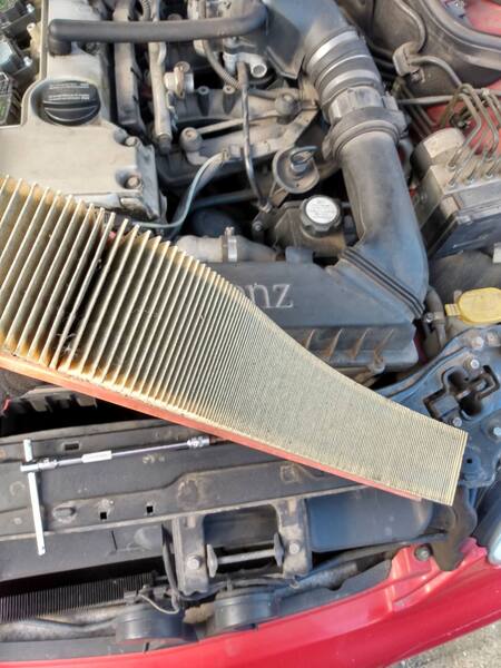

An air filter each for both cars, and new spark plugs x8 of two different flavours. Lets move the cars up onto the drive so i can legitimately say I'm on my own property doing this and get stuck in
Not exactly 5-spanner stuff here. 4x 8mm captive screws hold the lid of the air filter housing on, then pull the old filter out. I think this might have been last changed in 2013?
Its not gone far since then, but its still a bit manky. And in with a nice* new one. Hengst wasn't the cheapest one that GSF sold, but it was the second cheapest, cos thats how I roll.

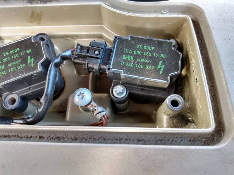

Lid on, bolts done up and TICK. next, the plugs. The engine is covered with a big protector as they all are these days, so that was removed. The front 2 bolts are easy, but the back ones are horrible things and you seem to be unwinding them for eternity before they finally let you extract the cover. Underneath there is no rail, just the push-fit pencil coils. I pulled one out, put the spark plug socket and 3/8 extension down the hole and oh... ummm we'll need another extension then won't we?
I rummaged in the garage for another extension and found a weenie one which gave just enough room to get the ratchet on the end and undo the plug. It came out fairly easily and while old and clearly heat-worn it was the right colour, a sort of rusty brown indicating (I think?) clean combustion

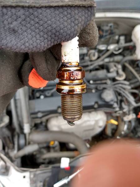

New one in. Bosch R6's which again were the 2nd cheapest ones GSF sold that would fit the Daewoo.
Gapped correctly out of the box as well. I repeated this with the other plugs, 2 and 3 were a bit oily and manky
So I'm not sure whats going on there? Maybe oil slopped down the bore at some stage? or maybe a leaking rocker gasket? I don't know.
I used the genius idea of putting the new plugs on a bit of old hose to lower them in and get them to bite the thread. The advantage of this is that you're not dropping them electrode-first down the hole, and if you start to cross thread the plug, it'll just spin on the hose rather than chewing up a new thread in the cylinder head.
All in all a successful mission. The car started and ran fine afterwards so I'm calling that a success. I kept the two least manky old plugs just in case and they'll go in the boot as emergency spares. After the Saab debacle this seems like a good idea. I reckon this work should give me about another 30bhp - ten for the air filter and 5 each for the plugs? Taking it up to about 35hp TOTAL.

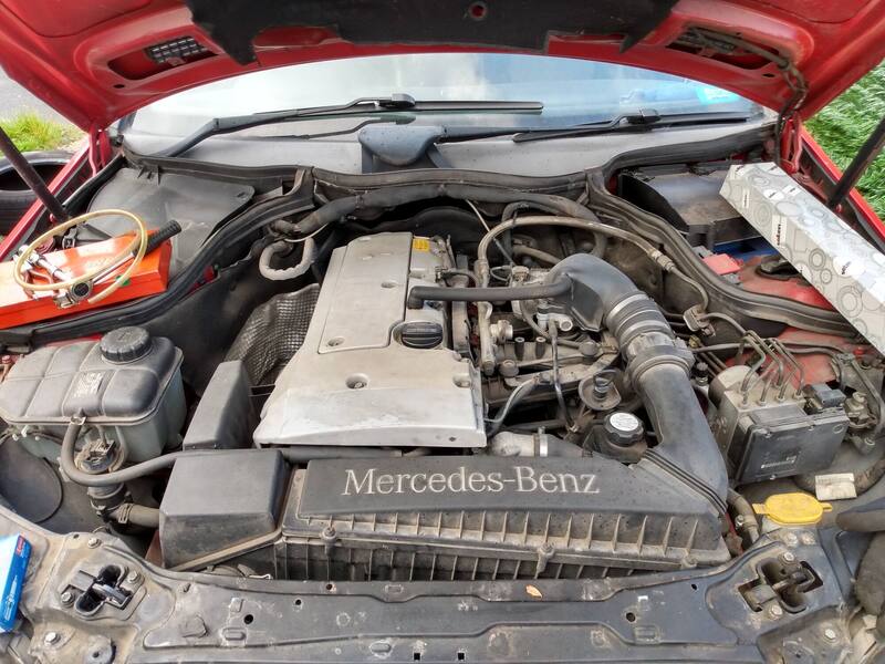

Bit more fixing today, for some reason air filters for this thing are weirdly expensive. I finally got round to buying one at GSF the other day and it turned up earlier. I swapped the dusty current one over and then had a serious look at the spark plugs. Apparently M111 engines are hardy things but like to eat plugs, so I bought some Denso K20TT plugs at GSF at the same time as the air filter.
I took off the plate that sits between the cam bulges in the cylinderhead and was presented with a disappointing sight
Hmmm, male torx? I don't have the right bits for removing those. Lets try with an 8mm hex socket instead shall we? I managed to remove one coil pack without totally b0rking the bolts, then had a go at taking the plug out. This had been previously done up by Thor and was SERIOUSLY tight, so much so I repeatedly checked and double checked I wasn't turning the ratchet the wrong way. Eventually it released its grip on the cylinderhead threads and came out. Looking at it, its in surprisingly good condition, and is also a fancy-pants NKG Iridium jobbie which are like £20 a go, so I chickened out and gently put it back after putting a tiny bit of penetrating oil on the thread and lowering it back in on the end of a bit of syphon hose. Do we think old (20k miles?) iridium plugs are better than brand new Denso non-iridium plugs? The Denso one can go in the glovebox for now
and I'll have a think. The colour is right on the plug tips and they don't seem excessively burnt on the insulation ceramic stuff so probably alright?

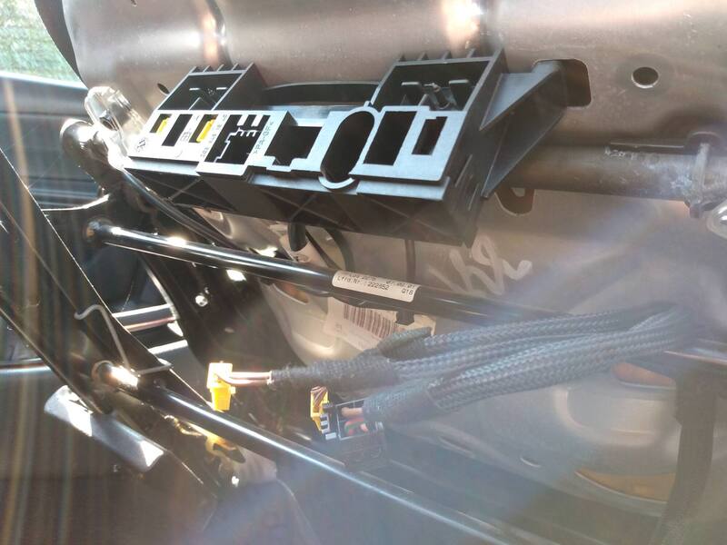

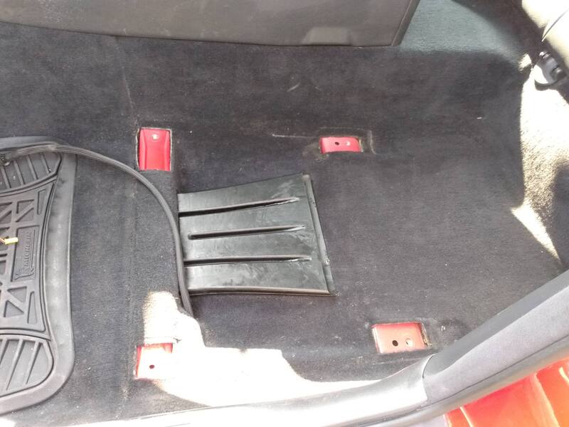

The front seats are held down with 4x E10 torx head bolts, you need to put the seats all the way back, then get to the front two, then all the way forward to get at the back two. they were quite tight but eventually gave up their grip and came out. Then you need to rock the seat back to get at the electric gubbinz underneath
This is the belt pretensioner and the electric adjustment stuff. It was reluctant to come out but eventually gave up the fight without snapping.
With it all undone, you can then slide the cables out from the bars under the cushion, undo the belt bottom bolt and lift the (astonishingly heavy) seats out and behold the grot

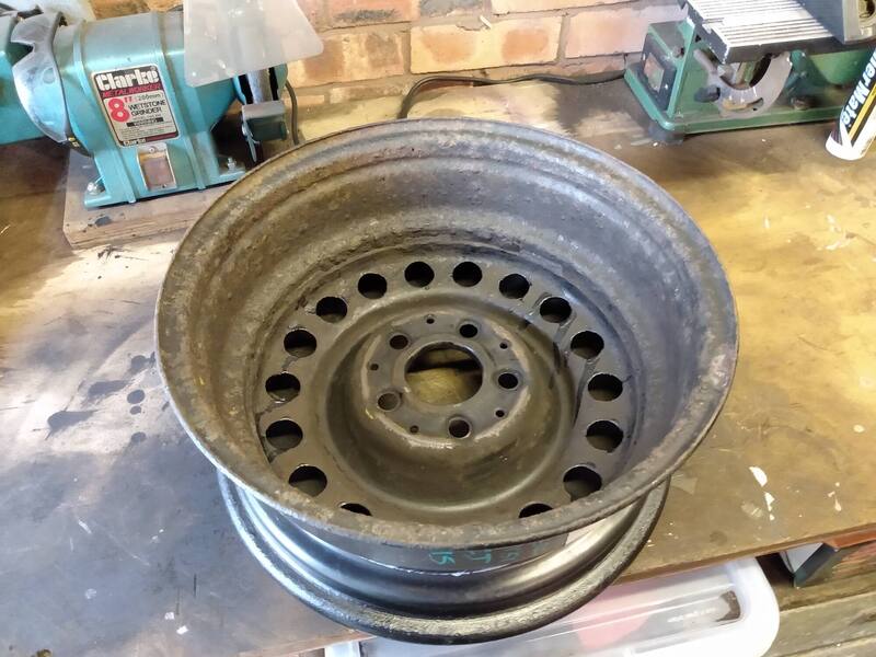

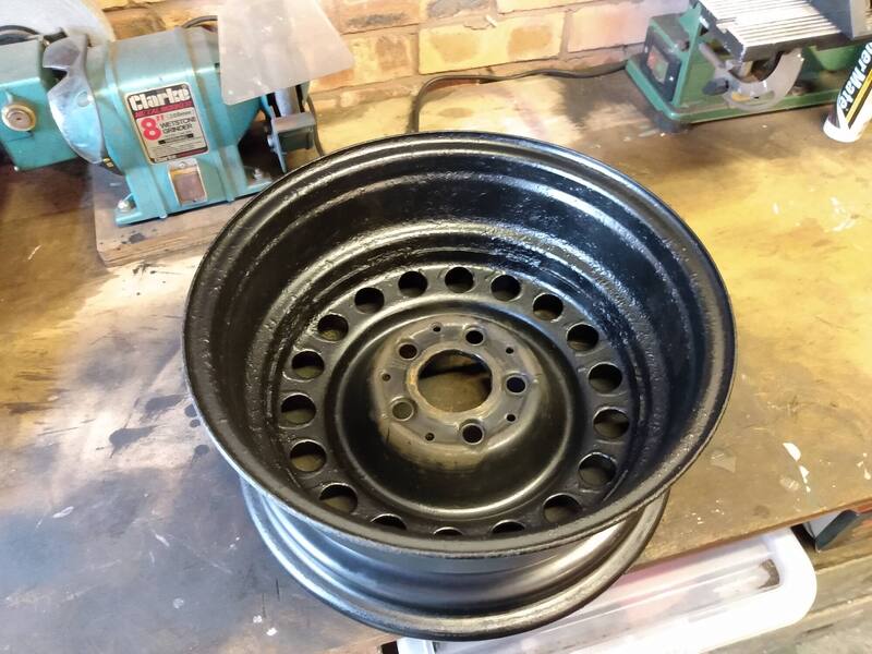

And now an update from the other heap. I'm not a huge fan of alloy wheels, especially 20 year old ones which are a bugger to keep clean and in good condition. Add in a couple of previous owners who weren't hugely keen on keeping all the original bits of the car intact (see centre caps of alloys, luggage blind, mirror flaps on sun visors etc etc) and it ends up letting the side down a bit. They're also a sod to refurb without paying someone £40 a wheel to sandblast and then powder coat them, and then another firm £20 a wheel to remove the tyres, then refit them once done at the powder coaters and be wheel-less for a week and its all a bit of a chore. I like steel wheels with hubcaps which are honest things and a lot easier to look after in my experience. The mercedes has alloy wheels....
To begin. This is one of the best wheels
They're not in bad condition, hold air fine and have locking nuts, they are shod with some 6 month old tyres but the brake dust gathers in the recesses and is a general chore to keep on top of. I wanted steelies, which mercedes sold as part of a 'winter kit' for the w203 I'm given to understand. Tracking 4 down, 20 years later was a bit of a challenge, but eventually I found a breakers in Crawley who had a matching set of 4x 6j x 15" ET31 steel wheels, which is what I wanted. I drove up in the pouring rain a few weeks ago to collect them and brought them back to Stanky HQ. They were a bit old and corroded but weren't past it by any stretch of the imagination. I paid £15 each for them which is a bit more than I wanted to pay, but they weren't interested in a deal for all 4, and the alternative was to buy 4 different ones from hither and yon and pay a fortune in postage. These were reasonably local and only needed one trip out to collect.
The wheels had quite a bit of surface rust
A mixture of crusty steel and built up brake dust. The outside face was better, but not a lot better. I set to with a wire wheel in my angry grinder to take off the worst of the flaky bits and lumps from all 4 wheels which generated quite a substantial bit of dust. A person with a double-digit IQ would have worn a mask, I held my breath as much as I could and ended up with brown bogeys for about 3 days...
The end result looked better. I also gave the lips a really good seeing to with a metal file to remove all the surface rust and old rubber to make sure when they got to receive new tyres the beads sealed properly, as otherwise the tyre place would need to file the nice new paint off to smooth off the lip which wouldn't be good
They got 2 coats of vactan at this point covering both the inner and outer faces of the wheels and hopefully addressing the remaining surface rust. Next up was a seeing to with black enamel paint. Once the vactan had thoroughly dried, I broke out these.
I got 3x 400ml cans of this from ebay for £12 posted, which I hoped would be plenty. I painted the wheels one face at a time, with about an hour between coats until all 4 wheels had received 4 coats inside and out, before being left to dry out thoroughly for 24 hours.
Looking loads better, I hope you agree? Again, my 'hold your breath and spray 'til you go blue' method of PPE failed hard and I had black bogeys for 3 days. At this point I trial fitted one of the wheels to the car to make sure it didn't foul anything, the bolt holes lined up etc etc. Mercifully they were fine. One thing that was very obvious though was that the bolts that go with the alloy wheels are WAY too long for the steels. The alloy wheel bolts are 40mm thread, whereas the steels need stubby 20mm bolts to hold them onto the hubs. I had one set of 5 of these with my spare wheel in the boot so fitted it up ok

The colour match vs the original (centre section) paint is mercifully very good. As you can see from the rightmost hubcap its blended in really well.
Next up, demo fitting a hubcap to a wheel
I'm pretty pleased with that, from 18" away they look really good (IMHO). So only one task remains. Car with alloys fitted at 18:30 tonight
30 minutes later, with SGS jack deployed to lift each corner in turn and swap the alloys over to the steelies using stubby bolts and fitting hubcaps on turns it into full on taxi-spec c-class
I think its a much cleaner look, will be easier to keep clean as the hubcaps are very flat with no intricate bits for brake dust to get stuck in, and if it gets to it, they can be removed, sanded and re-painted quickly and easily if the brake dust and road muck gets really embedded.
I need to take the car out for a few runs to wear the tyres in, and also then re-check the wheelnuts but I'm really pleased with how it looks now. All that remains is to do something about the lacquer peel! My lungs are probably fucked from the amount of rust, enamel paint, silver paint and lacquer I breathed in - I really need to get a decent mask for this sort of thing. But the end result is most pleasing.
