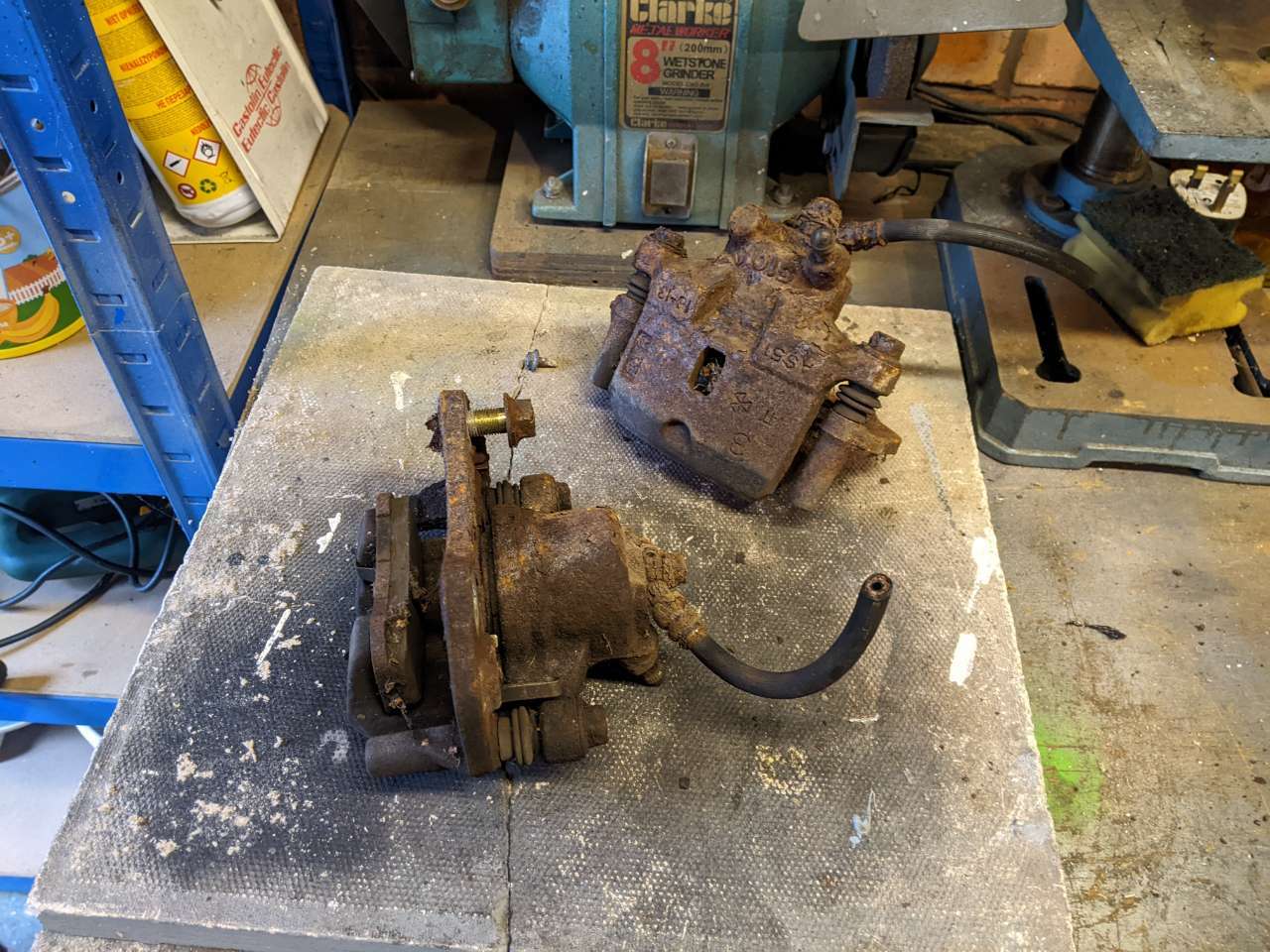

The guy had sent me some pics, and advised the carriers were a bit corroded, he wasn't kidding. I opened up the unexpectedly heavy parcel to be greeted with these lumps of rust
Erk. Thats pretty grotty. However, in addition to being grotty, it was two sets of pads, complete calipers and carriers, not JUST the carriers I was expecting, so there is some bonus content here which is good. However, these are is a bad way. I tried to see if they were totally seized. One actually moved really well, vomiting out some ancient brake fluid from the cut-off flexi when I pressed the piston back in. The other was a bit more stubborn, but I don't think its toast. Anyway, thats not the important bit! I clamped the calipers in my bench vice and hammered on a 14mm socket to the slider bolts, which had pretty badly corroded heads and heaved on a ratchet and amazingly all 4 came out without a fuss. The sliders hadn't seen much lubrication so were a bit difficult to extract, but even dry, came out easier than a well-greased slider from my carrier. With the carriers off, I could have a closer look
Thats pretty grim. Less grim than the calipers themselves, but pretty grim nonetheless. I put them into my bench vice and gave them a good scrub with a wire brush
which took some rust off, but wasn't touching some of the really encrusted stuff. I put them both on the bench to see how we were doing

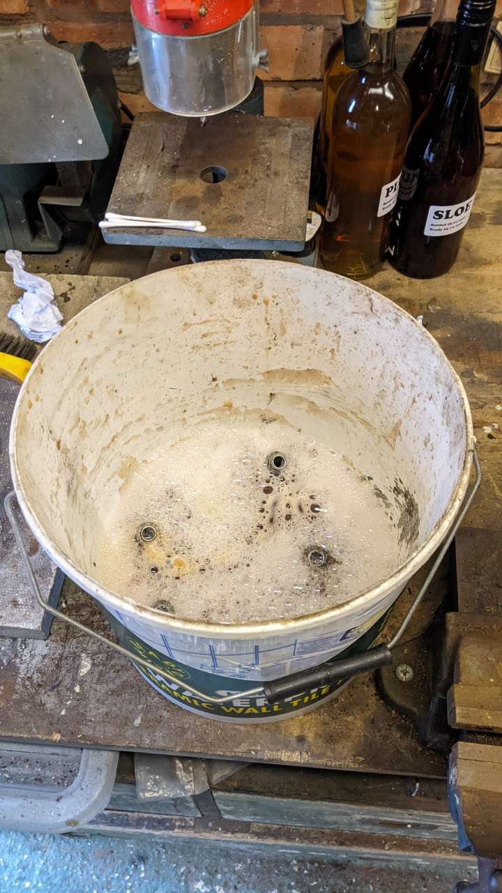

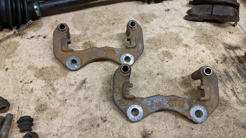

in anticipation of needing to do some derusting I had bought myself some citric acid crystals, so it was time for some CHEMISTRY. I put 100g of citric acid crystals and 2 litres of boiling water in a bucket and them dropped the two carriers, the carrier > hub bolts and the slider bolts in for a bath
It started fizzing quite alarmingly, I gave it all a stir up and left it for 30 mins or so, then lifted the carriers out - without gloves because I'm an idiot, and now know EXACTLY where all the cuts on my hands are now - and scrubbed them with an old toothbrush to agitate the surface rust. This was after about an hour and two soaks/scrubs
I repeated this at ~30 minute intervals for about 4 hours when the bubbling was much slower, as the acid solution would have been loads cooler, and had mostly reacted by this point so out it all came

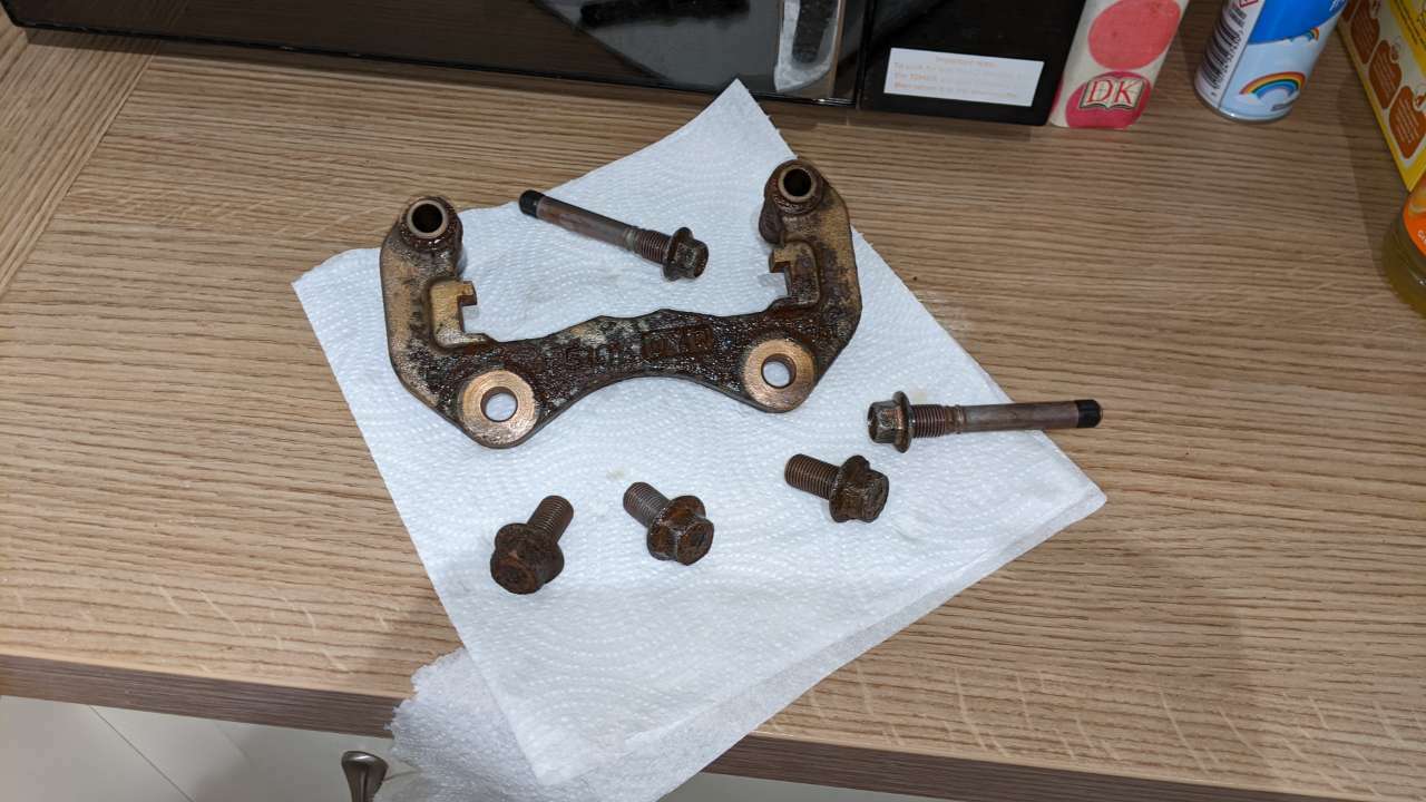

As you can see, there now a lot of clean metal, but plenty of rusty crud stuck on. The parts were still covered with acidy solution, so next up was another bath, this time in hot water and soda crystals to neutralise the acid
I rapidly vacated the kitchen before my long-suffering wife saw what I was doing! After about 20 minutes I removed the calipers and bolts from the alkaline solution and washed them in clean hot water. this was the result
now THAT is a lot better. Next up was to clean up the bores that the slider bolts fit into. I used my dremel with a mini felt polishing cylinder and some autosol polish to clean them up to a nice shiny surface finish, then  used a cotton earbud to clean the polish reside out with meths. After this, I left the carrier on the radiator in the house overnight to dry out thoroughly. The next morning I set to with the dremel and a drill, using brass wire wheels to take as much of the encrusted rusty off as I could
I'm not displeased with that! About 90% of the rust is gone, especially from the flanged buts round the bores that the sliders go into (which helps locate the tiny rubber boots) and the square cutouts that the pads fit into. The threaded holes had the threads cleaned up and lightly lubricated with some GT85 spray.
I removed the front drivers side wheel, and removed the caliper and carrier (struggling with the top slider as usual) and then fitted up the regreased sliders to the carrier on the bench before fitting it carefully to the hub o the car. The slider bolts were reused, because they're only about 6 months old and have been barely used. They got re-greased and I'll check it all carefully after a few miles. It all gone done up and the wheel refitted, but I couldn't take it out to play because it was boxed into the garage by one of the other cars so hopefully I'll take it for a run tomorrow.
I think the remaining rusty mess might be beyond saving but I have a sneaky plan involving a pair of brand new calipers and returning two lumps of solid ferrous oxide for a rebate, but that will have to wait for a little while!

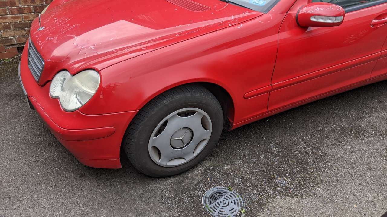

The front arches on the mercedes are beginning to look scruffy again, about 4 years after I last had a go at taking the paint off, vactan'ing them, zinc primering, painting and lacquering. I did do this in November last time, so the environment wasn't exactly ideal. Anyway, it looked ok from 10 feet
(obvs ignore the bird poo and rampaging lacquer peel...) but MAGNIFY and you'll see its not looking great
Lots of tiny bubbles coming through and staining with rust. Excellent.
I used a wire wheel in the angry grinder to take the paint off again all round this arch, then repeated the process with Vactan, Zinc primer, base coat and lacquer to try and improve matters. The weather was warmer this time, and I was able to do the painting in the garage so it didn't get rained on. The job has taken all weekend, but only in short 5 minute bursts, then leaving it alone for a couple of hours in between. Anyway, its looking a lot better now
and zoomed in
Up super-close, there is some bumpiness which the paint hasn't flattened out as much as I'd have liked,  but its a lot better than before and should keep the wings intact for another 4 or so years I hope. As before, flat colour is quite forgiving for rattle can paintwork fixing, its blended in pretty well and should be OK once its had a week to fully dry out and I can wax it. In certain lights you can see its been redone by a cack-handed amateur, but most of the time it looks fine (or at least you dont notice because you're so gobsmacked by the state of the lacquer sloughing off the bonnet, roof and wing mirrors)

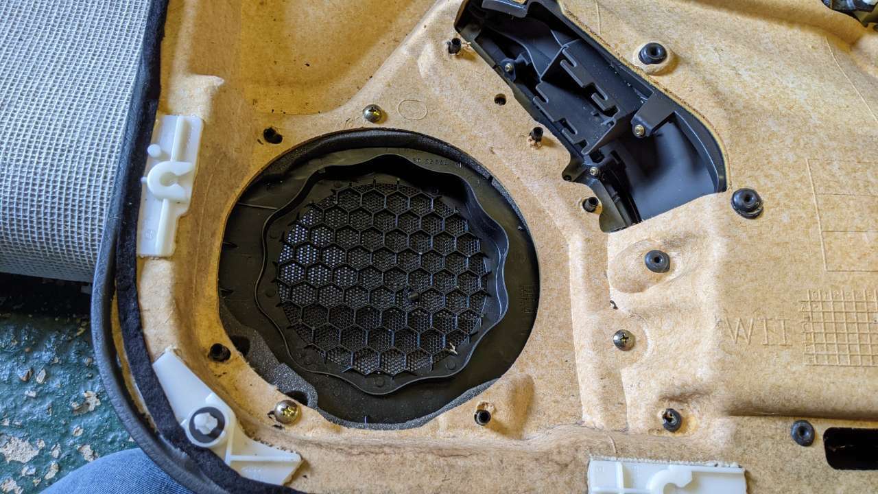

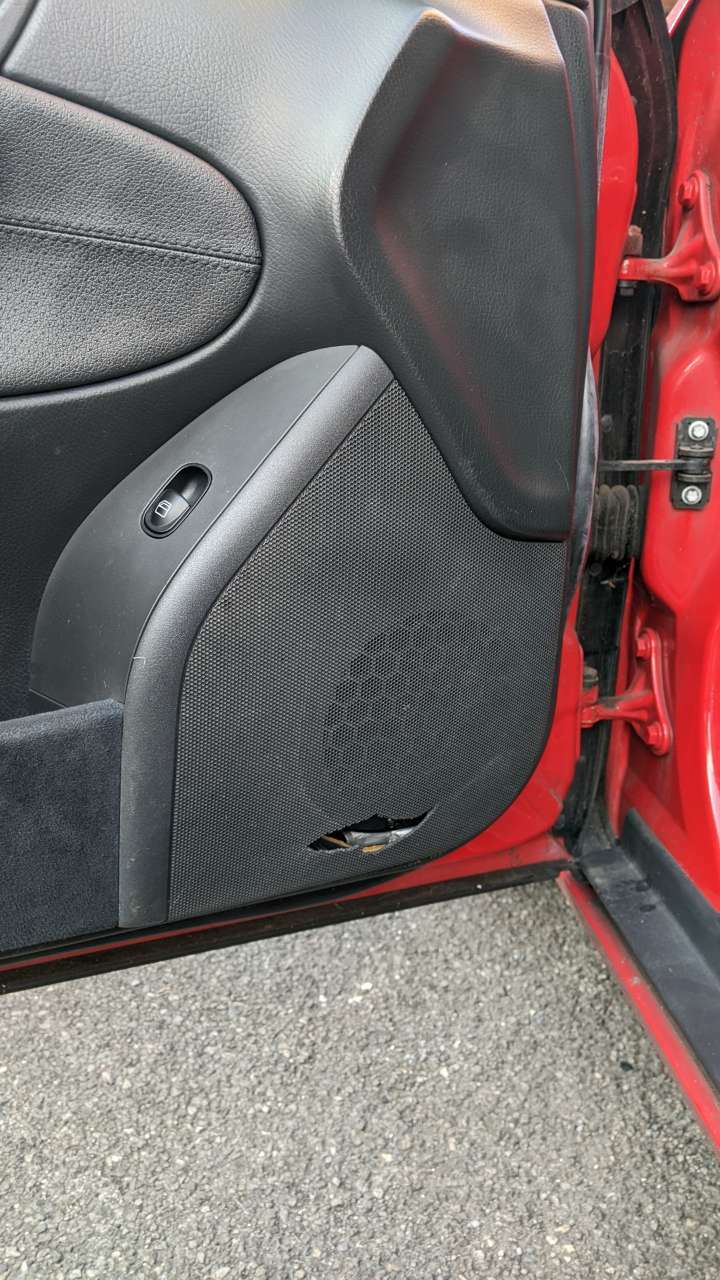

Speaker grille arrove tonight so since it was sunny I set to replacing it. On the W203 the grille is sort of heat-moulded to the doorcard so its a bit of a kerfuffle to replace. This is what we have to begin with, I pushed the doorcard on with my hand on the grille about 3 years ago and cracked it, most of the crackes were carefully pushed back flat, but there was a bit that snapped right off and wasn;t going back together, so its looked like this ever since
Hardly befitting of such an executive* motor, I think you'll agree?
First things first it was time to remove the doorcard. Its held on with a few torx screws and some plastic poppers which came off without a fuss, exposing the inner door
Note terrifying airbag/facebomb... I unhooked the door release cable and electric window switch. With the doorcard off I could see what was what
You can sort of see the melted-on 'legs' of the speaker grille section here. They poke through the doorcard then were sort of melted and squashed into mushroom shapes to keep it in situ. I have zero clue why they didn't just use half a dozen dome-head screws. But there.
I took the doorcard into the garage and laid it on some old carpet. I used a drill to drill off the mushroomed heads and a stanley knife to trim the leftovers off then pushed the speaker bit through
so far so good. Next I trial-fitted the new grille by poking the 'legs' through the doorcard holes to make sure it all lined up, which happily it did. The new grille was £25, less than half the price of every other seller on ebay so I was quite keen not to damage it. For those with good memories, the car cost me £19 in roffle tickets, so this represents a significant investment!

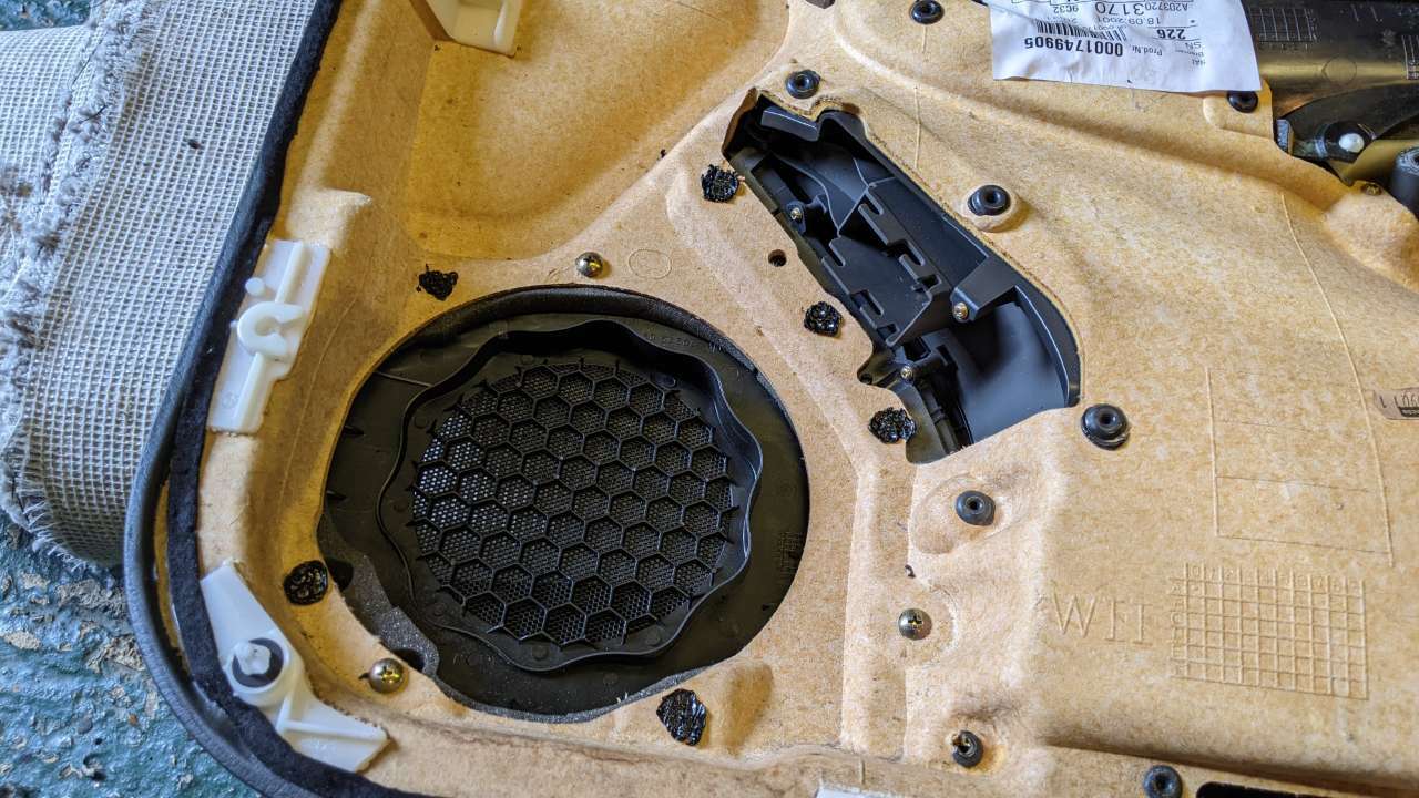

Since I know better* than the DaimlerChrysler corporation I had decided that I'd use some dome-headed screws to hold the grille on, at least partially. I used my knock-off dremel to cut down three of the 'legs' so they were more of less flat with the inner door card stuff
and then screwed the stubby dome-head screws into the hollow legs of the grille
You can see /\ /\ /\ here that the legs stick through quite far normally, hence needing to cut them down a bit.
I did this with three of the legs around the perimeter to hold it in place before phase 2. I only had 3 suitable screws or I'd have done it with all 9 legs TBH. It worked well.

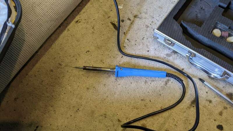

Next it was onto stage 2 - melty melty
I used my crappy silverline soldering iron to melt down the legs one at a time, then used a dome-ended bit of metal to squash the melted plastic flat, like the original mouldings, only worse
This was #1 which was definitely could be better material, but it worked. I slowly made my way around the remaining 7 legs, melting them then mushrooming out the ends. Having the grille held in place with the screws was a godsend at this point
My handiwork improved as I went, some of the later ones were almost tidy
with them all melted and mushroomed I flipped the door card over and was pretty pleased with my handiwork
Thats not a bad job is it? The fit isn't perfect but isn't bad, and looks miles better than the cracked original. I fitted the poppers back onto the inside of the door card and held them in place by wrapping a small amount of butyl tape round them to stop them falling out as I fitted the door card up to the door. I refitted the bowden cable to the interior handle, refitted the electric window switch, hooked the tweeter out of the door and hung the door card from the top rail of the door frame, then pushed the popper on one at a time. The attached the tiny grille that the tweeter lives behind on the other side of the glass to the wing mirror and...
Thats a bit better isn't it?
