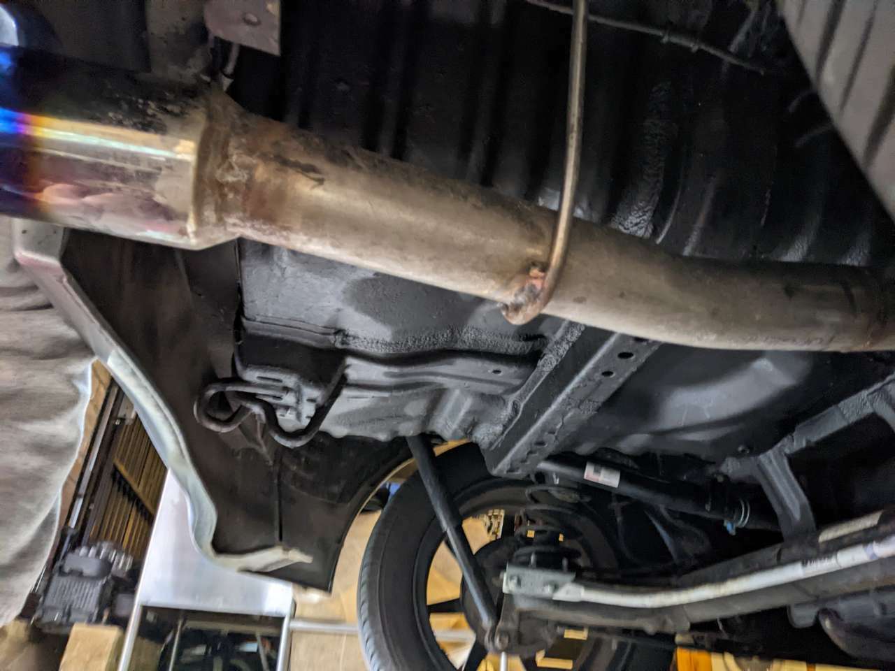

the issue with the exhaust was that two of the hangers had rusted off, meaning it was supported at the front by the manifold, and right at the back by the last surviving hanger on the rear silencer, but that the mid section was unsupported. Because its quite heavy, and the roads so potholed, the exhaust was able to move parallel to the road surface enough that it developed a stress crack on a bend. This meant exhaust gas was able to leak out and constituted a fail. TBF it was a fair cop.
To fix it, we made a new hanger up from from 8mm steel rebar and my brother welded it on to support the exhaust better, and then closed up the crack and welded it up again so it was gastight. So we're legal again, and it should be OK for a while yet.
The difficulty I have is that the car is a bit of an oddity. Its an early S203 so has the carried over 2.0 NASP M111 engine from the W202/201/200 and is an estate. Surprisingly few of these were made in this spec so getting an aftermarket exhaust for it is very difficult. SES and the usual suspects don't have stock, and the manufacturers they get them from have them marked as NLA. The bigger engined ones are more freely available, as are saloon model exhausts (e.g. yours, with the M271 engine), but not estates with weedy engines.
I can get the part from Merc direct for ~£470, which isn't awful, and will be OEM quality, not the tinfoil joke that a Klarius one would be. Or get something fabricated but probably not substantially cheaper. Where it has failed is on a bend so sleeving it isn't easy, and I'd really rather not drop the exhaust unless I'm replacing it.
For now, its OK but I suspect now its weakened, even with the new support bracket it may well fracture again. However, this is basically the only real issue with the car (paintwork aside!), and its not really cost me much in unexpected/non-routine maintenance so I should probably stop being a mingebag and just buy a new exhaust section for it and fit it myself. Its a big lump, being basically everything from the B-pillar backwards on the car. The one fitted is stamped with merc logos so is likely original and therefore 22 years old so its done pretty well! Plus I can't actually get anything thats even nearly as capable and reliable for less than £3k right now which somewhat justifies spending some money on this car. As I said to you before though, the fact it cost me £19 to buy the car means I'd be spending approx 2500% the purchase price on one part! Had I bought it for the market rate of about £2500 today for a similar car then £470 would be a bit less crazy though.

The car went back to the exhaust specialist and they fitted a resonator in the middle of the system, its only small and while it has quietened it down a bit, its still quite noisy.
For now, I’ve gone back to the original intake to see if I can quieten down the intake noise a bit because its just a bit too obnoxiously loud. I’ve got a new 'modified car' policy with a specialist insurer now so I aim to get out on the roads more to get things bedded in, I have another 4 months until the MOT is due, and might go and tap up my local MOT station for a ‘will this pass?’ question or two. They’re fair, and I have good rapport with them so they’ll tell me if they’re not happy.

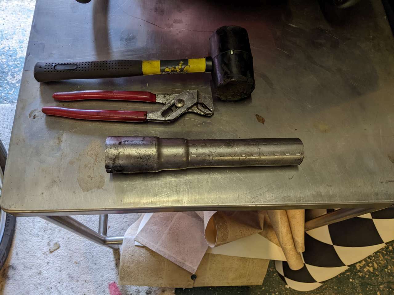

I have enacted plan B - its possible to buy inserts for the tailpipe that quieten down the noise, they’re aimed at track cars which exceed the noise limits on some circuits and seem to get OK reviews. I bit BIN on one from Demon Tweeks for about £12. The insert arrived today and I had a bit of time so went out to see whats was what. Its quite a simple thing, being basically a stepped bit of mild steel pipe
The idea is you fit this thin-end first into the exhaust and it narrows the pipe diameter as well as absorbing some of the sound at the same time. It was cheap and seemed to have OK reviews. I went to fit it and was slightly vexed because while the exhaust tip is square with the back of the car, the stainless pipe that the tip is welded to goes off at a slight angle
which meant the insert wouldn’t go in straight and jammed when it was about 80% in. I could have hammered it in, but I wasn’t sure what effect it would have and if I’d hammered it in then there would be absolutely zero chance of it coming out again without major surgery, so this called for some lateral thinking.
I had downloaded a decibel level app on my phone and when I started the car up and let it idle. From cold, idling at about 1500rpm it was recording 87dB on the app. Once the car had warmed up and the idle dropped to normal closed loop it was recording 76dB which was definitely better, but too noisy under load still.
My lateral thinking was to put the pipe in the wrong way, sure it’d look stupid with a bit of tatty mild steel pipe poking out the back, but the sound difference would be able to be checked to see if it was effective or not. Poking it in the tailpipe did indeed look silly
However when starting the car, the cold idle noise was indeed reduced dramatically, registering 80dB on the app, with the engine warmed through at idling at ~800rpm the reading was now at 72dB so the reducer definitely did work.
However, I still wasn’t sold on hammering it in so have had a think and decided to spend some more money, on one of these:
They’re designed for motobikes but work fine in cars. It will fit inside the exhaust tip (3" outer diameter, 2.5" inner) and is held in with a grub screw. This will reduce the bore of the exhaust exit and based on what I have learned, should quieten the exhaust note considerably. I will need to drill a small hole for the grub screw in the underside of the exhaust tip, but this will be all but invisible.
I’m not entirely happy with it still, and I'm a bit annoyed with myself for not being clearer with the fabricator, perhaps telling them that it HAD to pass scrutineering or something... anyway, we're here now, so I need to work out how best to handle this going forward.
If this muffler baffle works then I will look at getting a different tip which should act as less of a megaphone. The noise on the motorway is too droning, I’ve put a bit of old carpet under the spare wheel cover in the boot to try and quieten things down too
