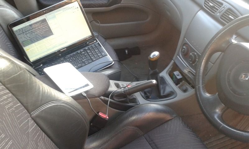

Anyway, I took the laptop out and did you some ADB logcats.
Fresh install of ohnorenault on a different android that's never had torque installed. BT pairs up, click connect in the app, select device then "Failed to connect to the OBD tool".
attachicon.gifdroidlog.txt
Took the tablet back into the house, installed Torque, ran another log. Torque connects and reads fine.
attachicon.gifdroidlog1.txt
PM me an email address and I'll send you the logs. Files added! I can't see any difference between them tbh. I did notice that the adapter doesn't identify its type and the tablet tries multiple protocols to get it to connect but in both logs it eventually does RFCOMM and talks to it. After that, I dunno. Plenty of "D/BluetoothDevicePreference(  942): Is my device connected::false" messages even after it's logging data to Torque. Wierd

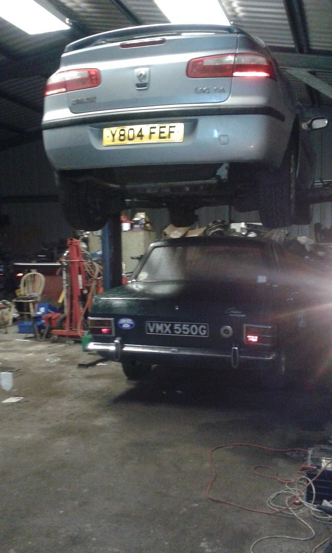

Quarter to five on a friday afternoon is obviously the best time to start dismantling your car.
Broken.
Stuck.
No chance.
Fuggit, Ahm gan yem.
Brave! You just know the evil Laguna is going to dump something bad, like brake fluid/loose bolts/entire subframes/etc onto your Cortina when you're not looking...
That reminds me, the rear exhaust rubbers are about shot too. If there is a silencer lying on the boot of the tina in the morning, I'll be annoyed.
It's never happened yet though, and I've been using the ramp to double up parking for a long time.

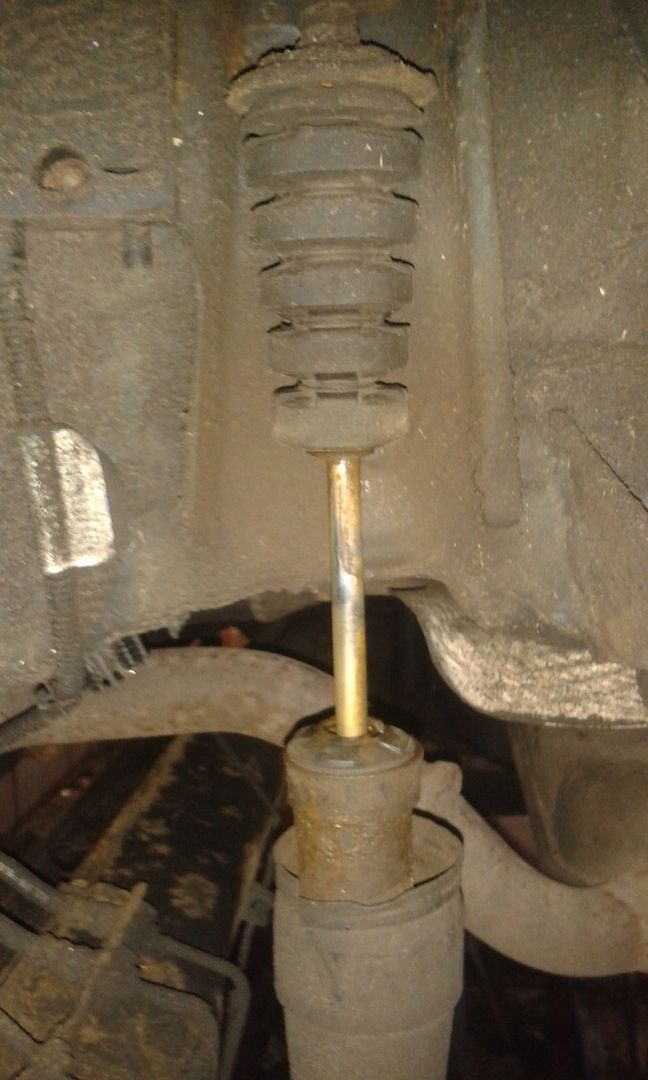

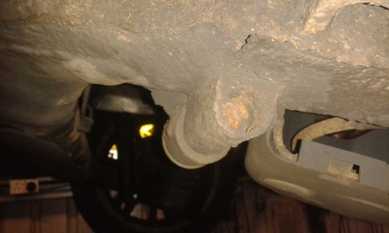

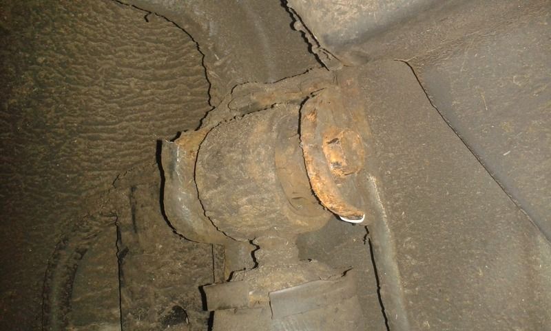

Those rear shocks can be a right bastard to remove iirc. Doesn't the inner sleeve of the bush go inside the trailing arm by about 10mm or so and seizes solid in there ?
I would give up on it and buy a £50 406 TD or something.
