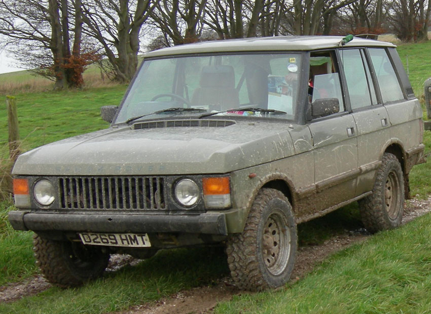

I also have a 1985 Range Rover and I ripped out the rear headlining when it sagged so badly that I could not see out of the back window.
Don’t be fooled by the D plate, it is 1985 and was exported new to Baghdad LHD, manual and came back two years latter RHD, Automatic with air-con.

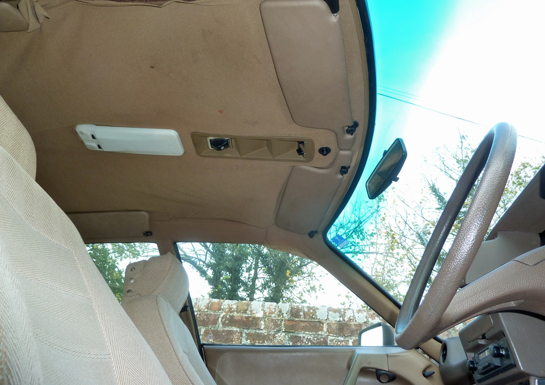

£700 is a serious lot of money to do a headlining innit, the materials can't come to more than about £50-75, but I suppose if the windscreen has to come out that adds a new and quite thick layer of bother. I got the headlining out the front door of my Volvo 760 after removing all four seats but I don't know of thats always possible.

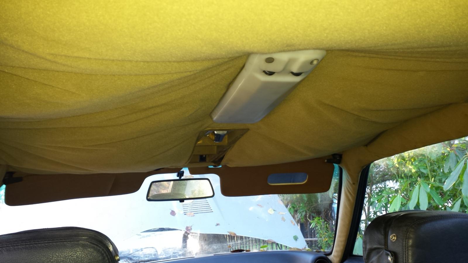

Mine is worse than my picture shows and has been pinned up by the last owner but not as bad as yours!
