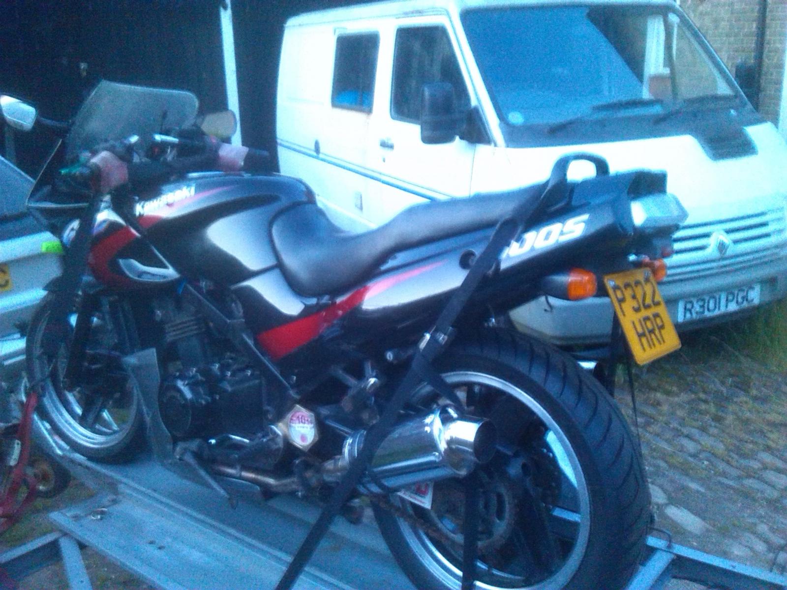

So along came this dog of a GPX600R for £300:
I got it to this point before I realised I didn't have the time to sort it properly and what I actually needed was something that ran:
It looks OK in the shots, but nearly everything I removed needed replaced, the exhaust stud holes all needed red-drilled, the tank was leaking badly and the loom was a mess. It looked like a quick project when I bought it, but would have taken me months to sort. With hindsight I would have tucked it away and kept it but I was offered what I paid so away it went in boxes.

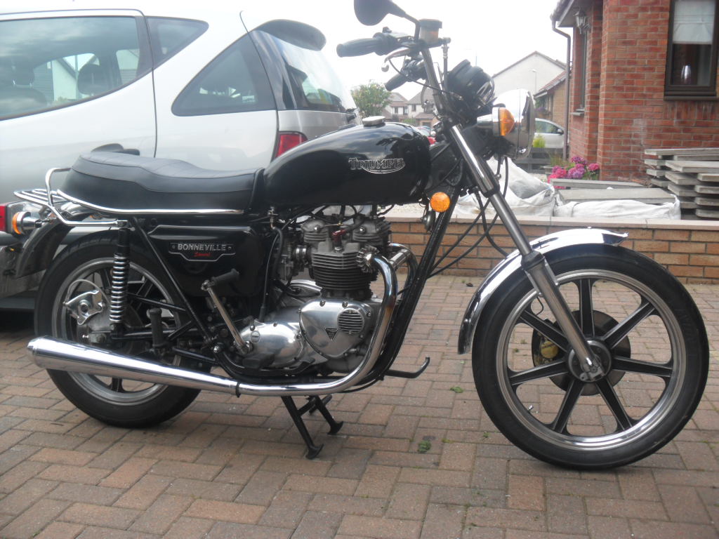

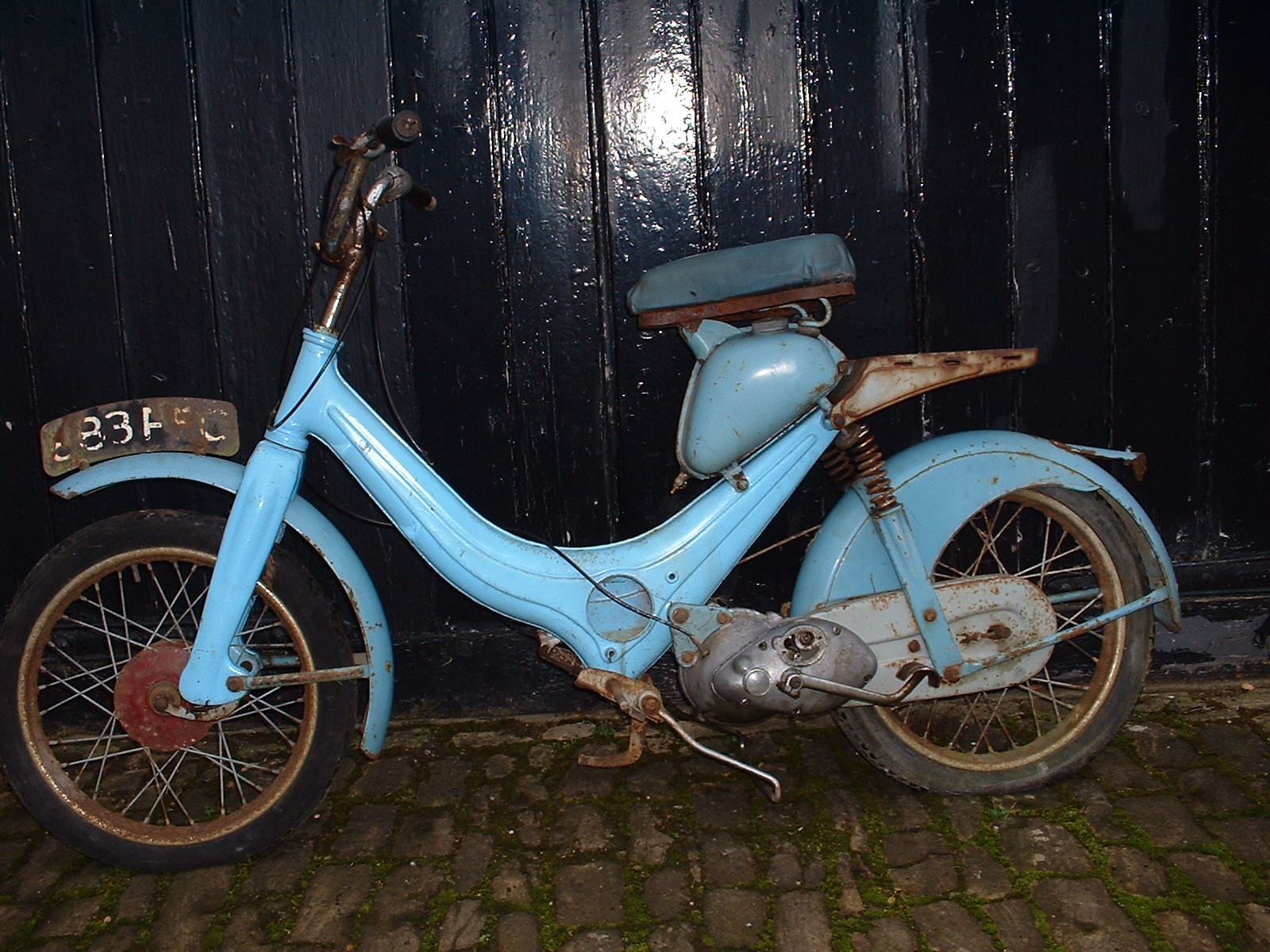

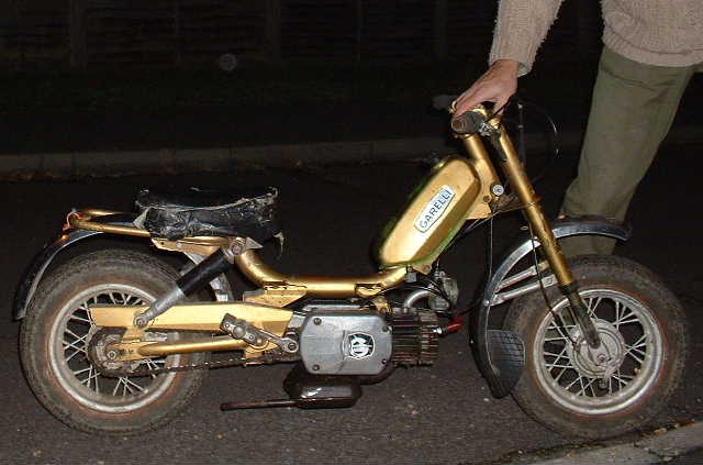

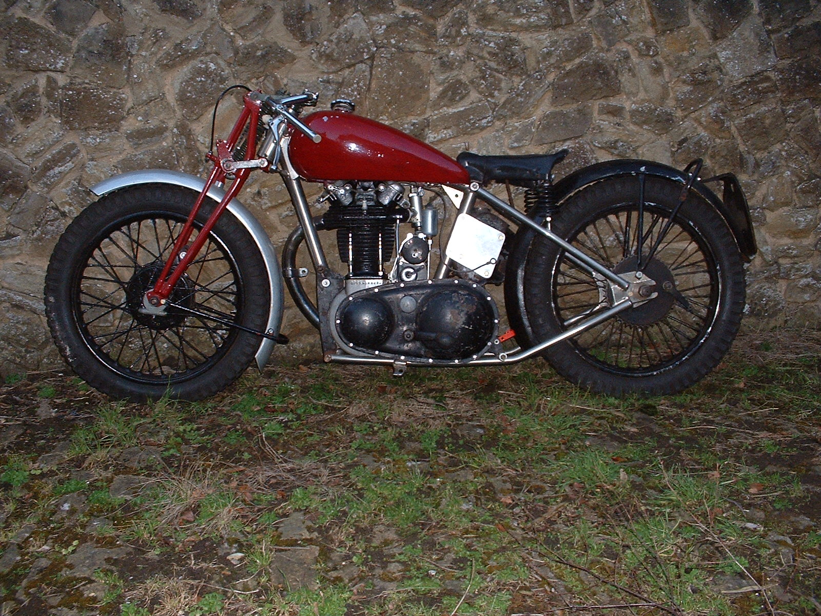

My unfinished  toy
My toy
A small toy
Italian toy
A different small toy
A BSA
ex film star toy
Indian made toy
Tiny Italian toy
Stomp
On holiday
3 of mine going Coast to Coast
Kwak
CZ
  • Like 6
