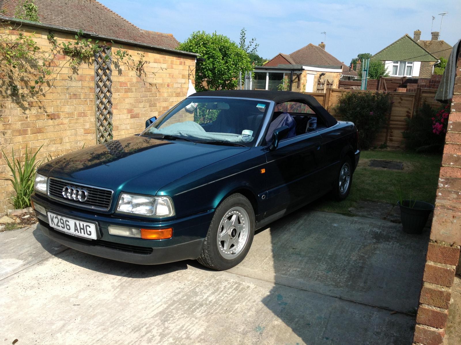

Audi Cabriolet, Summers coming.
The Mrs has just seen this and gone Ooooooo .
There's 1 around here in a real bright green colour that gets spotted every now and then,but always going the other way
It's for Einspritzung or injection.
That makes sense, although feel a bit cheated now liked the idea of a carlike this being an economy version.
That's what the other half says as well.
She keeps saying its her car for next summer, after I've done the work on it!

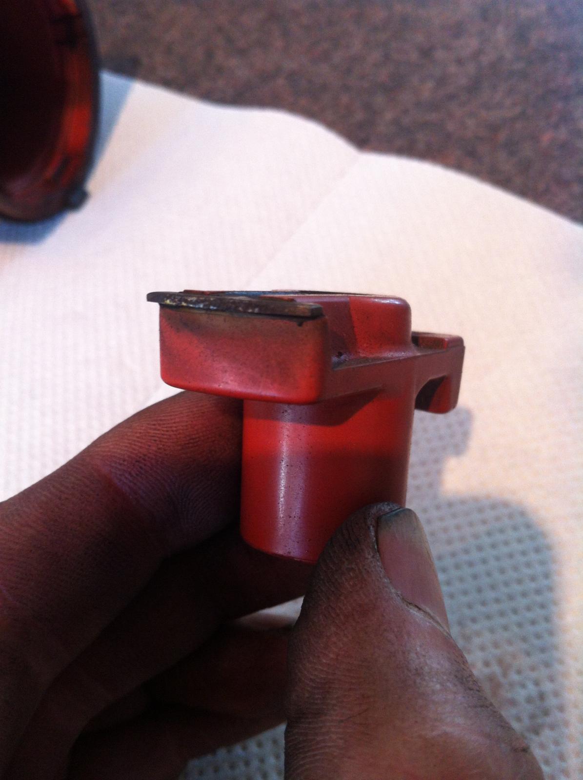

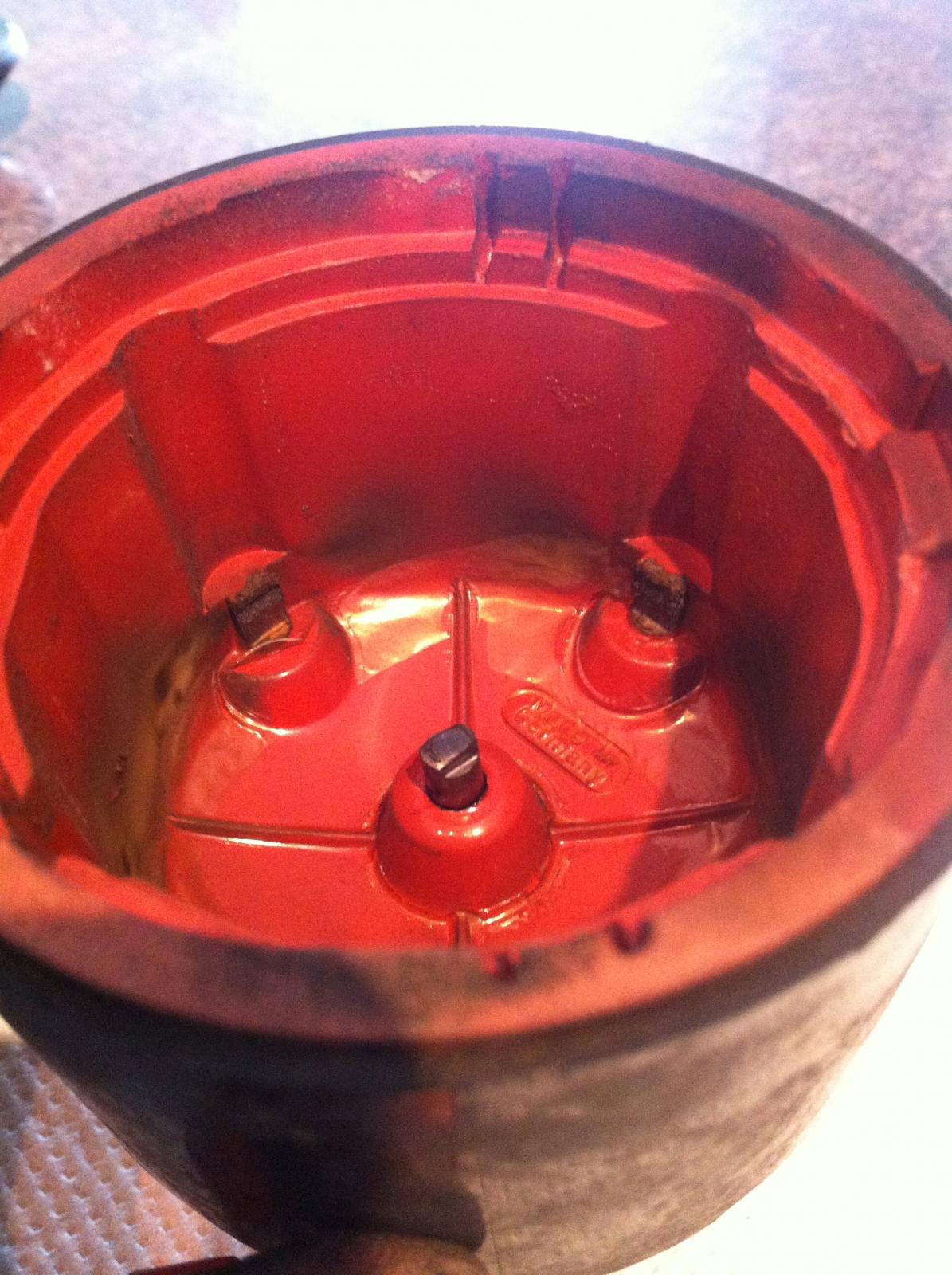

Next I changed the distributor cap, rotor arm and plugs the cap and rotor were in a shocking state pointing to lack of maintenance but with them replaced the lumpiness has gone from the engine.

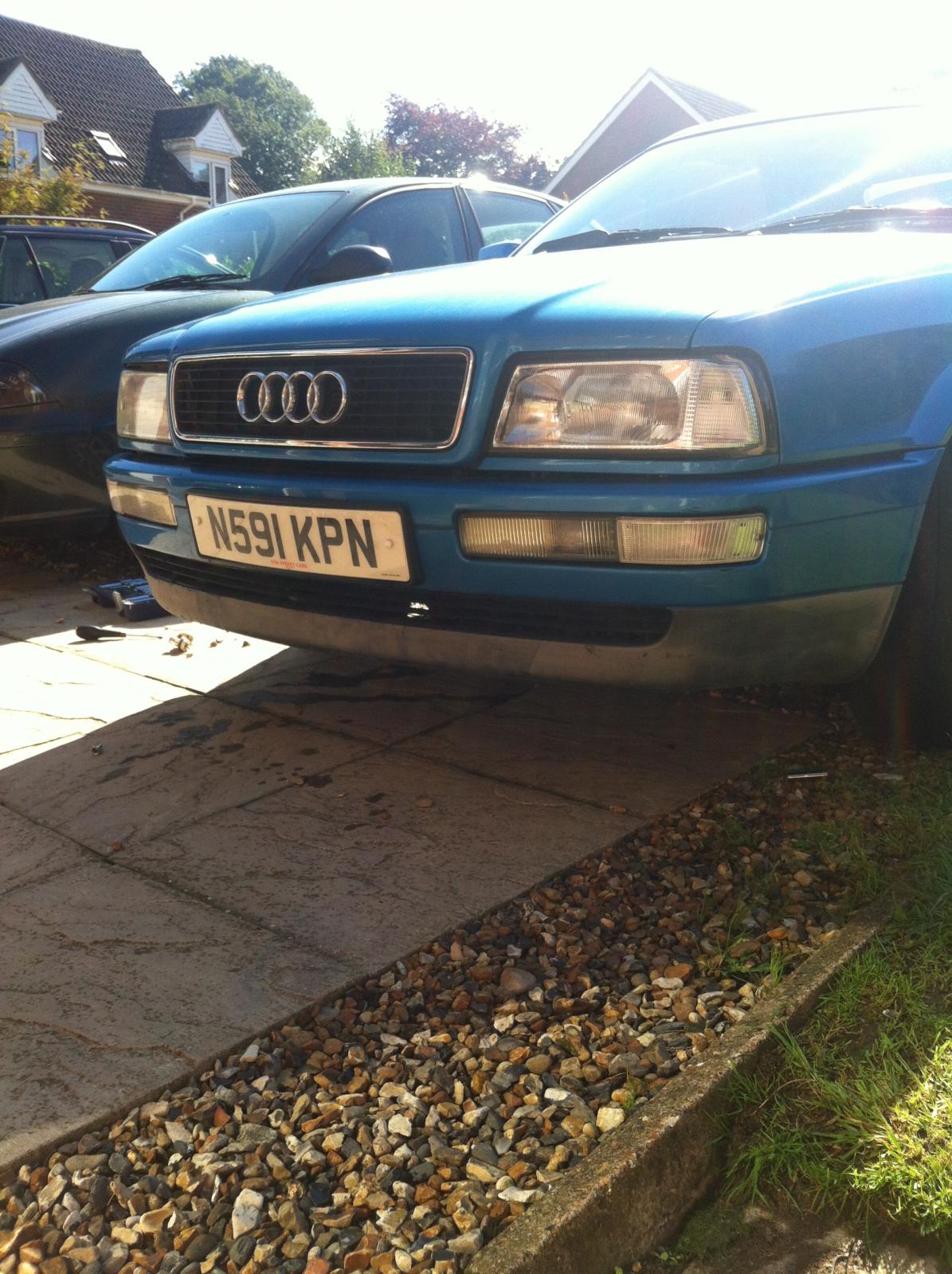

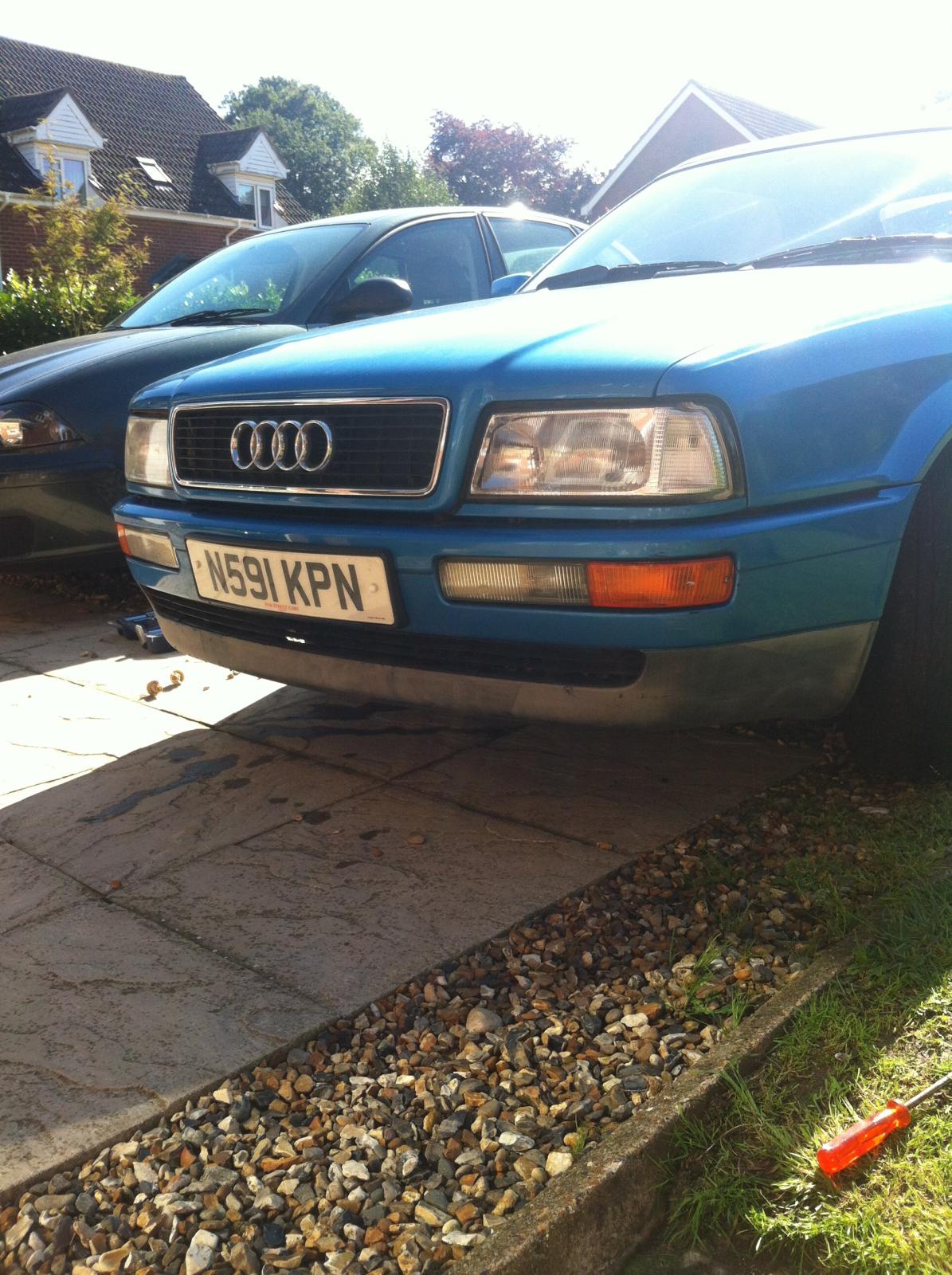

I also did some cosmetic bits and put on a pair of amber indicators I think these make a rather nice difference to the front end.

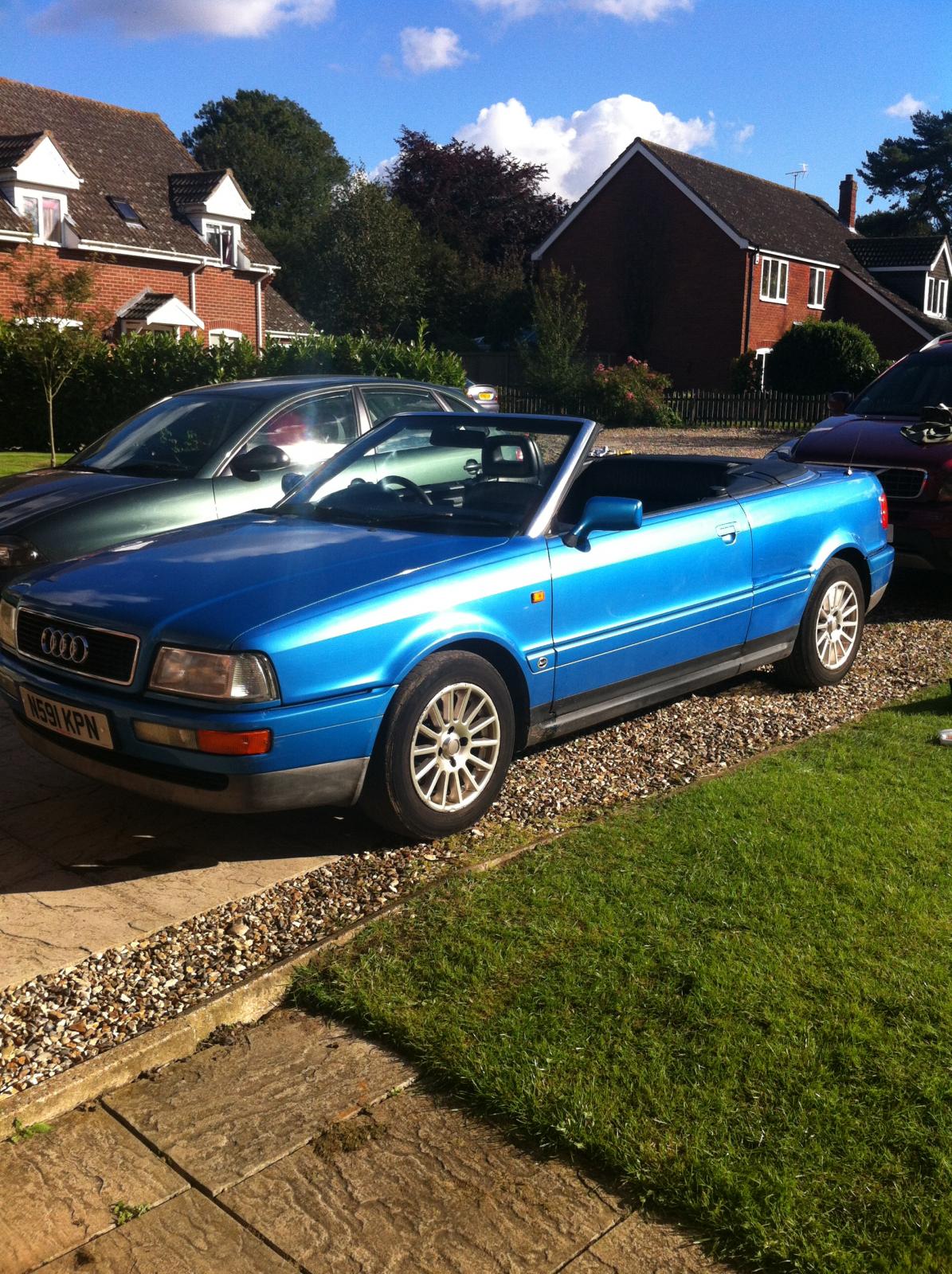

Before
After
Need a pair of pre 2001 number plates made up and now off to pick up some original Audi 10 spoke Alloys.

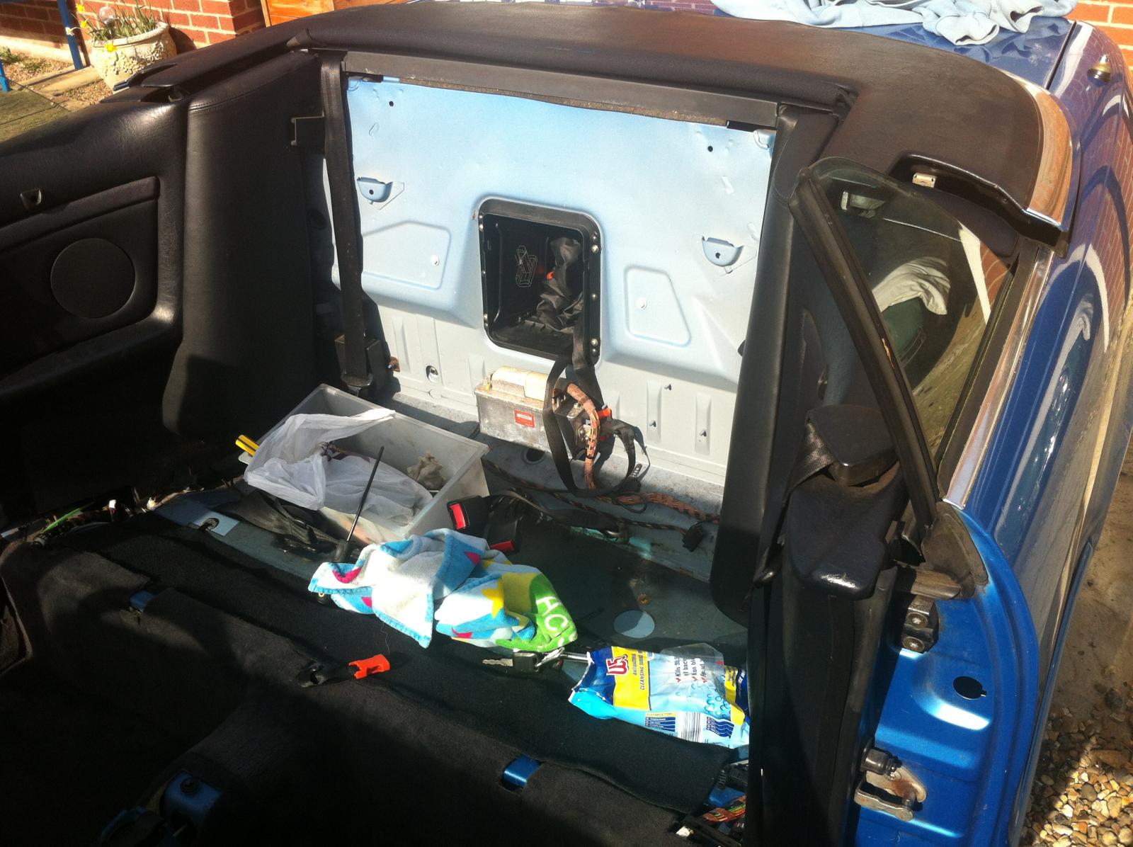

Today I got the biggest problem of the car looked at.
Having a roof on a convertible that doesn't work is kind of pointless so spent sometime investigating.
The roof compartment wouldn't open to stow away the collapsed roof' it needs a number of components to work together to make it open and somewhere there was a broken part.
I stripped half the interior to have a look and found the handbrake switch was broken, so I wired it up and hoped for the best. Still no joy so I took the roof compartment button apart to find a loose wire, held it against the broken terminal and heard a click, so fully enthused I enlisted a junior Crusty to hold the roof and pop up it came.
with the roof folded back I got some sun light in the car for the first time.
To say I was chuffed is an understatement!
Its only a temporary fix as need parts but its fixed none the less.

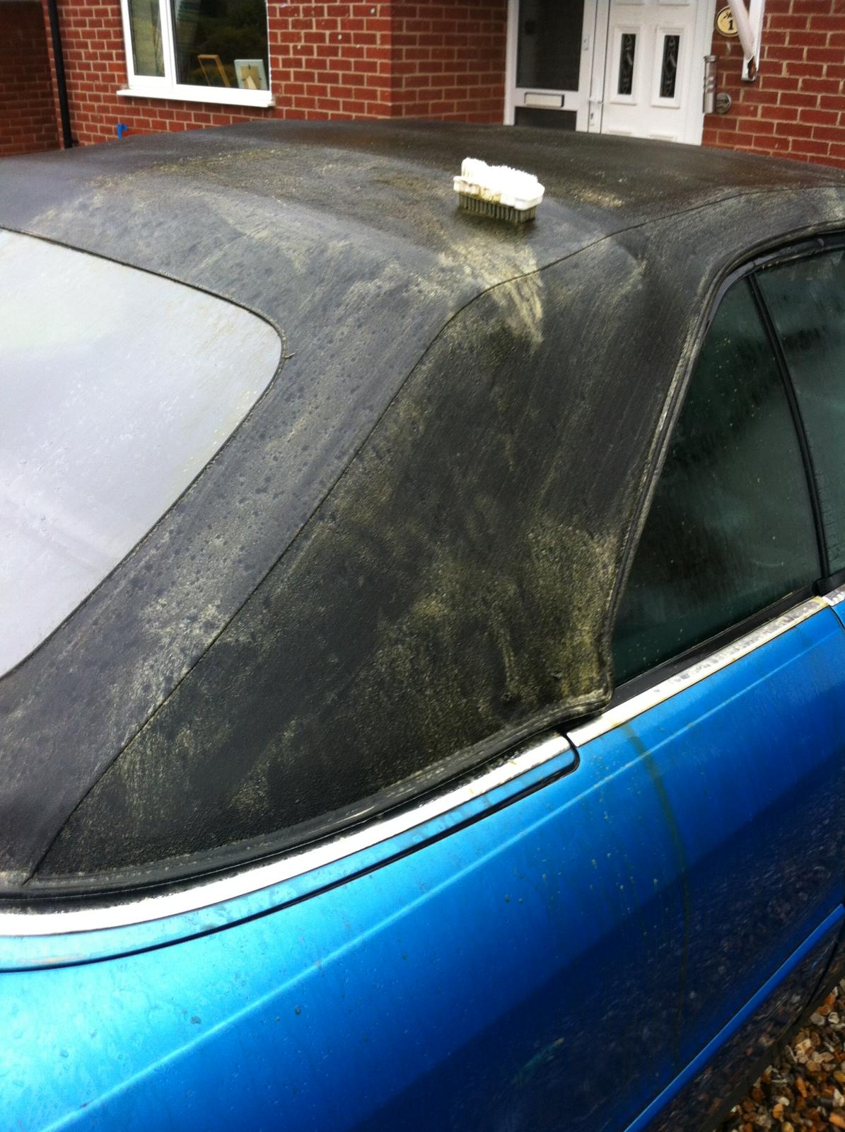

Last night as it was pissing down with rain I decided that instead of sitting in the warm and dry I would go and scrub the soft top of the car.
Grabbed a bottle of all purpose cleaner from the cupboard and a nail brush and went at it for the next hours.
The horrible green shit that scrubbed out was something else! 20 years of accumulated gunge, bird shit, tree sap and whatever else.
Mmmm green!

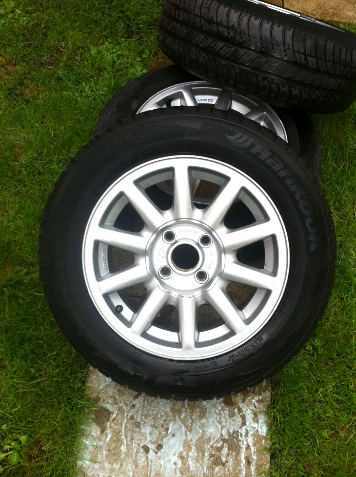

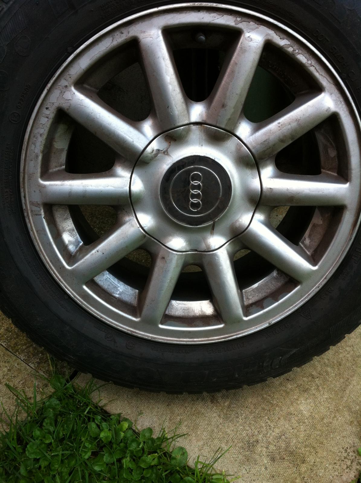

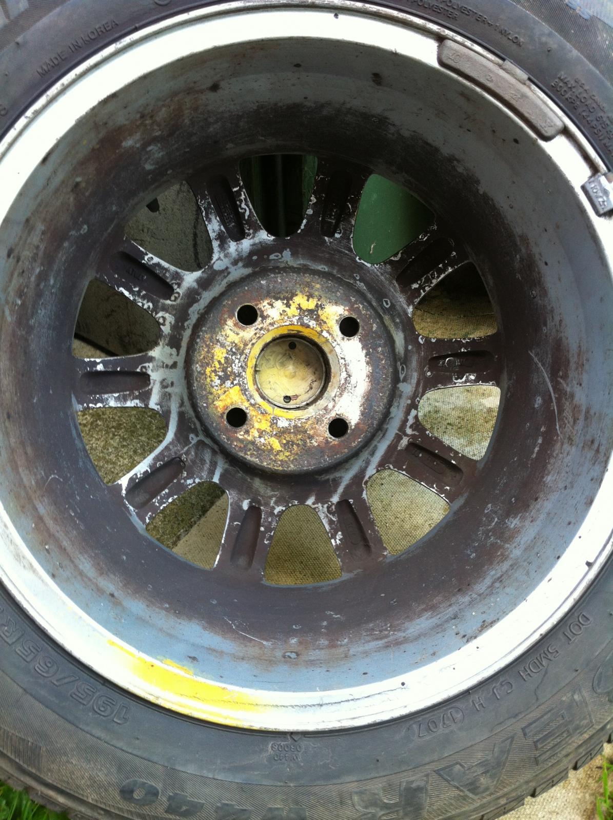

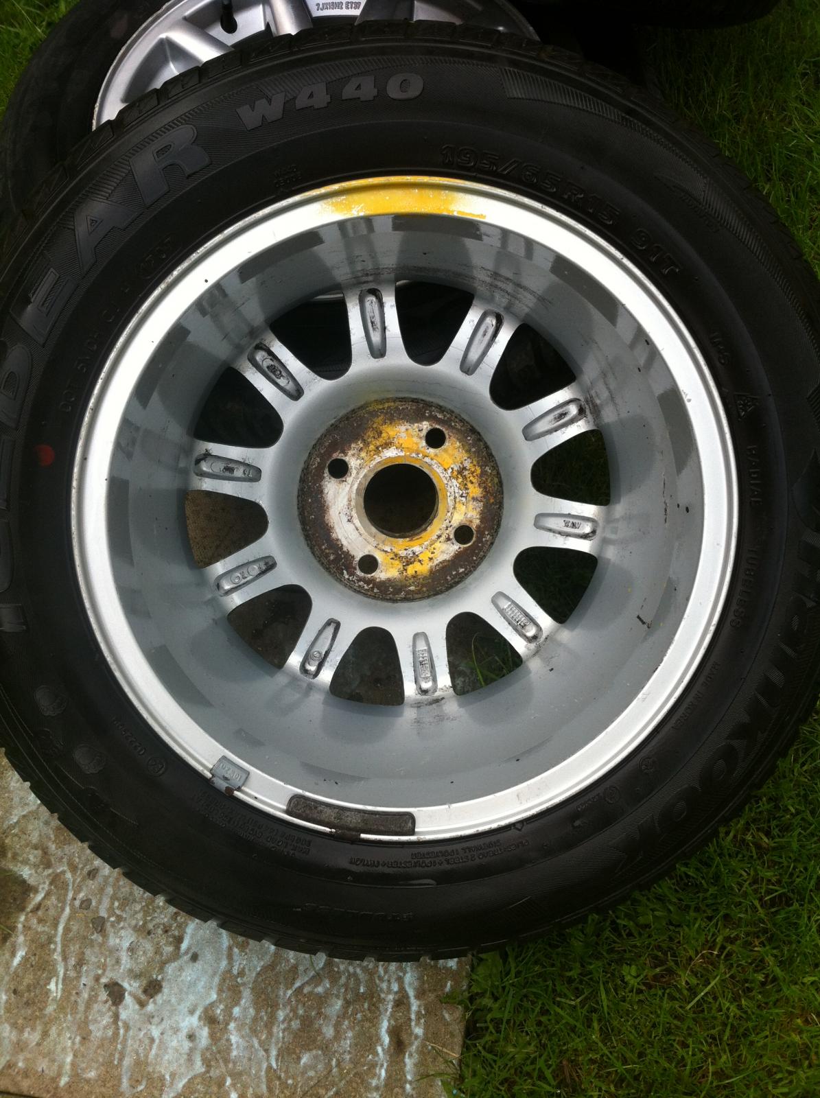

Today with the sun shining I got to clean the original wheels I got last week.
A few curb marks but generally in good condition although really heavy with brake dust got the cleaner out and jet washed them.
Most of it came off but 1 wheel stayed a bit dirty but a huge improvement.

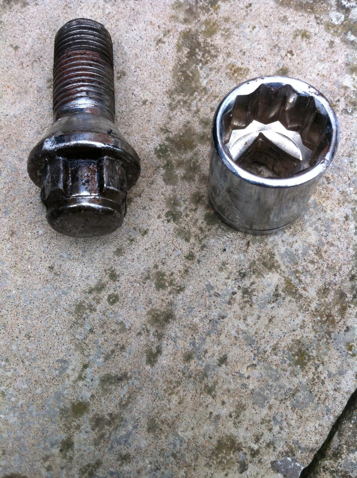

Decided to put them on the car but fate intervened when I realised that 1 of the bolts on each wheel was a security bolt and I had no key to undo them!!! Grrrr.
So I resorted to the knuckle draggers hand book and hammered a smaller socket over the top. After some gentle pressure the bolt came undone, luckily in the past someone had put some copper slip on so they weren't seized.

New wheels on.
That looks better!!!

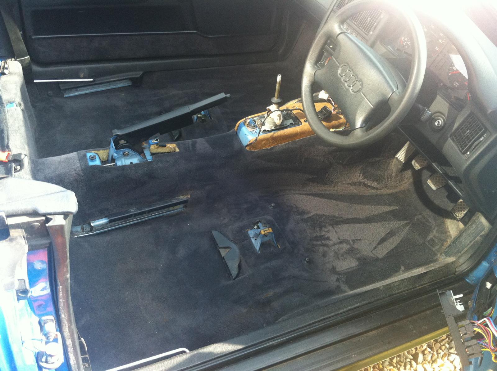

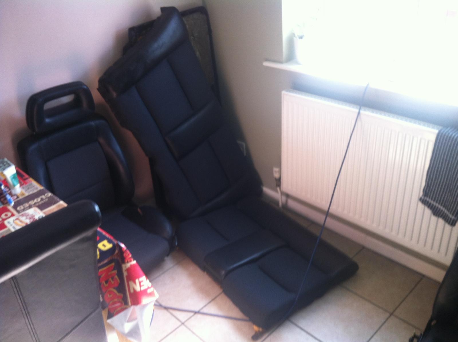

With the spring seemingly here and the day dry and warm I decided I would crack on with getting the Audi ready for the summer.
Despite Mrs Sills rules on not having car bits in the house, she said at the weekend if I wanted to put a seat in the dining to wet vac it I could.
Well she came home to find a whole interior sitting in there, obviously she was chuffed to fuck with it cluttering up the house.
She said when she got home you're taking the piss with that lot brilliant you're getting the car finished. (that's what I heard anyway)
With that all inside I wet vac'd the carpets and got the roof down to help it dry.
The filth that came out was both disgusting and impressive at the same time, 20 years of crap in the carpets and after the 4th load of water it was still filthy.
So tomorrows job more vaxing. Feel this could take some time.
