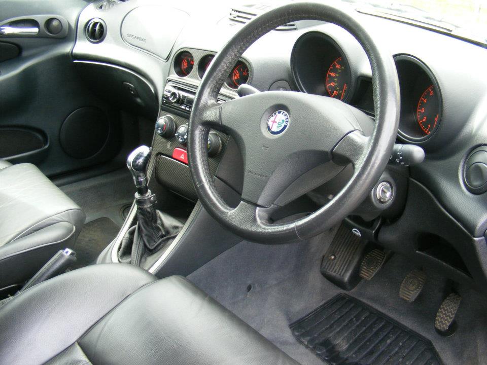

that dashboard is a looker, isn't it? Anyway to squeeze 45mpg out of an alfa with that dashboard?
