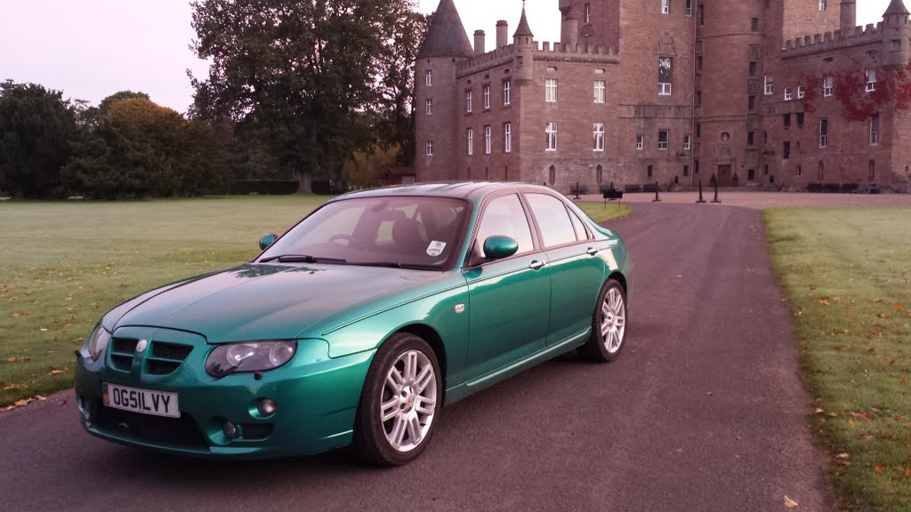

They_all_do_that_sir Posted July 22, 2015 Author Posted July 22, 2015 Nyphur that looks utterly gorgeous. I think these look ace from any angle. Far nicer than the MG ZT Having previously owned a rover metro, 214 (r8), 414 (bubble) and then a 620 I think I'm ready to graduate to one. But thanks chaps I'll do the Google thing Also never had an auto before, are these better with?
