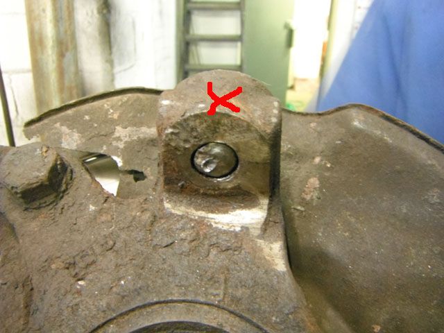

This job is dragging on so much now, it's pretty frustrating.  The parts order came in but it turned out the driveshaft oil seals couldn't be got so I ended up going to Rimmer Bros so I could get them delivered next day just to get this job over and done with.  So we're still not back on our wheels yet and I still can't try out the new clutch to find out if it's that or the gearbox or both that were actually at fault.
Anyway, we got on with what we could.  Mike has been trying to get the remains of the lower ball joints out of the hubs and it's been such a nuisance that we're taking the struts off to resolve it on the bench.  Another of those things that should have been super quick and has just dragged on because the usual methods just aren't working.  Instead, we got the new outer CV gaiters fitted, something that was made much easier by using the cone and the bench vice.

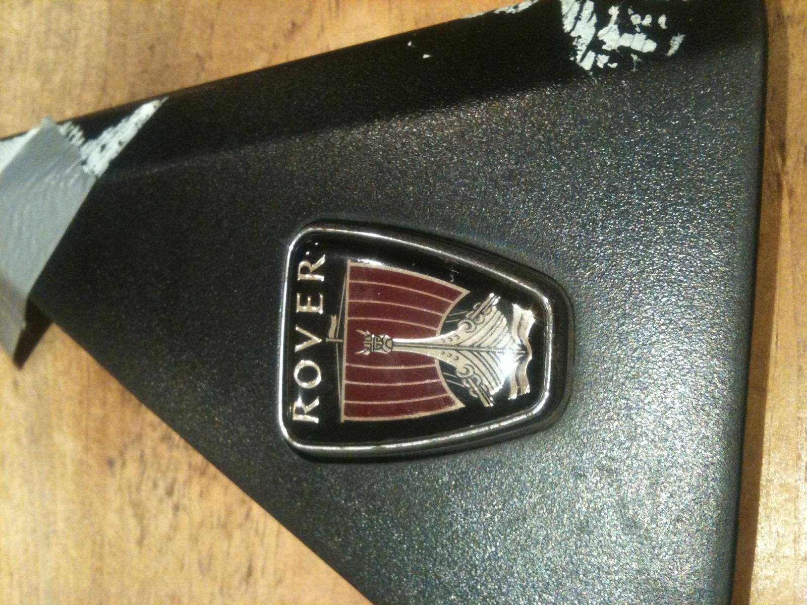

Looks great Angyl, top work on the bonnet.
Do you need a bonnet badge? May have one.....
I think the squashed white Rover is providing one.  If it turns out it's not I'll give you a nudge, I do want one.
Here's the only one I can find now, it's from the other side of the Chompy Rover. I can't think where the two from the blue one went.
So with the two from the white one, that'll be a set of four.
I also went and had a look at the bonnet badge. It's still ok from six foot, but close up it does look like water has got in near the bottom somehow. If Mr_Benn's is any better, I'd go for that one.

Even with three of us, various manual and power tools and lots of swearing we couldn't get this to budge at all.  Tomorrow both hubs are off to the local engineering company to get the bits out and if they can't do it then I need to find some new hubs.  This is all because we tried to undo some castle nuts that were nothing but balls of rust.  Lesson learned for the future:  leave well alone.

Trying not to worry too much about this.  With a relevant hydraulic press we're hoping the stubs will just push out and everything can be bolted back together but what a nightmare it has turned into!  Mike and my brother were mostly fettling with mechanical things and trying to think of a way to get those stubs out so I turned my attention to the deep scratches on the boot lid.  After a few passes with the machine mop and cutting compound I'd got the worst of them out.  It will need some fresh lacquer at the least to get it all sorted, some of the scratches are really deep.

Get a big hammer (4lb or so) and hit straight down onto the retaining collar to release the stuck taper. It's the only way....
Enjoying this. Its moving along so fast, would take me ages to get all this done. Enjoying the bodywork bits,
Or put a big hammer on one side and use another one to hit the casting , provides a shock across the taper and it will fall out
@Scary and Twosmoke:  I'd forgotten about that method, thank you for the reminder.  I shall pass it along to Mike as I'm at my desk today rather than the unit.  Not sure we've got a hammer that hefty but I'm sure something could be fashioned to do the same task.
........or just drill through it? That's how I've done it. Start with a 2mm and work your way up. It will come out, it has to.
