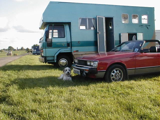

Alan_Green Posted July 20, 2015 Posted July 20, 2015 Never mind about the Freelander. That red car isn't a Subaru Brat. It's a convertible L Series/Leone, right? That car doesn't exist! Well impressed. Those L Series are one of my fave cars of all time.
dollywobbler Posted July 20, 2015 Posted July 20, 2015 I thought it was a Toyota Celica... Alan_Green 1
Honey Badger Posted July 20, 2015 Posted July 20, 2015 Another Vote for a CR-V or if you want a smaller cheaper car some of the old HR-Vs have a the same 4 wheel drive system with a wee 1.6 engine.
Alan_Green Posted July 20, 2015 Posted July 20, 2015 I started off thinking it was a Celica....then decided those were Brat wheels/Brat features....but now I think it's a Celica again. Celica Sunchaser?
KruJoe Posted July 20, 2015 Posted July 20, 2015 That's his 1981 Celica Sunchaser convertible. dollywobbler 1

ifc63 Posted July 20, 2015 Author Posted July 20, 2015 I thought it was a Toyota Celica...As KruJoe rightly points out, it's one of the Celica Sunchasers that I own. I've got 2 weeks off work now, so should really buckle down and get the rear brakes/wheel bearing done and get the rest of the summer out of it.The other half isn't in yet, but I'm going to point her at this thread and the links contained therein. When she goes out and spends the cash on a Freelander, at least I can bring out the old saying of "I told you so!" whilst wearing a smug look !!! ( With my Toyota leanings, I've tried to get her into a RAV4 but she doesn't like the looks of them - what the hell have looks got to do with it ! ). Saying that I nearly got her a Tercel 4WD that came up on the bay a couple of years ago, just think it could be a decree nisi by now KruJoe 1
