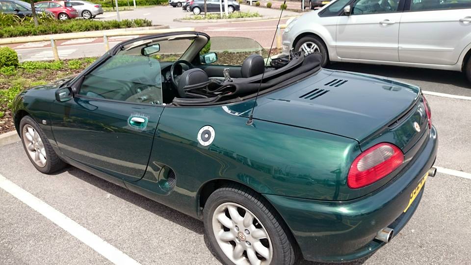

Cavcraft Posted July 8, 2015 Posted July 8, 2015 2000 'W reg MGF 1.8MOT October 9th 2015TAXED TO GET YOU HOMEMetallic council garage door green (BRG, to you)85,000 miles.To be fair, it actually looks really tidy. Take a guess at the first fault... 'It hasn't overheated, but sometimes loses water, but it's not bad because I put some of that cement dust stuff in that seals it' Also:The exhaust blows quite badlyThe n/s door handle surround is sellotaped on.I think he said the fan belt squeals. £225 collected from Chester. Hopefully it's worth that in parts/weigh in if nobody wants to fix it up, the interior is nice and it has alloys. brownnova, Aston Martin, Barry Cade and 2 others 5

purplebargeken Posted July 8, 2015 Posted July 8, 2015 Worth 150 to 200 for the seats and about 100 to 150 for the wheels. Colour code HAM or HFF?

purplebargeken Posted July 8, 2015 Posted July 8, 2015 Coolant loss could be any of the following: Coolant bottle cap (more common than you might think) - replace and monitor, do this as a yearly service itemHoses - various - replaceUnderslung coolant pipes - replace with stainless pipesCoolant pipework fixings - whateverRad leak - replace with ally rad from a TF None of the above are major or that costly. OMGHGF Drain coolant to get rid of that shite he has put in, flush, refill and bleed the system properly (3 bleed points), use OAT coolant. Monitor closely. Exhaust - it's only small and pretty bloody easy to access. Get one from a breaker or cheapish on fleabay. Get the fucker bought Billy you git, one car I cannot buy. Thanks a bundle 'mate' Taff, Barry Cade and eddyramrod 3

Taff Posted July 9, 2015 Posted July 9, 2015 as PBK has said, exhaust is cheap enough to put right, mine was £35 quid inc gaskets. Those seats look nicer than mine, as do the door cards, and the alloys should probably fetch £100 if the tyres are any good. As for the water vanishing, follow the procedure that PBK suggested and keep an eye on it. Beer money motoring in a soft top in this weather? get it bought

Pillock Posted July 9, 2015 Posted July 9, 2015 Do it, these are a hoot.Worst case as Ken says, interior and wheels will see you even, the hood looks OK too so £100 there. Then just list panels on eBay waiting for all the Fs that haven't been driven all winter to go backwards through a hedge on their shiny tyres. Taff, purplebargeken and eddyramrod 3
Taff Posted July 9, 2015 Posted July 9, 2015 good point, whats the hood/rear window zip like? as in, does it work at all?
Station Posted July 9, 2015 Posted July 9, 2015 K-seal 'cement' is the best thing you can do with these stupid engines, it's the only thing that fixes them permanently. BorniteIdentity and the judge 2
BorniteIdentity Posted July 9, 2015 Posted July 9, 2015 ^I have to agree^ I had a leaky K Series in my 75. It was a straight choice between £350 for a specialist to do it on my driveway after a 6 week wait, or £15 in Tec 2000 "Stop Leak". It worked a treat for 10,000 miles before beginning to lose coolant again. Another £15 and it bought me another 10,000 miles before it started to go again. Repeated for the third time and sold the car. So a saving of over £250 and it kept me on the road. It's not all shit.
