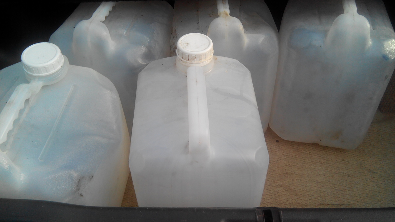

That'll be the first 5 tub's of Yorkshire's finest* WVO emptied now.
All is well, and the boring produces considerably less smoke than a certain white Peugeot. There's no noticeable difference when running than on SVO or diesel.
Starting on 100% WVO was a somewhat difficult, so I dropped down to 50% veg with the same diesel and normality was resumed. I'm now upto 80% veg and starting is fine. I was thinking a while ago that the starter was getting a tad lazy (currently 238k) so I have purchased a reconditioned starter motor for the boring that I'll fit at the weekend. I'll try 100% veg again with the new starter.
