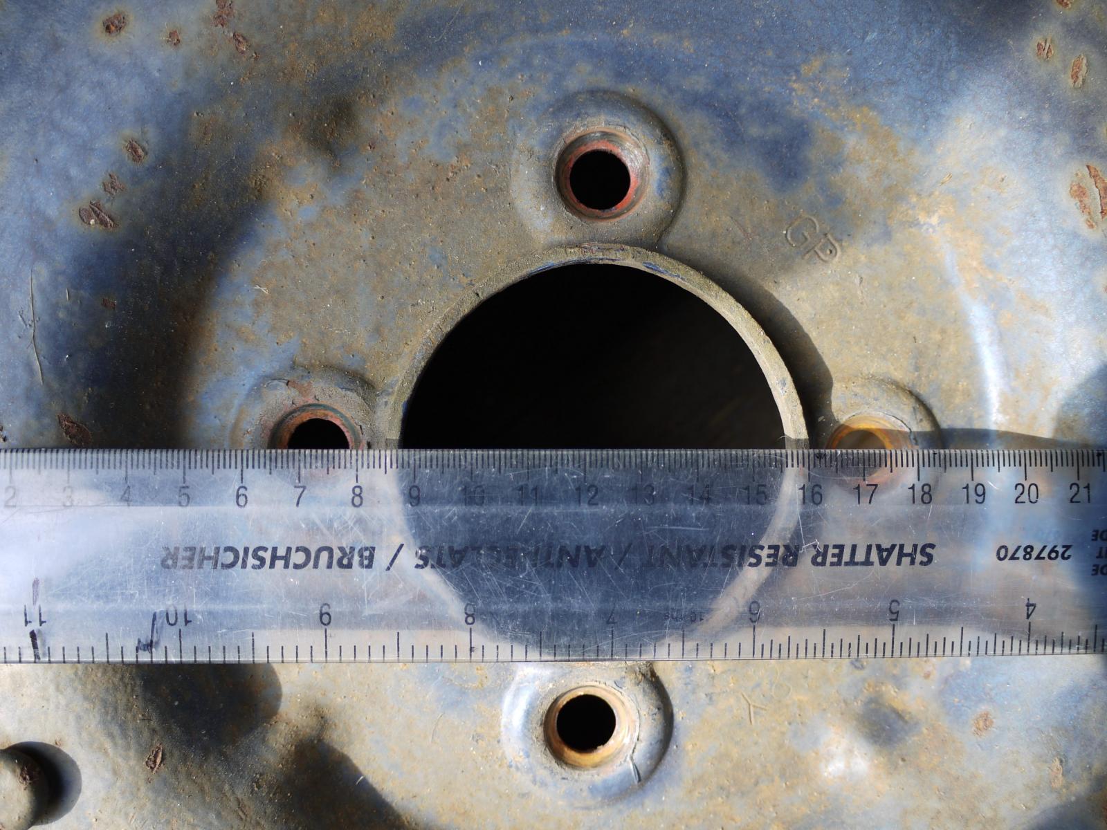

What the heck is this wheel off?
Any ideas? It came from a small car trailer that used to be a very small caravan (just the right size for moving 1922 Peugeot around). We need a spare wheel really, but the local trailer place were perplexed as to its origins. I guess it's actually a car wheel as it has nodule thingies for a hubcap to clip onto.
Some rough idea of size and PCD in the photos, but I'm hoping somebody will just recognise it instantly. It has two very faint markings cast in to it that read 'GP' and 'R127Y' (I think)
Any suggestions, however stupid, gratefully received
Cheers!

Odd, the PCD is a bit weird going by your ruler - about 95mm?? 100 - yes but 95? Or is it an old imperial size?

Early Austin Devons are 4.5" (108mm) - I have a set of those. Not sure if really early ones were 4" PCD, which is what I think that one you have is.   Nothing Austin/Morris is 3 3/4" (95.25) until you get to Marinas.

If it is 4" PCD it might be easier to get hold of three 14" Minor wheels assuming the trailer sits OK with them.
Morris/Austin etc 95.25= 95.25mm PCD.

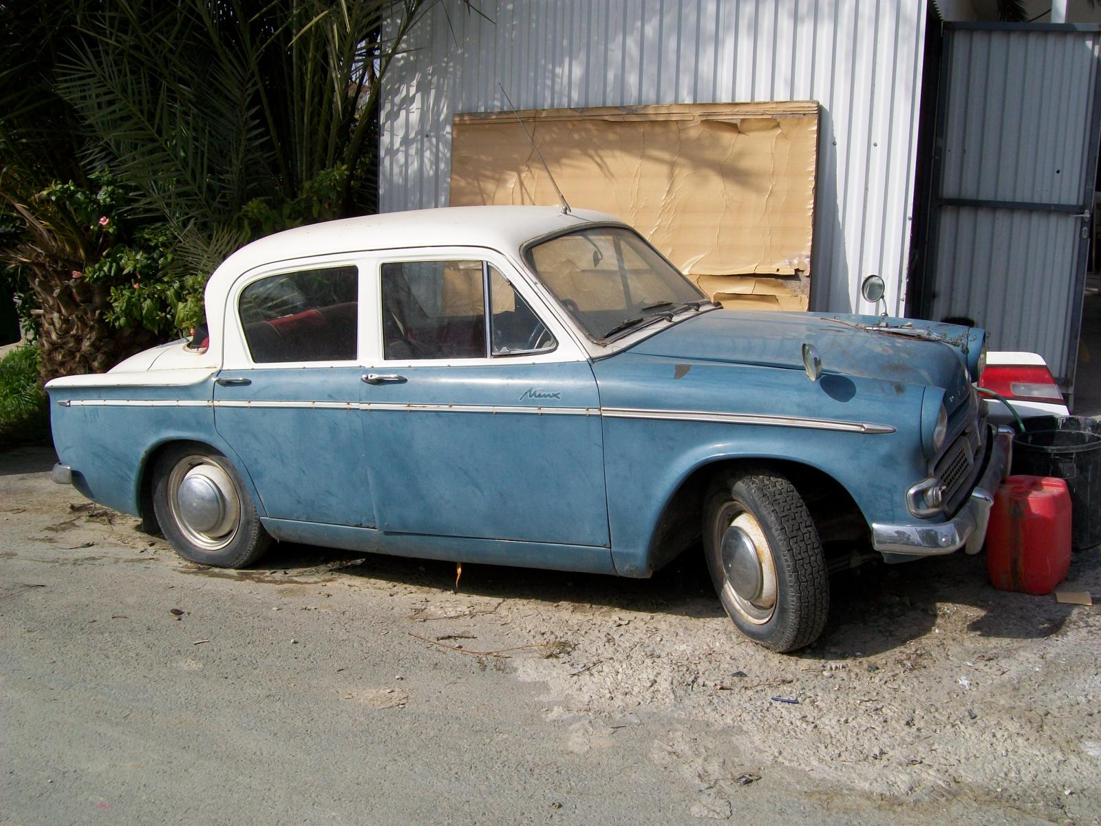

My first thought was Hillman Minx, late 50s.  Like so...
Pretty sure they had 15" wheels up to about 1963-ish, and they would be 4-stud.

I am sure it is the Hillman above, or the previous model, as soon as I saw it I thought Hillman and am sure they had those lugs for the cap.

The Minx seems to be roughly 4x108 though, which would put it out of the running.

Yes, Hillman would be my guess as well, there's a guy in the Counties club who tows a huge caravan with his Somerset and fits 15" Hillman wheels on the back to lower the ratio for towing.

If Barrett could confirm the PCD (the photo makes it slightly tricky to gauge due to the parallax but I reckon is 4") then we could discount lots of possibilities.

The Hillman 15" rim is the same 4-stud pattern as the Ford escort/capri/Cortina. The Minx rims are also popular amongst the Hotrod fraternity.
