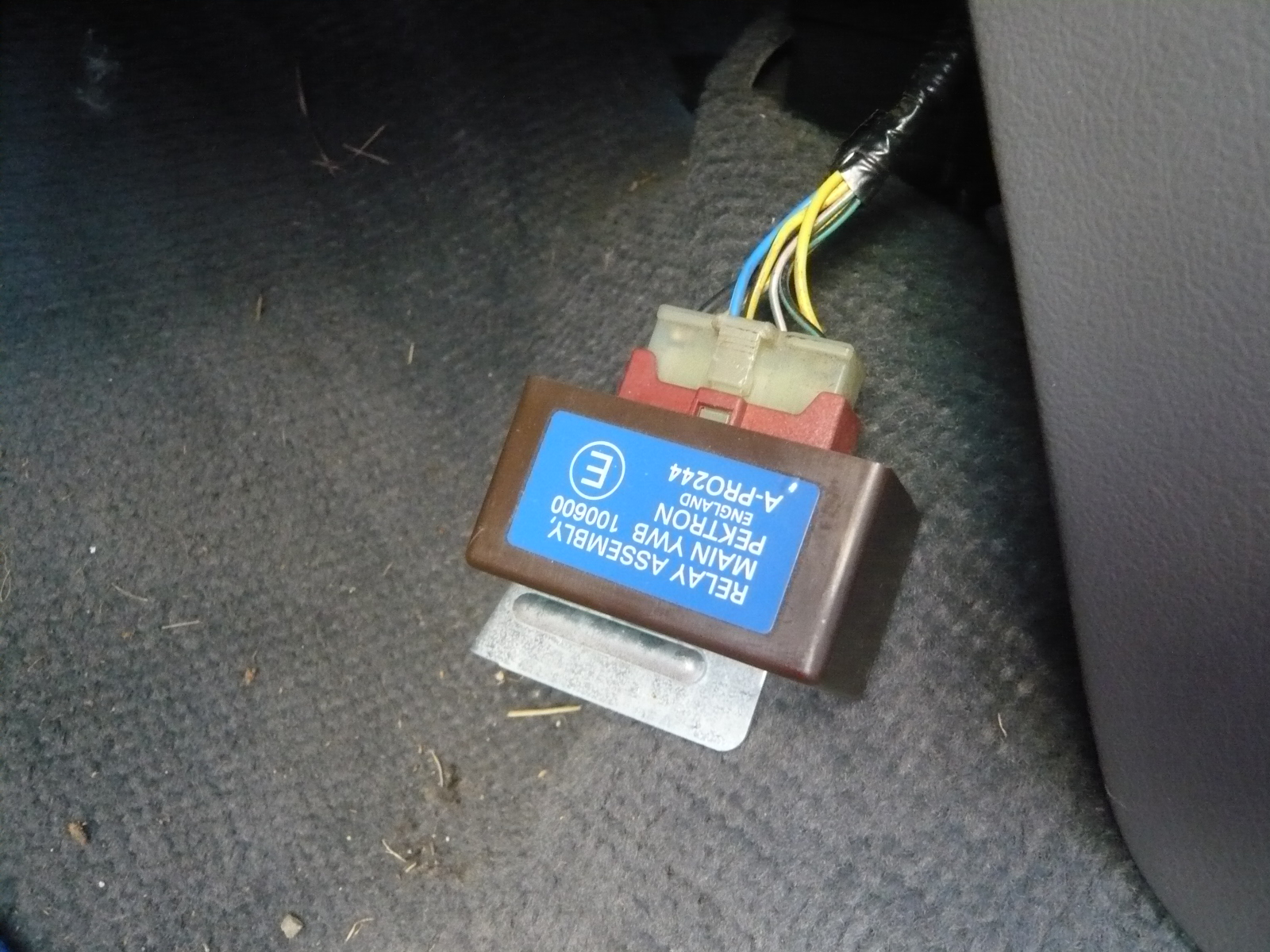

KruJoe Posted May 19, 2015 Posted May 19, 2015 Hondas of that age are notorious for it, as are the D-series Rovers like mine. I don't know why it always presents as a hot-start issue - pez stops seem just the right* time for it to be turned off, then FTP.On the Rovers, it's the brown fuel pump relay hidden behind the radio. It could be accessed by lying on ones back in the passenger footwell, so no need to remove the console.After a while of living with it, I got used to listening for the 'click' as the fuel pump tripped off about two seconds after turning the ignition on (just as you'd wait for the heater plugs to go off), then I knew it would start.That was until I got off my arse and up into the field for the known good relay from my spares car. That one is still dangling from its wires into the passenger footwell, as I've yet to unbolt the troublesome one from its bracket. The relays can be repaired, apparently it's common for a soldered connection to fail inside, and just needs re-doing. I still don't know why it only presents in hot-start situations. Weird but such a common fault. Edit: Here's my brown relay, it is shown as black in that link posted above. skattrd 1

PhilA Posted May 30, 2015 Posted May 30, 2015 The relays can be repaired, apparently it's common for a soldered connection to fail inside, and just needs re-doing. I still don't know why it only presents in hot-start situations. Weird but such a common fault. Physics. I've had this with relays before. Cold, everything settles to the position it needs to and works. It all heats up at about the same rate and everything stays in line and connected. Leave it to cool off a little and the main contacts cool off faster than the coil as they have somewhere to sink the heat to (wiring) and the relay twists just enough as it cools to break the marginal contact. Once it all cools down it pulls into line again and normal service is restored. --Phil
