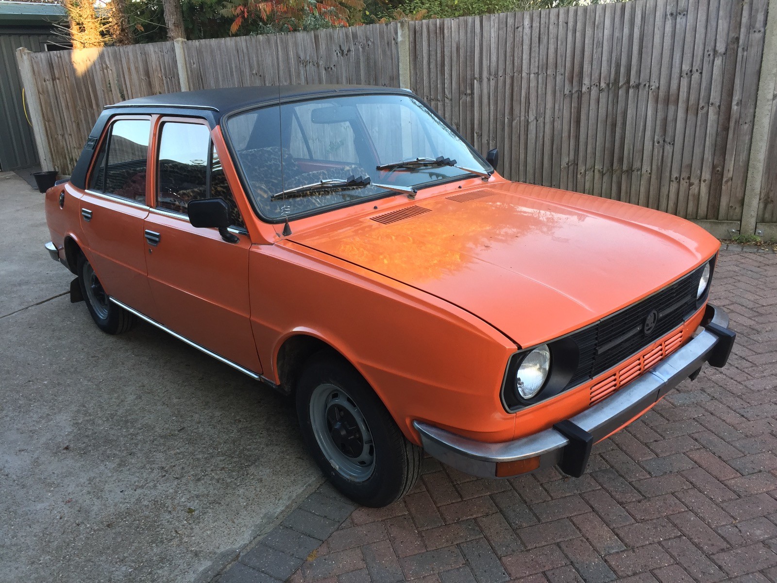

DodgyBastard Posted October 13, 2018 Author Posted October 13, 2018 I managed to get it up on the ramp, it looks fairly solid underneath. There's a few areas of surface rust in places, one of the inner sills looks to have been welded in the past but looks like it might get away with cleaning up and treating rather than any welding. RJC_4931 by srblythe, on Flickr RJC_4933 by srblythe, on Flickr RJC_4934 by srblythe, on Flickr RJC_4935 by srblythe, on Flickr RJC_4937 by srblythe, on Flickr RJC_4938 by srblythe, on Flickr RJC_4939 by srblythe, on Flickr RJC_4940 by srblythe, on Flickr RJC_4941 by srblythe, on Flickr RJC_4942 by srblythe, on Flickr It's been here two days and already people have been asking if its for sale, one guy wanted to swap a mk3 Escort ghia for it and someone else said it was worth £2k as it sits. I'm not really seeing it somehow. We had a go at starting it by hitting the starter with a hammer until it started turning, yesterday it was just clicking so getting it to just turn over was a step in the right direction. It isn't getting a spark at the leads, there's power to the coil and there's a spark at the points, the previous owner said it was the condenser at fault so will need to order one and see what happens. I got a couple of other things done on other cars, I fitted a pair of tyres to the front of the Proton, it no longer wheelspins in the wet and I fitted a starter motor to the mk2 Polo, it now seems to start and run ok. There's still a few bits it will need for an mot but it's not far off. M'coli, skattrd, Skizzer and 13 others 16

DodgyBastard Posted October 19, 2018 Author Posted October 19, 2018 Still can't get the skoda to run. Replaced the points, condenser, ht leads, rotor arm, distributor cap. Getting spark and fuel, pops and bangs when tow starting it. Have set the firing order according to the manual and tried numerous variations but still no luck. Sent from my G3311 using Tapatalk
Zelandeth Posted October 20, 2018 Posted October 20, 2018 They can be a sod for fouling plugs when sitting for a while. Get them all out, hit them with the torch so they're cherry red, then throw them back in and start it as if flooded. In my experience, it'll go first try. LightBulbFun and Rocket88 2
DodgyBastard Posted October 20, 2018 Author Posted October 20, 2018 I've never really seen a 305 rust that bad I always thought they where quite rust resistant really DSC_0191 by srblythe, on Flickr DSC_0194 by srblythe, on Flickr DSC_0300 by srblythe, on Flickr RJC_1320 by srblythe, on Flickr RJC_1328 by srblythe, on Flickr In hindsight I should have just fixed this one. DSC_0841 by srblythe, on Flickr Instead I used bits from this one to fix 4 other 305's. loserone, alcyonecorporation, theshadow and 2 others 5
daverapid Posted October 20, 2018 Posted October 20, 2018 Still can't get the skoda to run. Replaced the points, condenser, ht leads, rotor arm, distributor cap. Getting spark and fuel, pops and bangs when tow starting it. Have set the firing order according to the manual and tried numerous variations but still no luck. Sent from my G3311 using Tapatalk That's definitely a timing/firing order issue. Set the crank to TDC and post up a pic of the distributor with cap off and also of the order the HT leads are fitted

DodgyBastard Posted October 26, 2018 Author Posted October 26, 2018 RJC_4970 by srblythe, on Flickr Derskine came round and gave me a hand trying to start the Skoda, I took the rocker cover off and got it to tdc on cylinder one then put the leads in the correct order. It sounded like it was close to firing but backfired out the carb. Derskine reset the points gap then started to adjust the valve clearances when he discovered that the 5th pushrod wasn't moving at all when turning the engine over.I removed the rockers and side cover of the engine and discovered that one of the followers was seized, I tried tapping the pushrod which moved the follower down but then when I turned the engine over the pushrod would go up but wouldn't got back down. I had hoped that doing this a few times would free it off but didn't have much luck.Now I need to work out how to remove the follower. If it's an engine out job then I'm probably going to try and find a 1.3 Favorit engine. worldofceri, the judge and egg 3
Zelandeth Posted October 26, 2018 Posted October 26, 2018 Odd one that! Luckily engine out is probably less than an hour's work with the gear you have there. Two things...Number one, the top bolts on the bell housing as I recall are a total, absolute swine to get to. Two: the engine will try to flip itself upside down the moment it's freed from the car thanks to the way it's balanced. While it's out, you'd be a fool not to change the clutch release bearing. They are made of cheese and like to fail at the drop of a hat. I've had four engines out of Estelles - every single sodding one to change that five quid bearing. Biggest headache to sticking the later engine in is the mods needed to the sump and oil pick up as I remember, other than that it should be pretty much plug and play. Exhaust manifold may also be an issue, but I'd be surprised if there's not someone in Eastern Europe these days that doesn't have a kit on the shelf to do the job. These cars do have quite a strong following these days. tooSavvy, LightBulbFun and DodgyBastard 3
