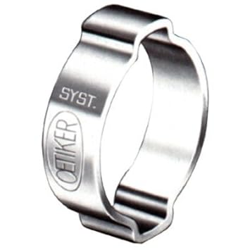

Noel Tidybeard Posted April 10, 2018 Posted April 10, 2018 New filter with all important bleed screw now in place. RJC_0845 by srblythe, on Flickr It seems to drive bit better now but I'll need to get some clear fuel line to make sure there's definitely no air in the system. while you're at it throw the jubilee clips in the bin they are wrong for diesel pipeage as they don't do up properly round and cause air leaks
nisfan Posted April 11, 2018 Posted April 11, 2018 What are you meant to use instead of jubilee clips?
DodgyBastard Posted April 11, 2018 Author Posted April 11, 2018 What are you meant to use instead of jubilee clips? I'd imagine it would be something along the lines of those crimp type fuel hose clips.
dave21478 Posted April 11, 2018 Posted April 11, 2018 Aye, crimp clamps are supposed to be used.......which is grand if you have the right size to hand and the proper tool to crimp them. There is not much range of pipe that each size will clamp properly, so with all the variations in fuel hose you really need a handful of different sizes. I just use wee jubilee clips myself and if there is trouble sealing with one, I put a second on next to it but with the drive section round the other side of the pipe to the first one. Oh, and those things are single-use and need to be cut off if you need to remove the pipe. DodgyBastard and richardthestag 2
garbaldy Posted April 12, 2018 Posted April 12, 2018 You can reuse those crimp clamps if you have a small enough screwdriver to pry them open but they are cheep enough anyway to replace. Jubilee clips are crap use these. DodgyBastard 1
