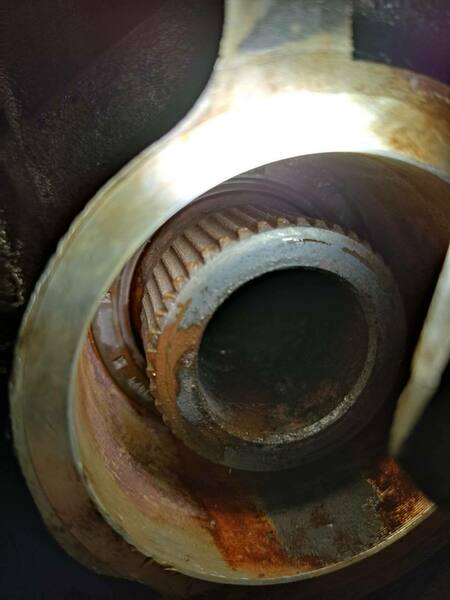

It went over to @NorthernMonkey to have the 2WD situation sorted. I got the repair sleeve from the Volvo dealer in Huddersfield (£130) and NM got the angle box off to see if a new one would be needed, and it was. Was able to find a good second hand xfer box in Manchester for £120 (wrongly listed as a rear diff).
It's almost impossible to picture but these were the splines on the input to the old transfer box, on the outside edge they are OK as that part wasn't engaged with the sleeve but about 2mm in they are worn smooth. The connecting sleeve splines were also completely worn off.
Apparently this is incredibly common on them and unless you went looking for it you probably wouldn't know unless you tried to drive it up a damp field as they are FWD by default and the rears only kick in when slippage is detected. The test is to stick your arm under when it's parked and try to turn the prop, if you can turn it by hand then this connecting sleeve and/or the transfer box are fucked.
I was glad I took it to NM for him to do on the ramp. As ever with these things there are plenty of people insisting they did it on their gravel drive in 2 hours with some bailer twine and a scissor jack from a Corsa but he had a fair old struggle to get the old box off and that's with a ramp. Access to the bolts holding the transfer box to the gearbox is almost non existent. After all that I am pretty sure the 4WD is working and there are no new lights or warnings from the Haldex etc which is another thing that can happen.

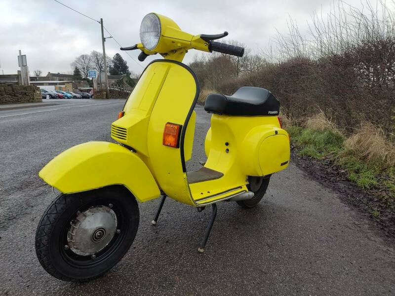

What's this, a shit old moped ACTUALLY OUTSIDE THE HOUSE? Oh yeah it is.

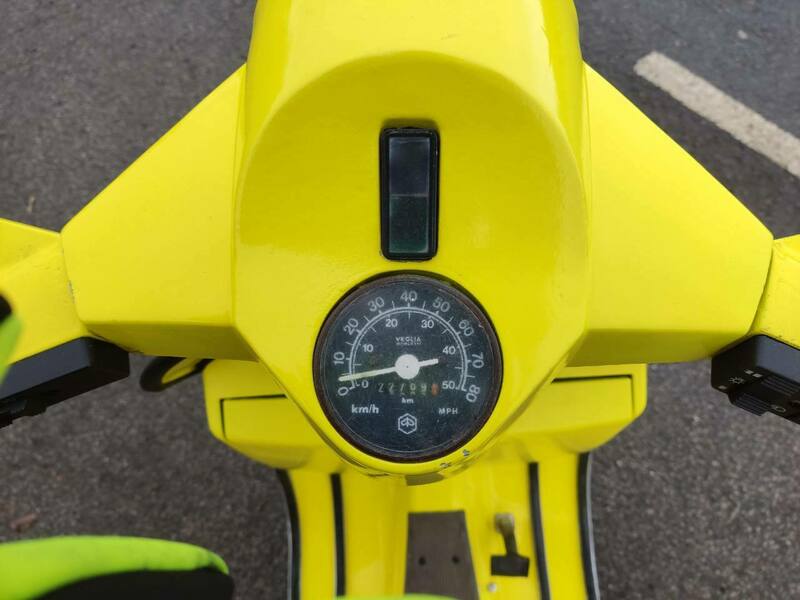

This scooter has actually been about 95% finished for ages but I've pulled my finger out over the last couple of weeks and got it up to 98%.
I did actually ride it on the road once when the numberplate first came, but it had no lights so I really wanted to sort that so people have less excuse for driving into me.
I'm pleased to report that it's pretty fun to ride. The engine is kitted, a "115" Polini (actually 111.something cc) with an unknown expansion exhaust.
It can definitely "keep up with traffic" although really it's cruising speed is about 45mph. 4th gear is really long (a feature on these) so you have to hang on to 3rd as long as possible and change to 4th at 40+ to keep accelerating. I reckon it's probably geared for 60mph but only has the power to get to 50-55, and that would be on a very long straight road or a slight downhill.
I can't tell you how fast I achieved though as i MAXED OUT THE SPEEDO on a slight downhill. Probably about 51mph.
Anyway I am chuffed to get the little thing "finished" and will continue taking it out for a blezz now and again when the weather's OK. Nothing fell off or owt but I feel like you need to build up a bit of confidence in a steed, especially one bodged together from bits in your own shed.

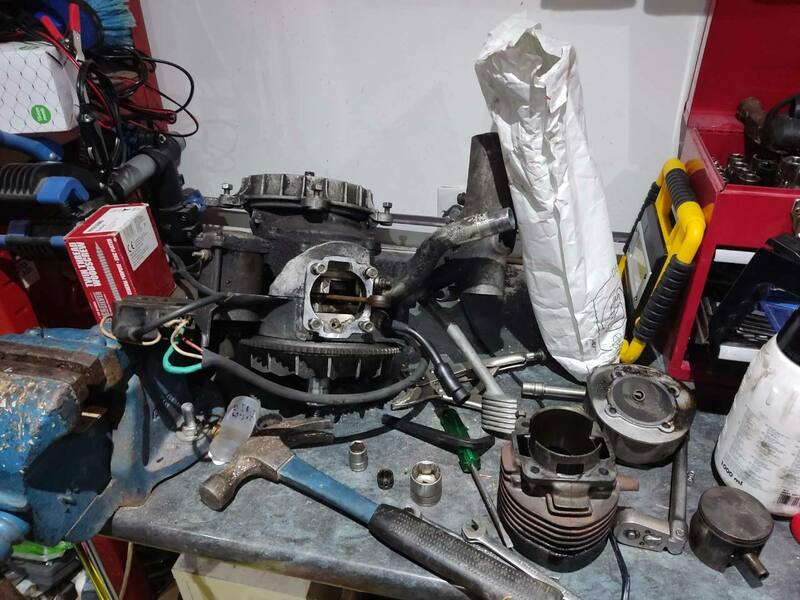

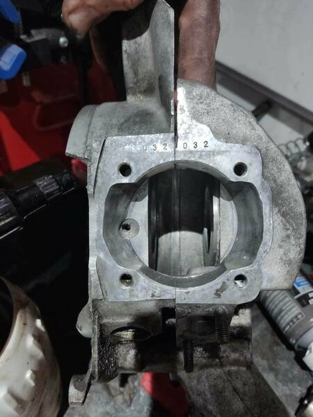

Started stripping the Vespa engine today to fix this oil leak on the gearshift.
Got it out of the frame and removed all the stuff I can with hand tools, had to stop as it's a bit late for the impact wrench.
State of play:
I wasn't planning to change the barrel and piston but they are not looking great.
I guess it’s an iron cylinder? How about trying a DIY hone and some new piston rings? Since it’s maybe knackered anyway you could get busy with the dremel: open up the exhaust port, maybe flow the cases bung it all together again, adjust squish/port timing etc and seeing if you can make it rip!
Alternatively if it’s new cylinder time know that VMC are knocking out some great kits for these (cranks too I think), available from avotechnica or 10pollici in Italy. In the pre brexit days it was soo cheap to buy from them but it might still be worth it now.
Yeah you are about on the money there.
The barrel might hone but the piston I think is too far gone so I am just gonna go for it, I was close to ordering a crank and a kit anyway.

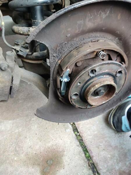

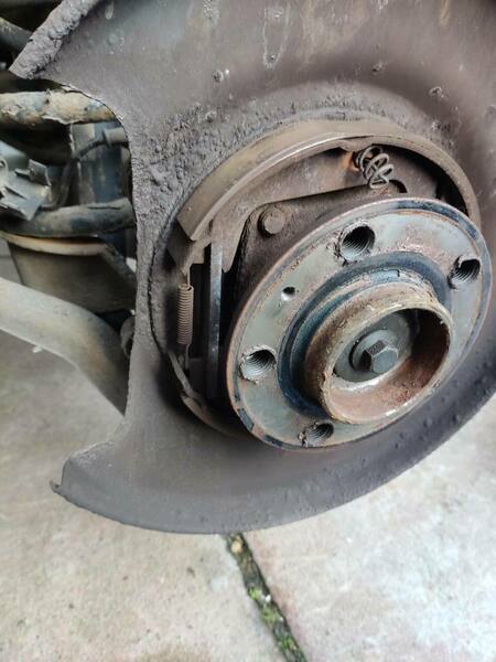

Volvo blotted it's copy book last night, just refused to shift out of park outside child #3s school. Couldn't get it out so walked home.
Went back for it later and managed to get it going. There are 2 locks on the shifter, a cable operated thing off the ignition lock and a solenoid that works off the brake pedal. Disconnecting the solenoid got me out of park. I'll order a new brake switch and just leave the solenoid disconnected for now as it still seems to be failing to disengage intermittently.
Outside the school you have to park on a hill and as I was failing to get it out of park I did wonder if the fact it had no functioning handbrake could be a problem and the load of the hill on the parking pawl was stopping it disengaging. I don't think it was but it gave me a kick to sort out the handbrake.
The handbrake shoes are inside the rear discs.
I was expecting a war but whoever was here last put copperslip on all the bolts, what a ledge.
As such I was in quite quickly and at the cause of the problem.
From the factory there is no adjuster on the handbrake shoes, just a solid bar. This seems like a rare moment of shit design from Volvo, WTF are you meant to do as the shoes and drums wear?
This is common across other P2 Volvos I think. Luckily, you can just put adjusters in. These were £12.99 for a pair of genuine Volvo parts.
Now like any normal car you can pop a screwdriver through a wheelbolt hole and adjust it up to work nicely. I was expecting to have to tighten the cable as well but it all worked spot on once adjusted on the drums.
Nice easy job overall, recommend if you have a Volvo with a shit handbrake.

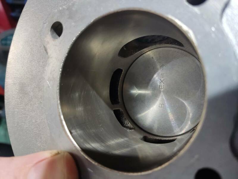

Nearly have everything here to rebuild the Vespa engine, shit is getting serious now.
Check out the transfer ports on this badboy compared to the polini (which is already slightly larger than stock)
Portage from above:
Quite a lot of material needs taking off the case side to match. Need to go careful as these standard cases are quite thin in this area.IMG_20220214_162058.thumb.jpg.e96e4b26feac65e92df138c5c66c689e.jpg
Also have a 24mm carb and a race crank with extended inlet timing.
I am starting to see that I need to take my time over this to get a good result. I need to do the case porting, then get the case machined to fit a bush to the gearshift. I may also try to get the flywheel lightened at the same time.

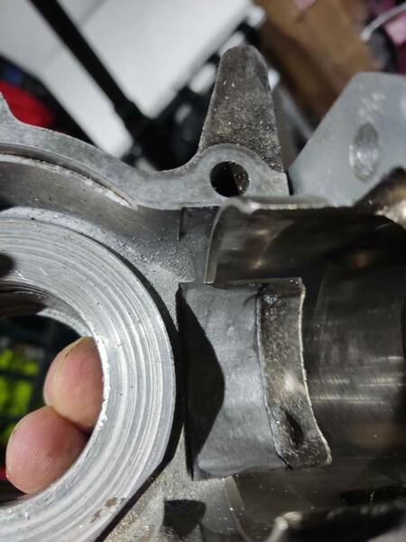

Been chipping away at this porting job.
Started with these little sanding drum things but they went blunt very quickly,
Carbide burrs were purchased and they are much better.
Taking my time and trial fitting the barrel to check and mark where to cut.
Getting closer, still more to take off in the RHS of the pic here to get it closer to the cylinder skirt
Finished matched case on clutch side:
New vs old:
Started on the flywheel side tonight:
Had to stop as dremel out of battery.
New vs old:

The difference in port size really is ridiculous ain’t it! I’m sure I’ve seen some porting jobs where they also smooth that step that sits next to the crank webs. Not sure if that’s only a large frame thing though so definitely don’t take my word for it
Thanks, I have scanned a few threads etc and most of the smallframe ones seem to leave that step in, maybe its a disc valve vs reed thing? I am keeping it disc.
This thread is using a similar cylinder and the transfers look similar so I am relatively confident I'm OK.
https://vespasmallframeforum.proboards.com/thread/23211/vmc-pro-cup-3
I am not too sure about the running in situation, I have heard conflicting info. As this is an alloy/Nikasil cylinder some sources say you don't really have to spend a long time running it in and more or less ragging it from the off works fine.
It will probably take me about 4 years to do 500 miles so I think this strategy is gonna have to be the one
The disc vs reed theory makes perfect sense actually- with disc I guess you need those cheeks to sit nice and tight against the crank webs whereas with reed that wouldn’t matter.
And yeah I forgot you said it was an alloy cylinder- you’ll be ripping in no time!!!
Calling this done now, I roughed it all out with the carbide burrs then whizzed over it with the little sanding drum then finally a mini wire brush type deal that I had in my "my 1st grindyboi" dremel accessory kit.
No idea if thats textbook or not but seems to have worked for me. Not exactly polished but definitely pretty smooth. It looks a bit wonky but it's matched to the cylinder so should work fine.
Next I need to get the clutch side case machined to have a bush pressed in to stop the gearshift leaking, also going to get my new flywheel turned down a bit as it's meant to help things.
