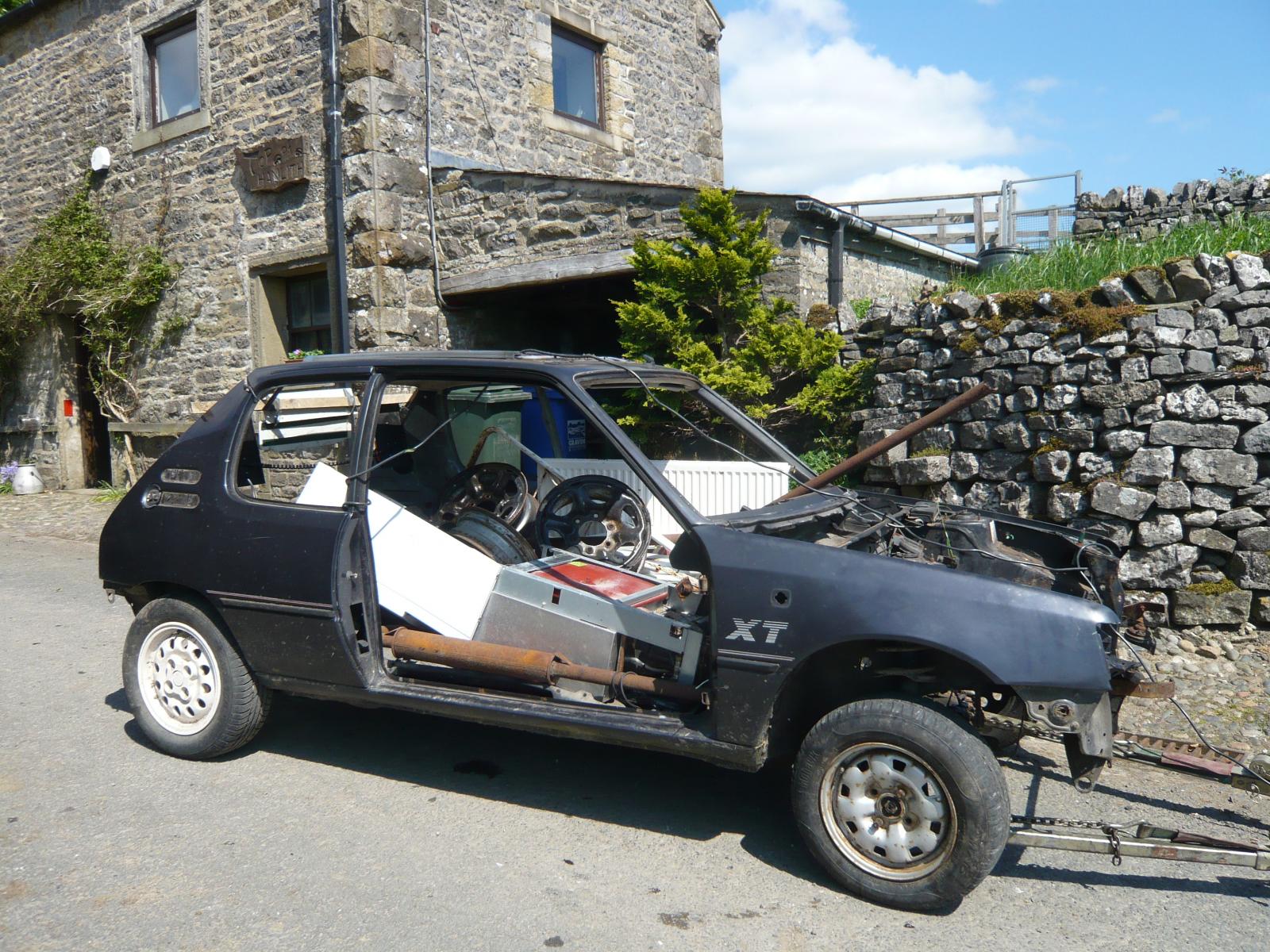

KruJoe Posted April 11, 2015 Posted April 11, 2015 The outer end of the driveshaft needs to remain in place with the hub nut to hold the bub/bearings together. I may not last long without. Remember the inner end needs to be held roughly where it would sit in the gearbox - if the angle is too great, it may flail about in a most alarming manner. To avoid a repeat of your disastrous (Micra?) experience, don't forget to place the rigid "hooks" in front of the lower arms, pointing over and backwards, with the chains going over the top, then around the bottom, and forward to the ratchets. Once hooked up, fit the locking bar between the arms to prevent doing the splits under braking. Try to set off in a straight line, if not possible, set the wheels of the towed car to the same direction you'll pull away. HTH. alf892 and JohnK 2
explosive-cabbage Posted April 11, 2015 Posted April 11, 2015 A trimmed off length of brake pipe makes a brilliant hook for a wild driveshaft.
KruJoe Posted April 11, 2015 Posted April 11, 2015 Aye, the brake pipes had been cut on this, and were in the right place to hold the shafts.
