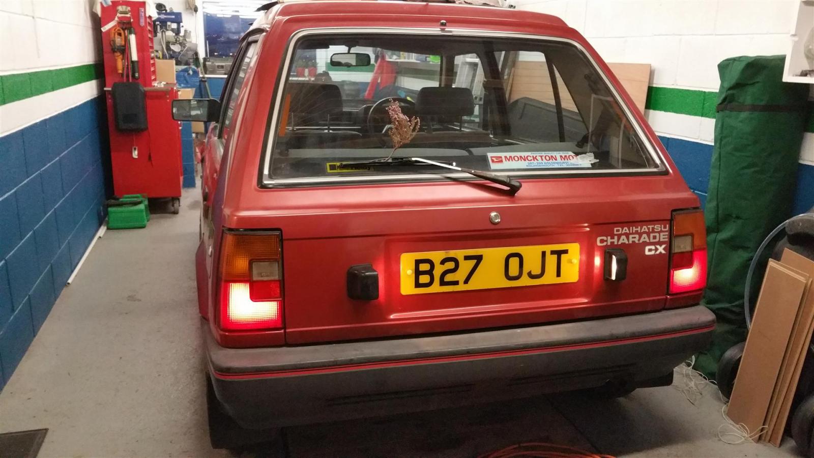

The fuel pump made its way from Australia...at which point I got stung for VAT. Oh well! At least we're back in business engine-wise. It'll sit and run quite happily, warming up, fan cutting in. All is well. The idle is a touch fast, but I expect some fine tuning will be needed once it's out of the garage. I can't wait to find out how good/bad a 1.0, 3-cyl, 2spd auto actually is. One thing is for certain, and that is it will be different!
In other works, the rear valance has been welded and painted. Austin-Rover Oporto Red is a spot-on match for whatever colour this car actually is. Quite chuffed with that, especially as I had loads of Oporto Red rattle cans in stock! The rear end is now bolted back together and the car is 'complete' once more.
I've also tackled an easy - but very satisfying - job; cleaning the filthy interior! A bucket of water, a nail brush, cloth and squirty bottle of Autosmart G101 has brought all that vinyl and plastic like new. A wet 'n' dry vac on the seats is all that's needed now.
Now here's the point where I jinx this weekends work. Tomorrow's plans are to overhaul the braking system, and on Sunday the driveway is being cleared and it should be driving out of the garage under its own power! I can't wait! It's only taken eleven months to get to this point...
Pix from today; Re-assembled arse end and spotless interior.

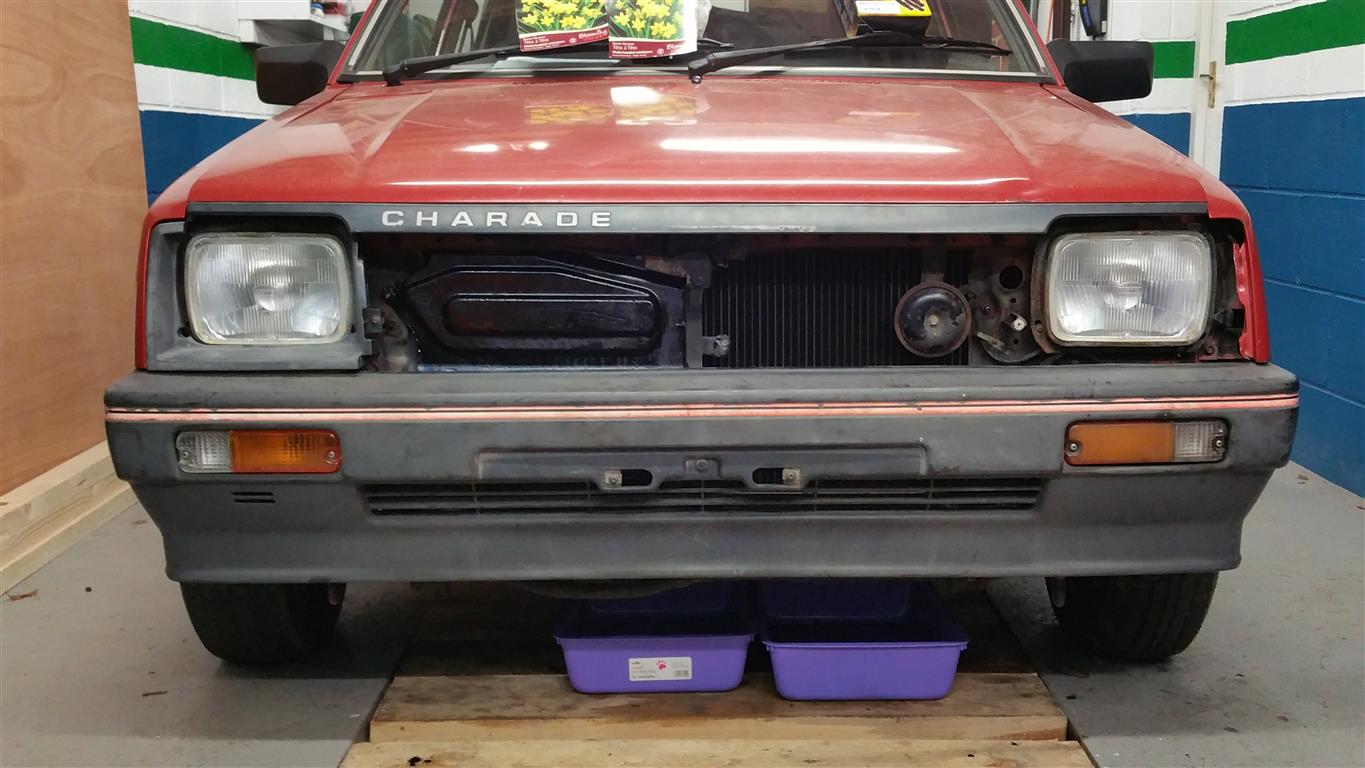

Since the last update, Christmas and general winter weather has sucked up any time or inclination to work on the Charade. The pre-MoT jobs list had been whittled down to two items;
Fit clip to rubber boot on driveshaft
Find out why the cat litter tray was filling up with coolant.
Job number one included a trip to Frost's Restoration Products near Warrington (much more convenient when they were in Rochdale!) for a couple of clips and the tool to tighten, fasten and cut them. The exhaust restricted access to the rubber boot a little, but there was still enough room to get the tool in. It's a pretty nifty piece of kit - once you've wrapped the band around, you feed it through a spindle and can then tighten it up by turning the spindle, fold it back on itself and then use the built in cutter. Hammer down the two tabs provided and the clip is on and tight!
Job number two didn't go so well. The previously mentioned oil and transmission fluid leaks seem to have been resolved. The oil leak was the gasket for the oil filter attachment - easily sorted with a new gasket. The ATF leak seems to have sorted itself out - opinion seems to be there was too much ATF in the box and its now found its own level. The oil leaks had been replaced by a steady drip of coolant - traced to where a coolant hose sits on a stub on the inlet manifold. Tightening the jubilee clip saw the leak increase (never a good sign) so off came the hose - which brought the rotten stub out of the manifold. I'm used to these stubs being a tight push fit in to the manifold - but not so on the Charade. It's a push-fit into a threaded insert with a 22mm head (which the stud attaches to).
The challenge now is to undo the threaded bit and take it to the place that re-cored the radiator and get them to build a new stub on to it.
If ever there was a poster car for changing your coolant more than once every 20 years then this is it! (well, a poster car for doing any sort of maintenance ever, really)
