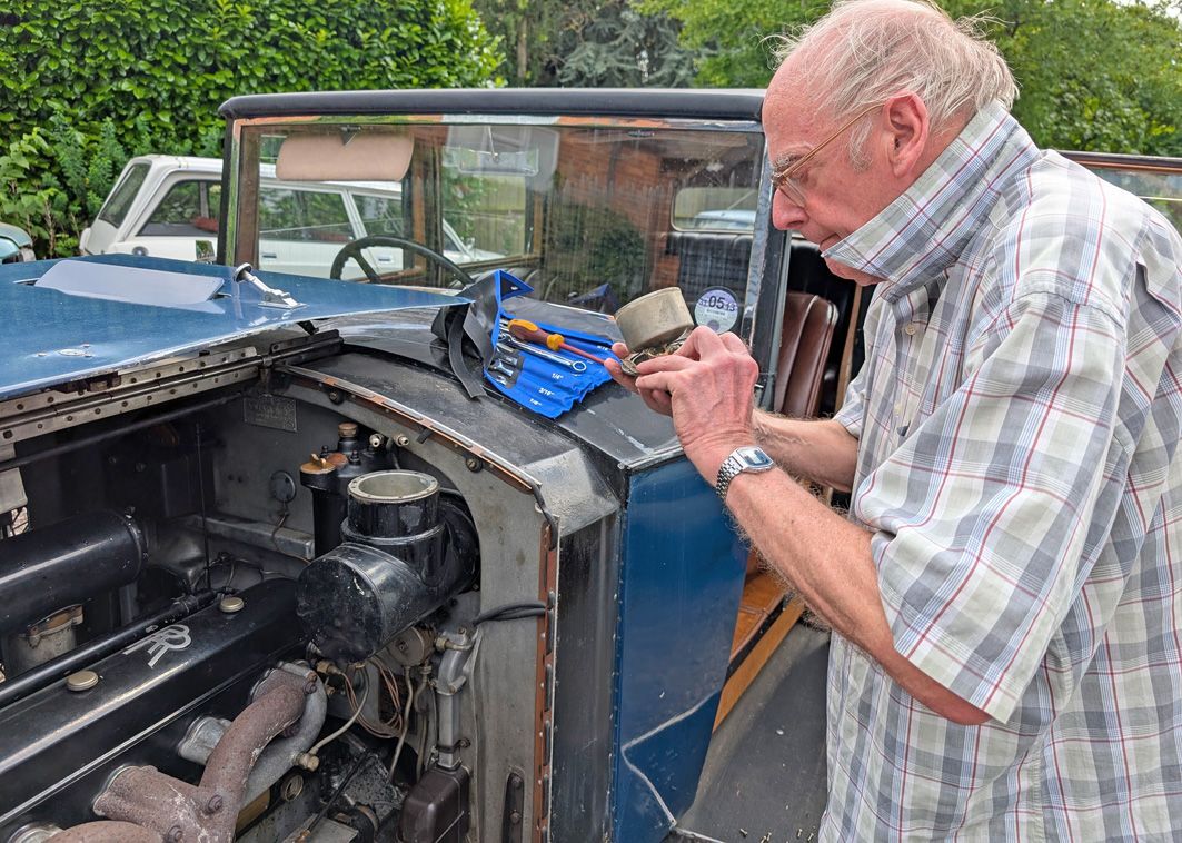

The Rolls Royce has a vacuum fuel pump on the bulkhead with a reservoir that gravity feeds the carburettor. As the car turns over it was lack of spark or lack of fuel. As it coughed a couple time Slowsilver bet on fuel so we took the top off the pump/ feeder tank to reveal it was dry. We put a couple of litres of petrol in the header tank and the car started instantly. Why was it dry, I don’t know it had only stood for 5 days when the problem occurred and the car has stood for weeks and still had petrol in the header tank.

Just been so absurdly hot that the fuel has evaporated from the header tank on the Rolls maybe?  Especially with how much more volatile modern fuels are.
