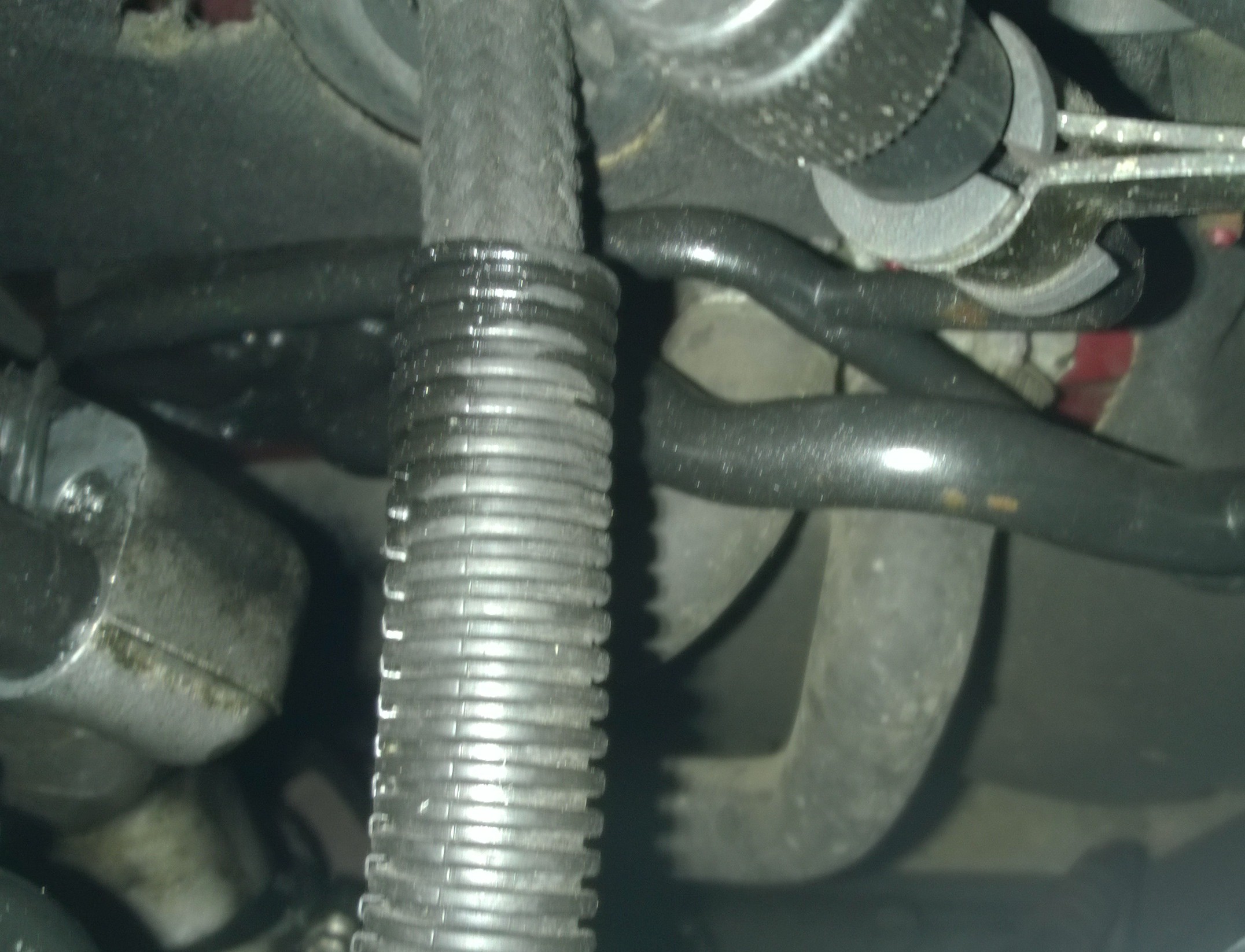

Will have another crack tomorrow then. Nothing on thermostat housing, couldn't see any on heater hoses going through fire wall.

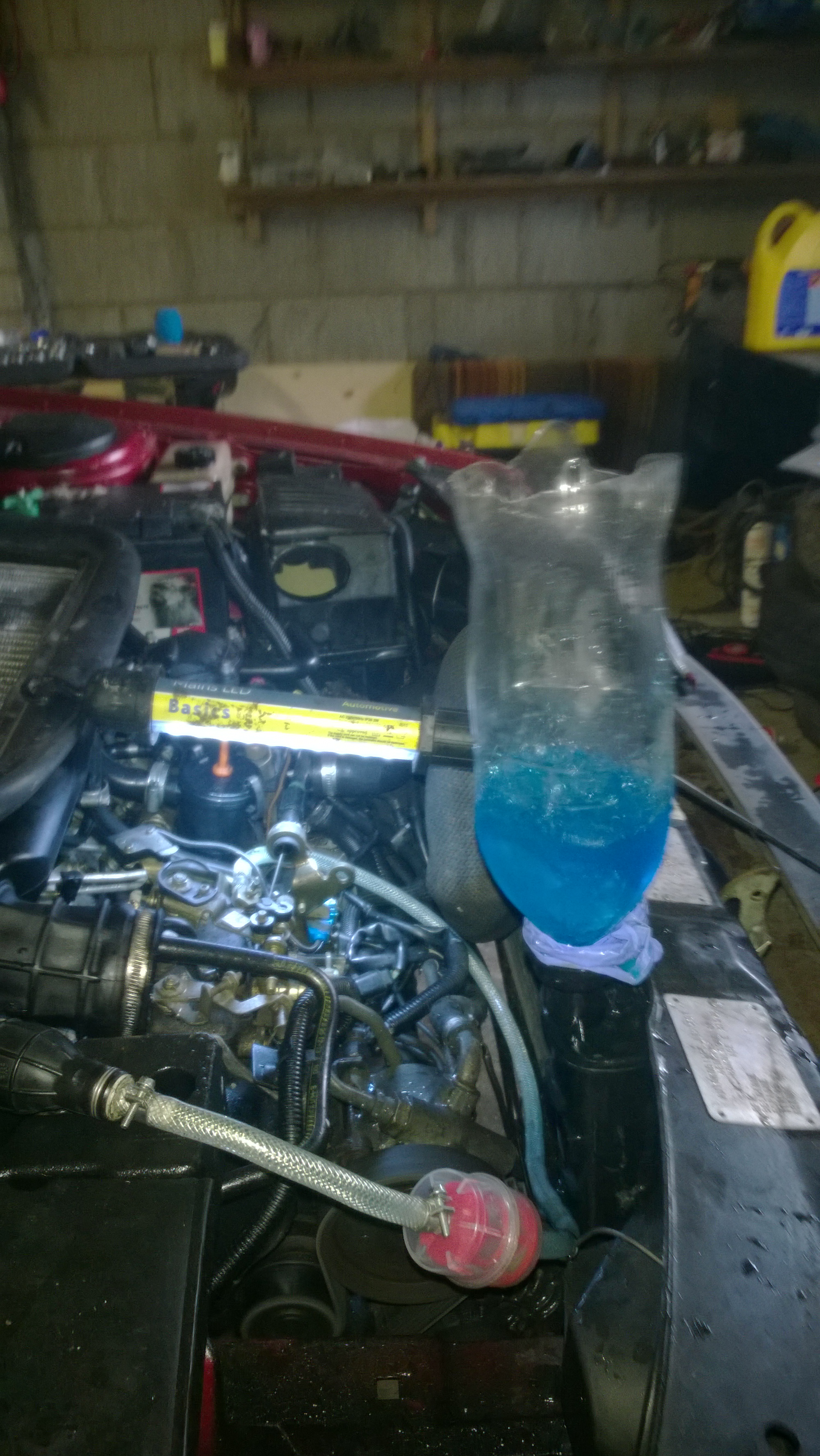

Coke bottle didn't work as it wouldn't fit properly and also there is a mall hole in side of expansion bottle. Tried a funnel and that didn't work either.
Really annoying as should be simple job
Did you 'burp' the coolant pipes? I've successfully bled blown XUDs in BXs by doing nothing more than parking it on a slope, so the expansion bottle is high up, then squeezing all of the pipes and giving the engine the odd rev.
Yep tried that.
On 405 expansion is on the side of the radiator which is lower than the thermostat which is what causes the issues.
Pretty similar to the non-turbo BXs then. Should still follow that if you can tilt the car enough, the expansion tank will still be higher than the stat (assuming the expansion tank is on the offside) and (in theory) the air fill find its way out.
Deffo park nose up hill . Usually a bleeder on the top of the rad at the opposite end to the filler . Then an Allen bolt on the thermostat housing and usually a plastic disc headed bolt thingy on one or both of the heater pipes

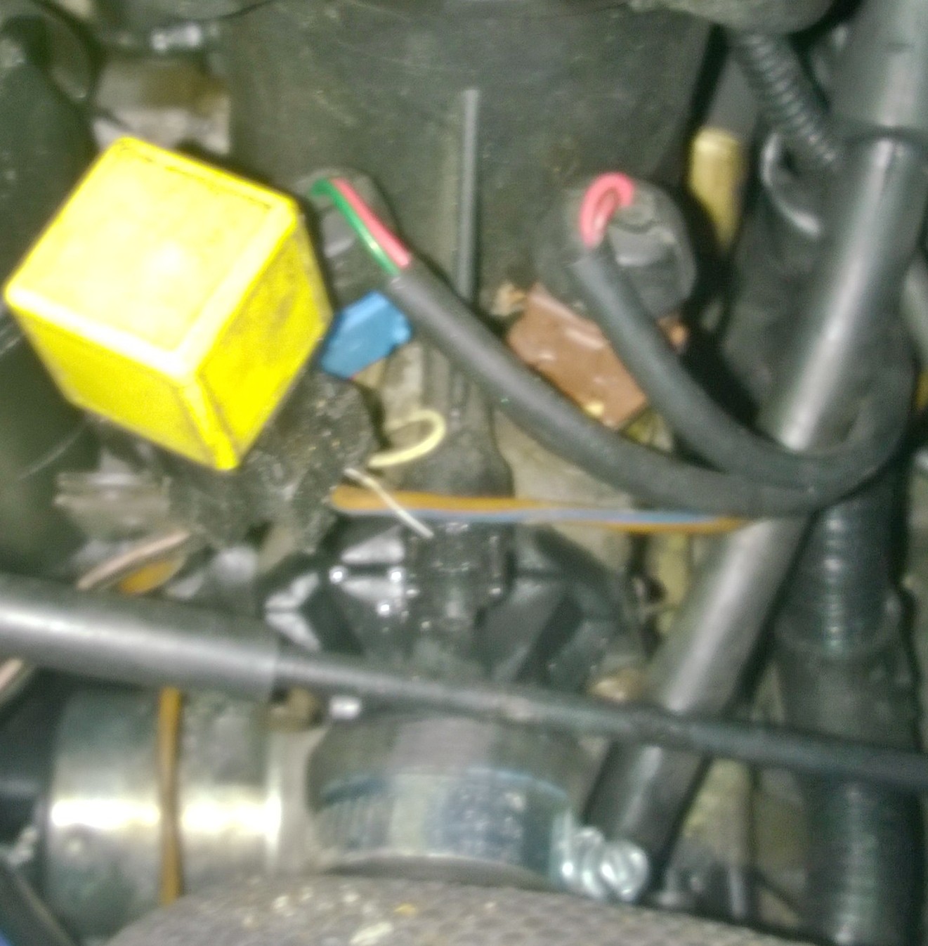

Right had another look and cant find a bleed valve

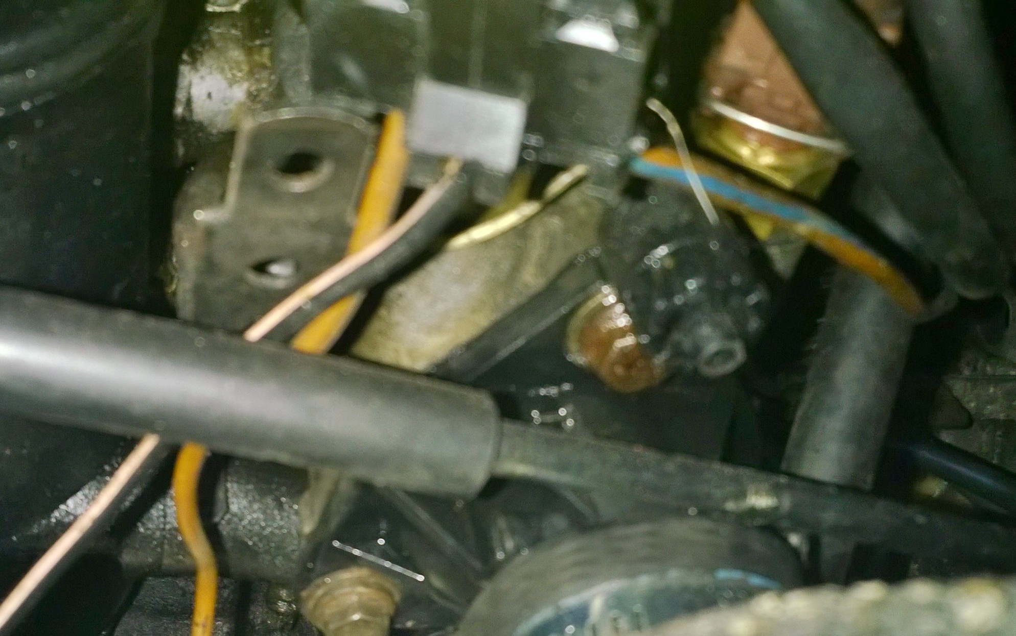

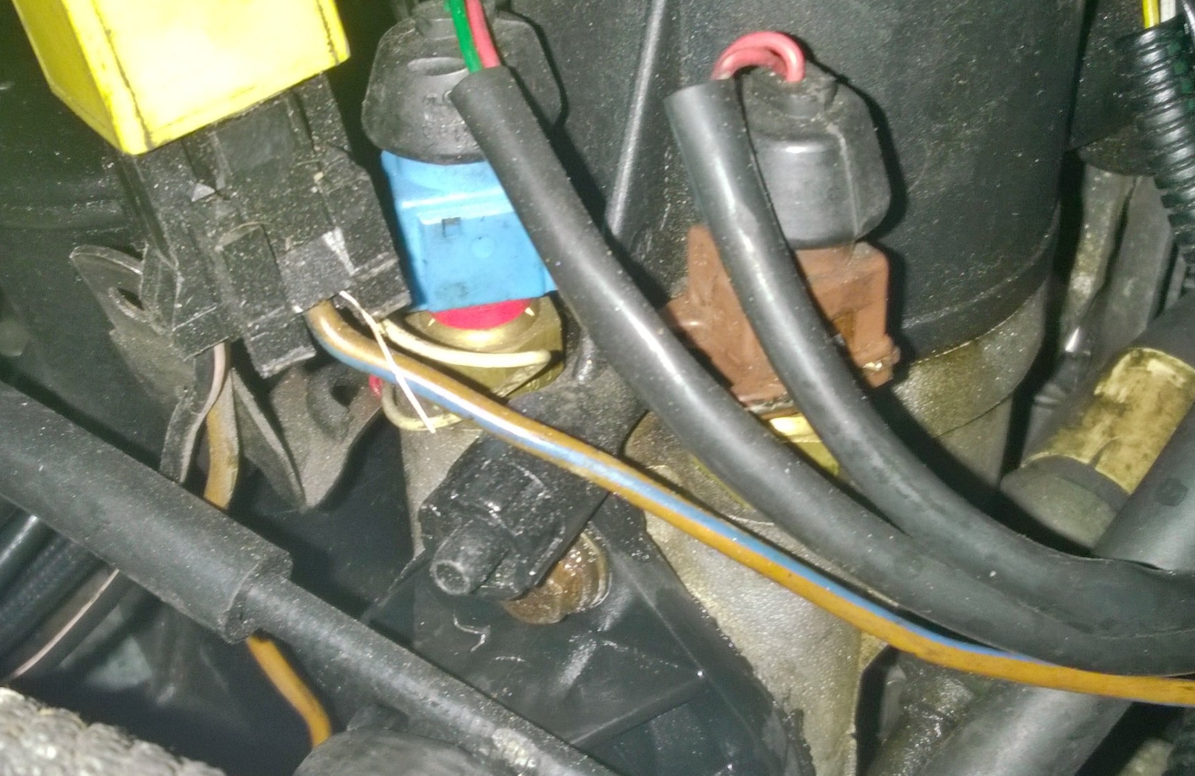

On thermostat housing I cant see any bleed screw. It has two sensors at front.

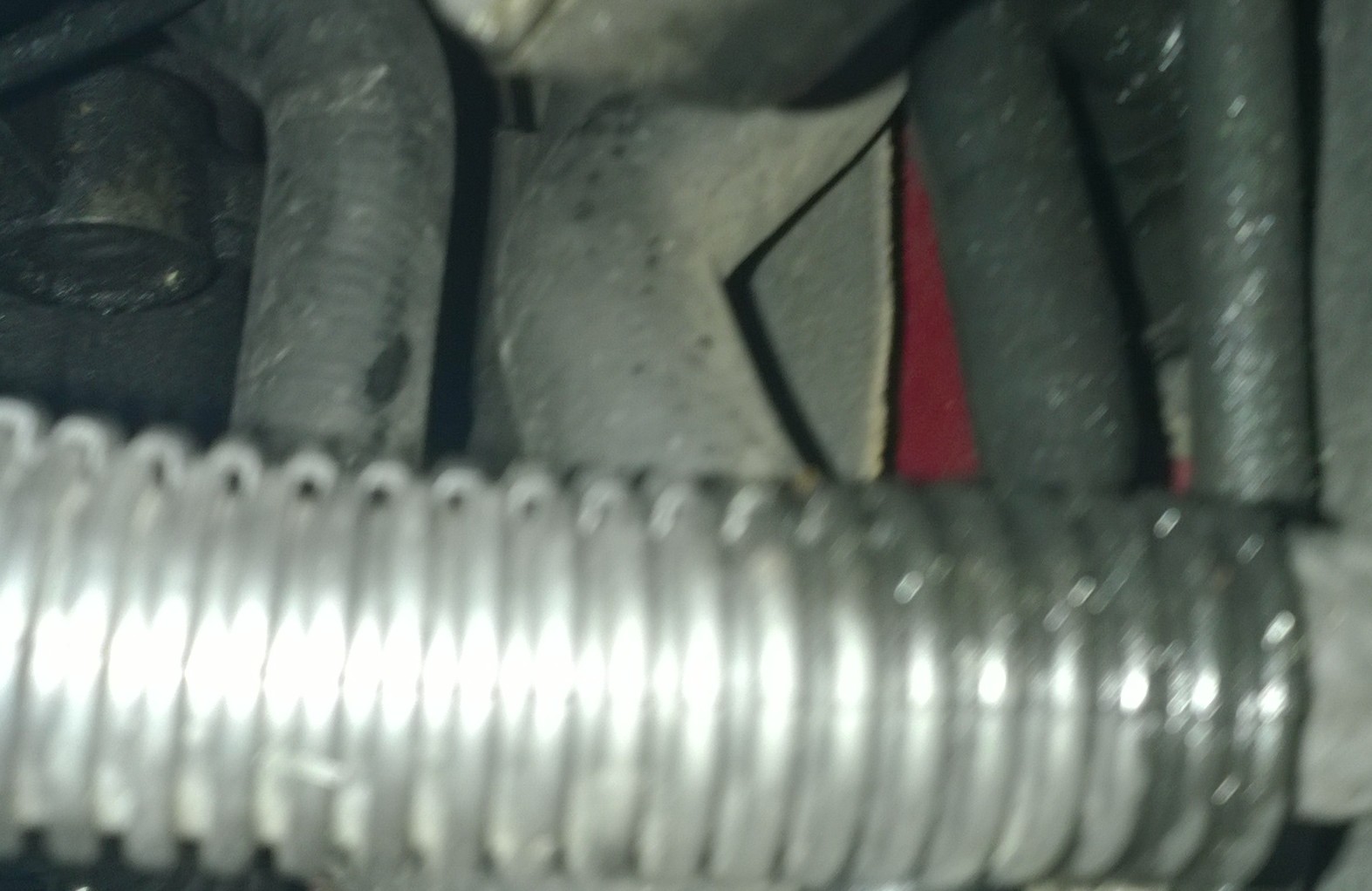

On heater hoses going through fire wall no bleed valves, followed the hoses along back to engine block and nothing obvious along there.
Am I missing anything obvious?
Does the heater pipe have anything teed into it that goes up the bulkhead with a valve on the end?
Nope. One hose goes parallel to engine then back to block and the other drops down and goes into a metal pipe. Both of them have less nipples than action man

Ok had sometime this morning so drained coolant and tried to look for bleed points. Still cant find any.

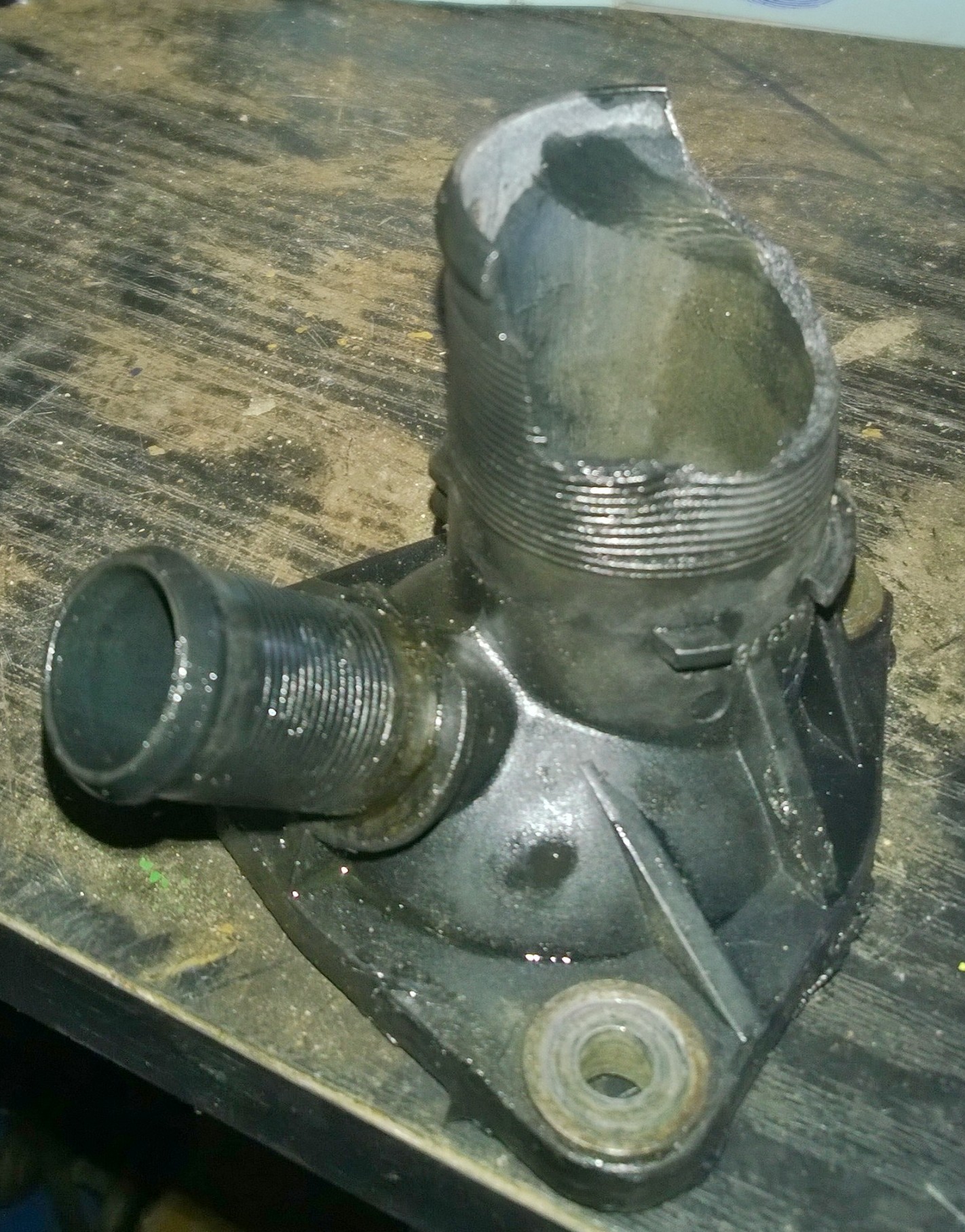

But when removing the hoses I noticed some of the plastic has disintegrated on thermostat housing. Also couple of clips aren't in a good state.

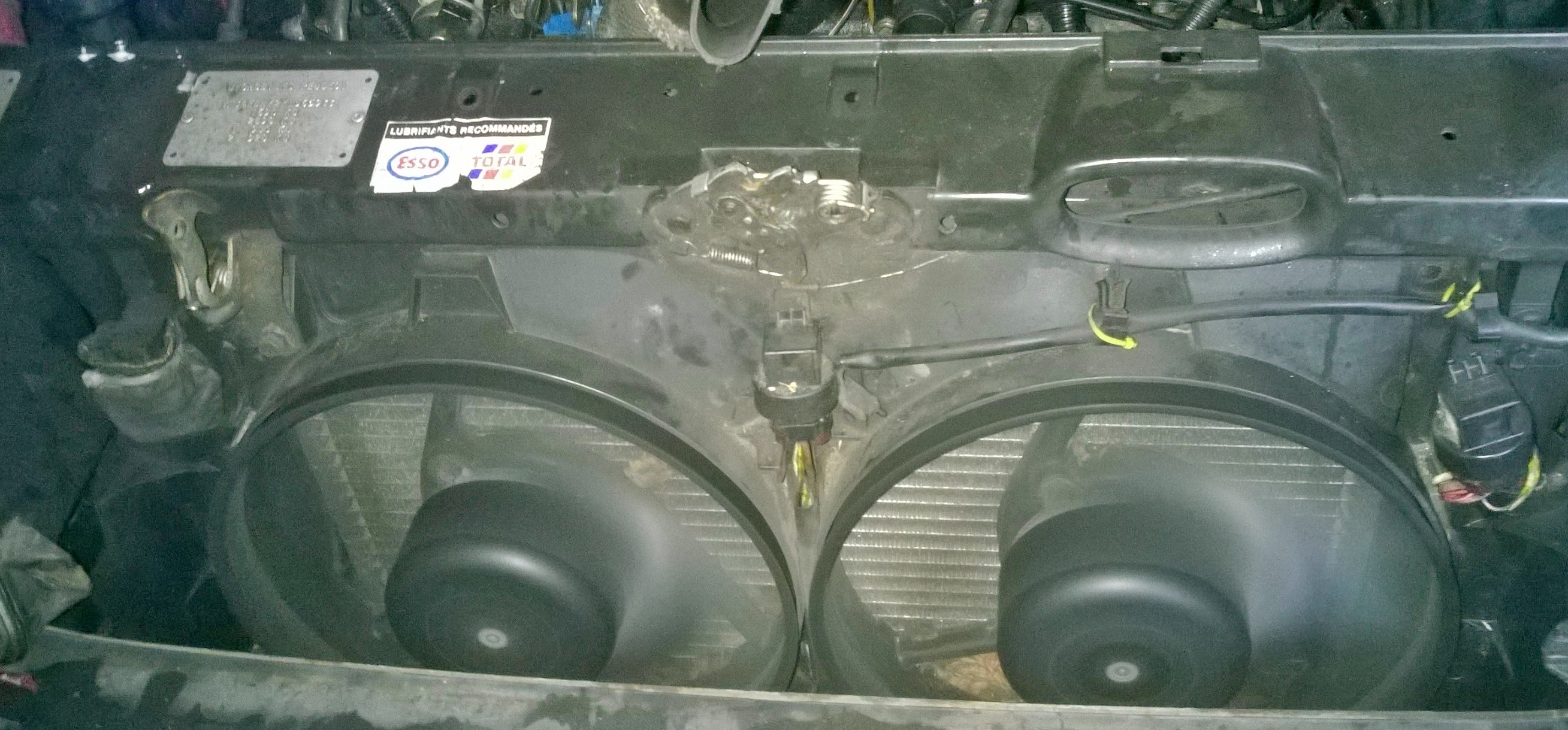

Poking some more I checked the front cooling fans and they aren't working! They should run when AC is on. Whoever put the relays in from of the radiator needs to have nettles rubbed in delicate places.

Decided not to be beaten, so replaced the thermostat housing and bled the system. I spent about an hour squeezing hoses getting loads of bubbles out.
Then the fans kicked in, so they do work but not on low setting and AC probably needs a recharge.
I think that it just runs hotter than the last one. Thermostat opens at 87, fans kick in around 100 and normally sits about 90 ish.
