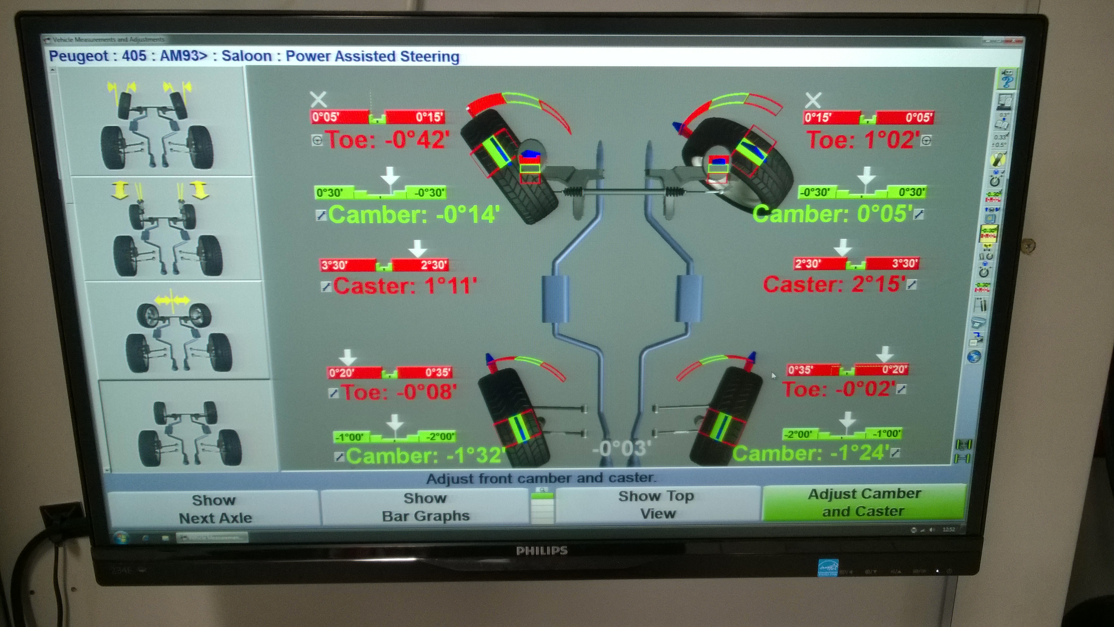

The Moog Posted December 18, 2014 Author Posted December 18, 2014 I changed the track rod ends myself then took it to kwikfit. They had a new funky monitor in the weighting room which showed you the tracking settings, these are before settings, so definitely set up right. Dropped it off to get bushes and ball joint done today
Junkman Posted December 18, 2014 Posted December 18, 2014 Steering and handling should be razor sharp with these, all of mine were/are exemplary in this respect. Front:Camber 0° +-30'Caster +3°10' +-30' Est. +2°25' +-30'King pin inclination +11°25' +-30'Toe in +1.0mm +-0.5mm Rear:Camber -1°20' +-30'Toe in +2.5mm +-0.8mm Note that the rear axle needs considerable toe in, whereas yours has toe out.That alone could be the reason for the symptoms you describe.Do you have the values from after the adjustment? Anyway, fitting new bushes and ball joints will alter the settings again, so I'd have it completely checked once more.Instead of that McQuickfuck, could you not take it to a local non-chain tyre fitter and get it checked?
