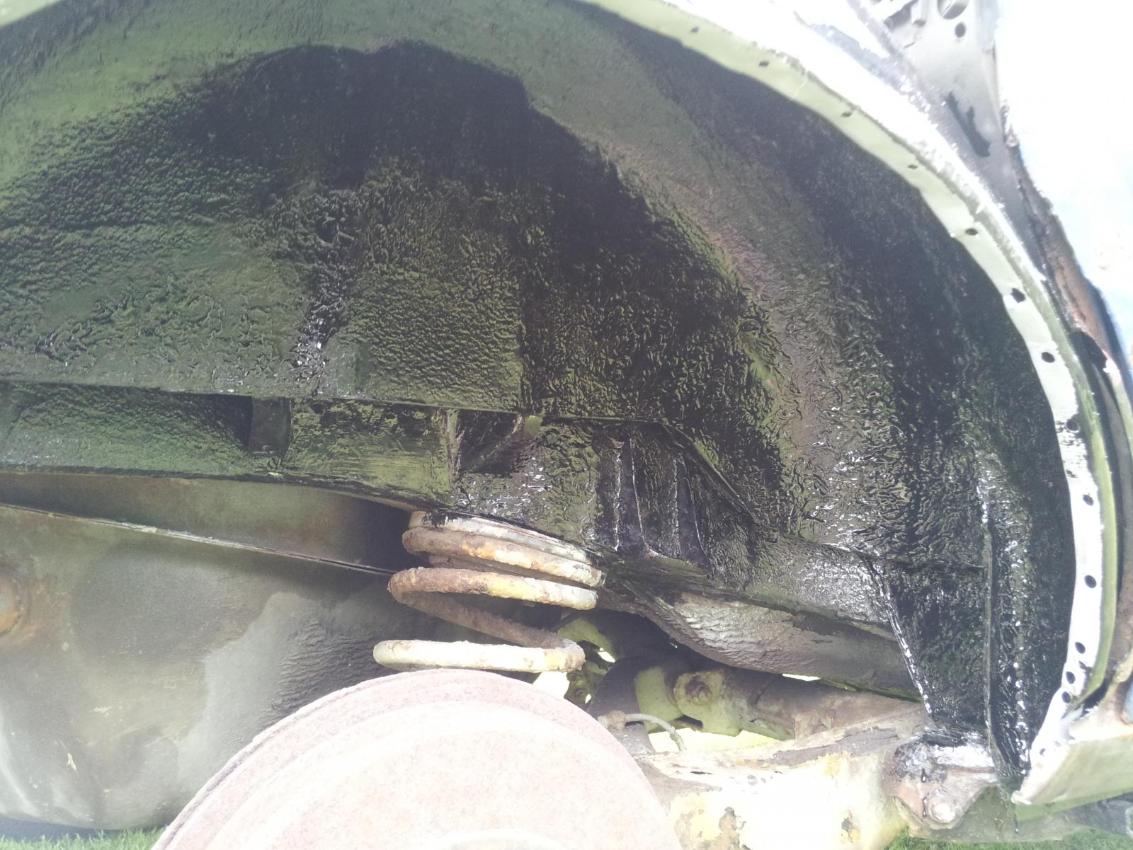

Simcat Posted August 15, 2015 Posted August 15, 2015 SambaS will be pointing the Express Talisman south in a couple of weeks for a return visit to Talbot Rehab. The Express is booked in for an out patient appointment, but the main cause for the visit is to further progress the Alpine LE, which remains in intensive care, but is no longer on the danger list. In advance of it's owner's visit, further reconstructive surgery has been carried out..... (as a refresher jump back to p14 to see how things were left in June)

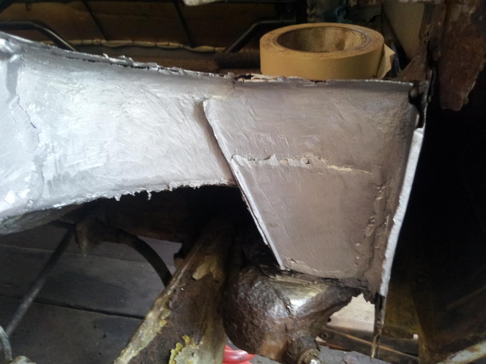

Simcat Posted August 15, 2015 Posted August 15, 2015 The crusty bump stop bracket has been cleaned up and welded back to new metal in chassis rail side. danthecapriman, steve_earwig, Semi-C and 2 others 5
Simcat Posted August 15, 2015 Posted August 15, 2015 Sill end closure panel made up. Whilst there was access for some WD40, we ensured that the bolts that screw into captive nuts holding the axle beam on undid from underneath, as at a later date the very scabby beam and suspension arms will likely get replaced with better used. These bolts can either shear off, or the captive nuts spin - the only remedy being to chop a hole to access! steve_earwig, danthecapriman and SambaS 3

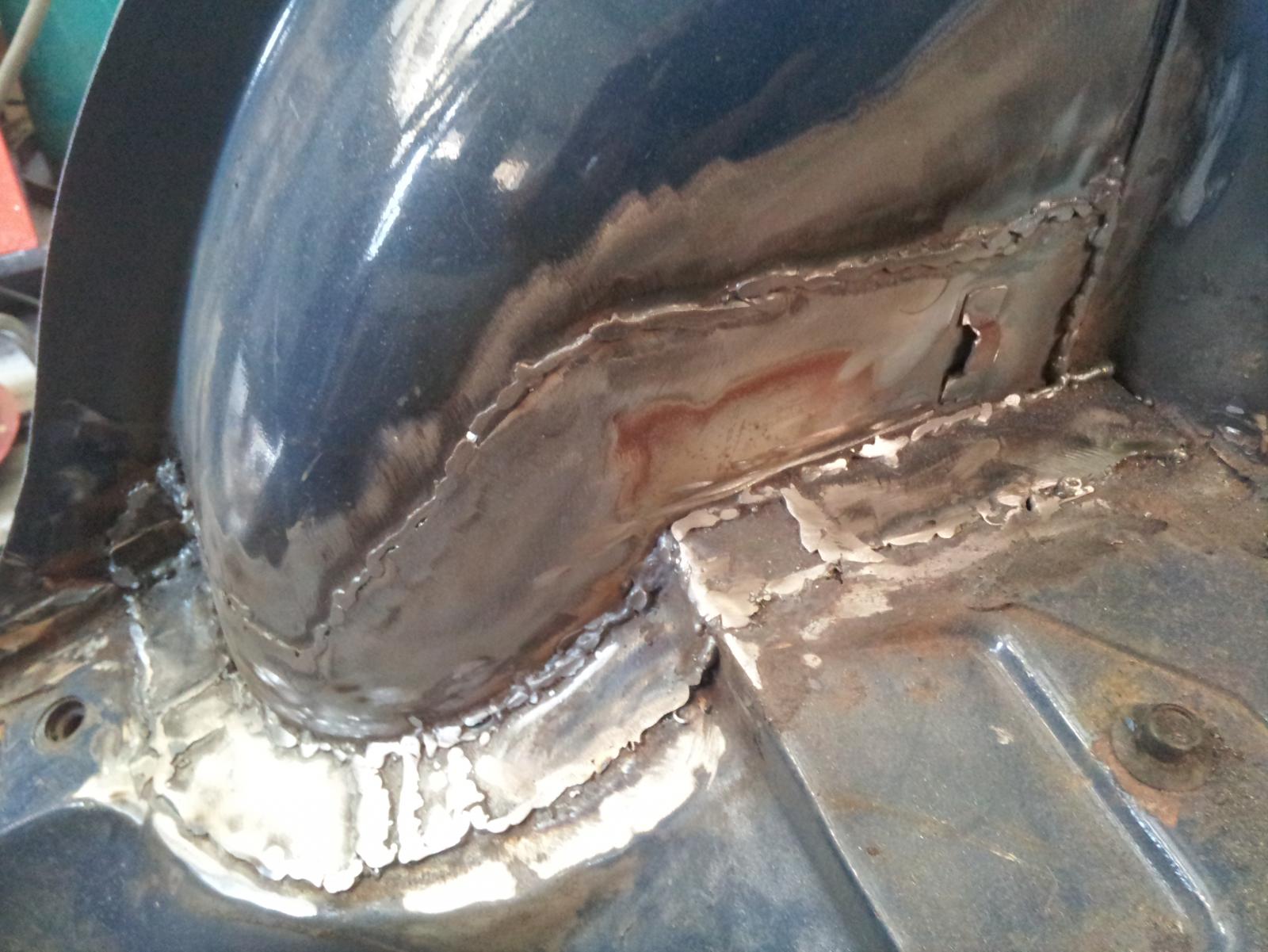

Simcat Posted August 16, 2015 Posted August 16, 2015 Outer half of wheelhouse welded in. The inner and outer have two factory alignment holes, so they can be bolted together to get everything perfectly in place prior to welding. Asimo, mouseflakes, Cavcraft and 7 others 10
Simcat Posted August 16, 2015 Posted August 16, 2015 After some final seam sealing, inner arch painted with smoothrite. Once outer quarter is on and painted everything will be waxoyled underneath. Solid at last - well this corner at least! worldofceri, RayMK, mat_the_cat and 15 others 18

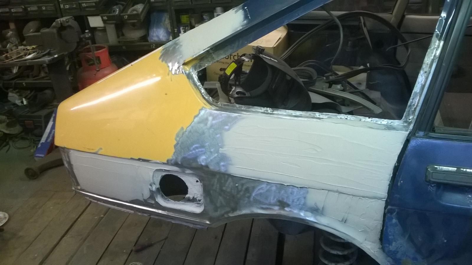

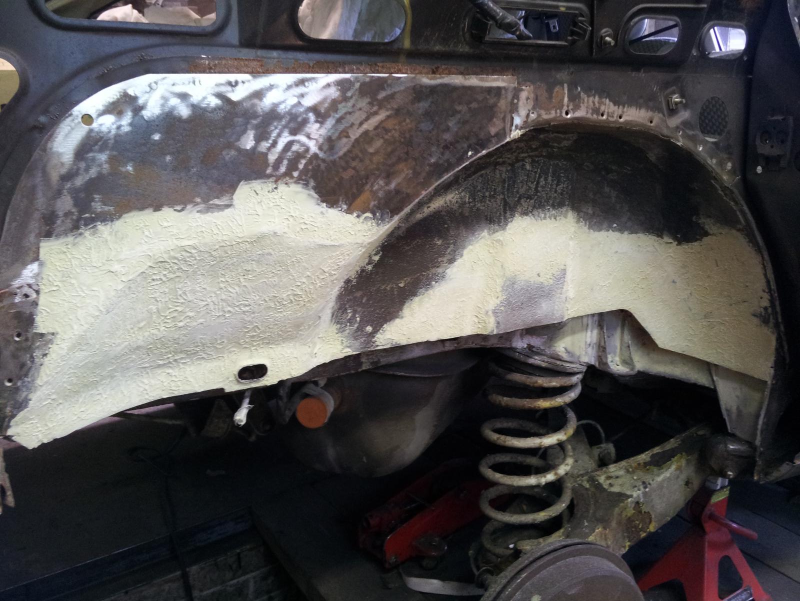

AlabamaShrimp Posted August 16, 2015 Posted August 16, 2015 On 16/08/2015 at 20:16, Simcat said: Some blending over the welds prior to paint.I can't say how amazing the work is you've done so far if I could do a quarter I'd think I was doing a good job. One thing though why has your filler got that the ripple/bumpyness to it? Is it on purpose or have you coated it in something?
Simcat Posted August 16, 2015 Posted August 16, 2015 On 16/08/2015 at 21:49, AlabamaShrimp said: I can't say how amazing the work is you've done so far if I could do a quarter I'd think I was doing a good job. One thing though why has your filler got that the ripple/bumpyness to it? Is it on purpose or have you coated it in something? The factory sealant has quite a rough texture so I 'stipple' the filler to blend in, it works well. First coat is roughly rubbed down to smooth the welds, then a thin skim is applied and just using finger tips dab the surface to create the effect. Any sharp points then just nibbed off once set.

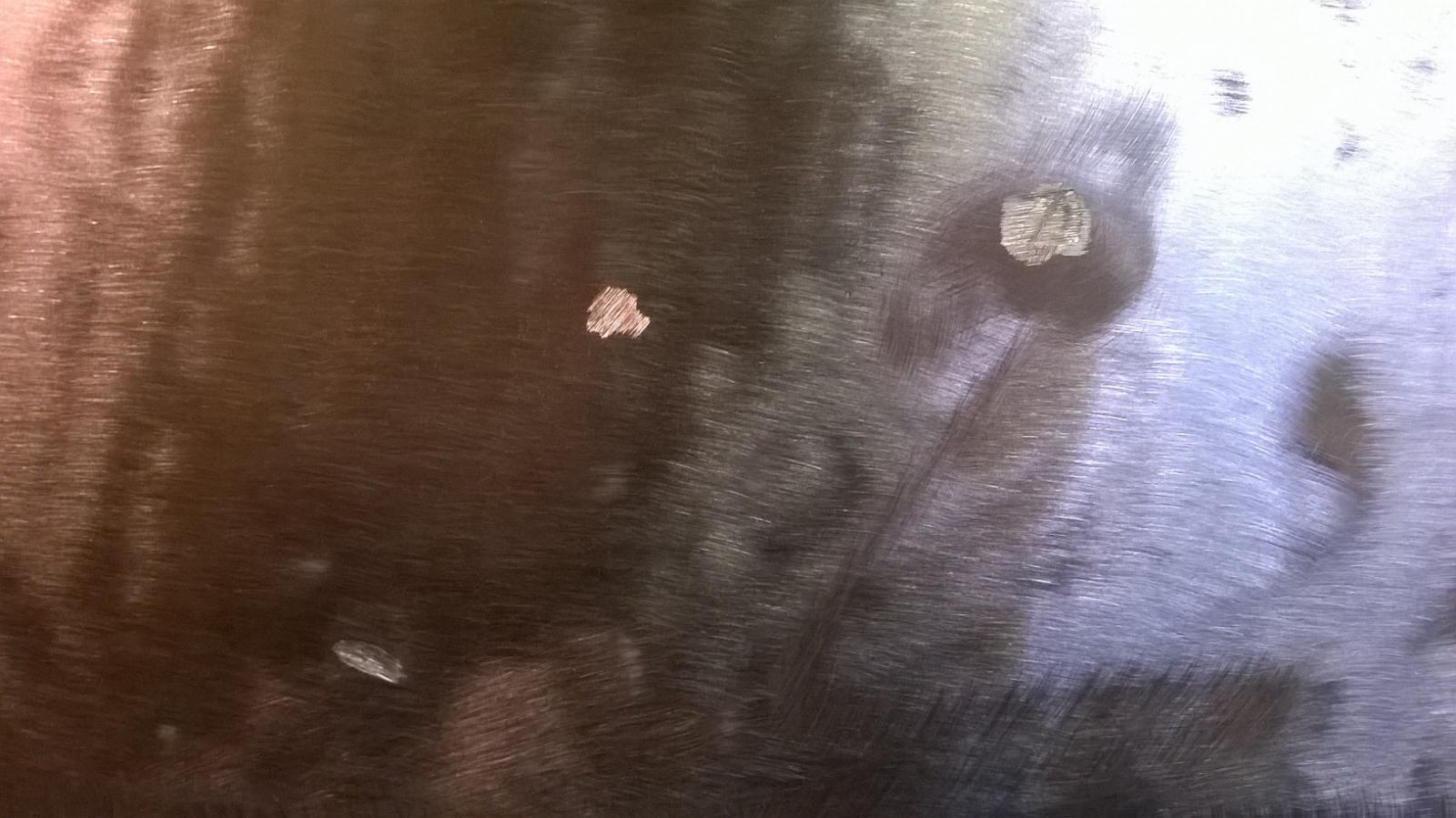

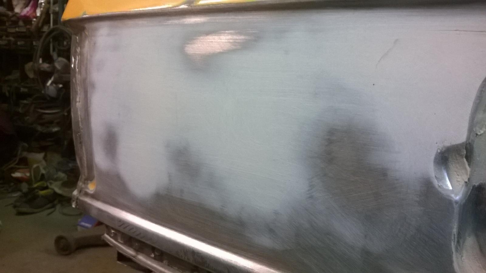

Simcat Posted August 31, 2015 Posted August 31, 2015 Talisman landed 2am Saturday morning.. Some photos from SambaS and Simcat: Half a day spent tweaking and aligning And then the welding starts More welding This is a picture of a Frost product called Cold Front. It aims to reduce any distortion in flat panels caused by the heat transfer when welding. Worked well! After a day of welding. On. Then we went OCD ! See this rust pitting? Yeah we got rid of that, we all know how those door scabs started !! Three of them. Gone. No products, just ground out. And then the prep for a mirror finish starts And continues... this takes ages! That's three days gone, bit more to do tomorrow ! Skizzer, Jim Bergerac, danthecapriman and 20 others 23
