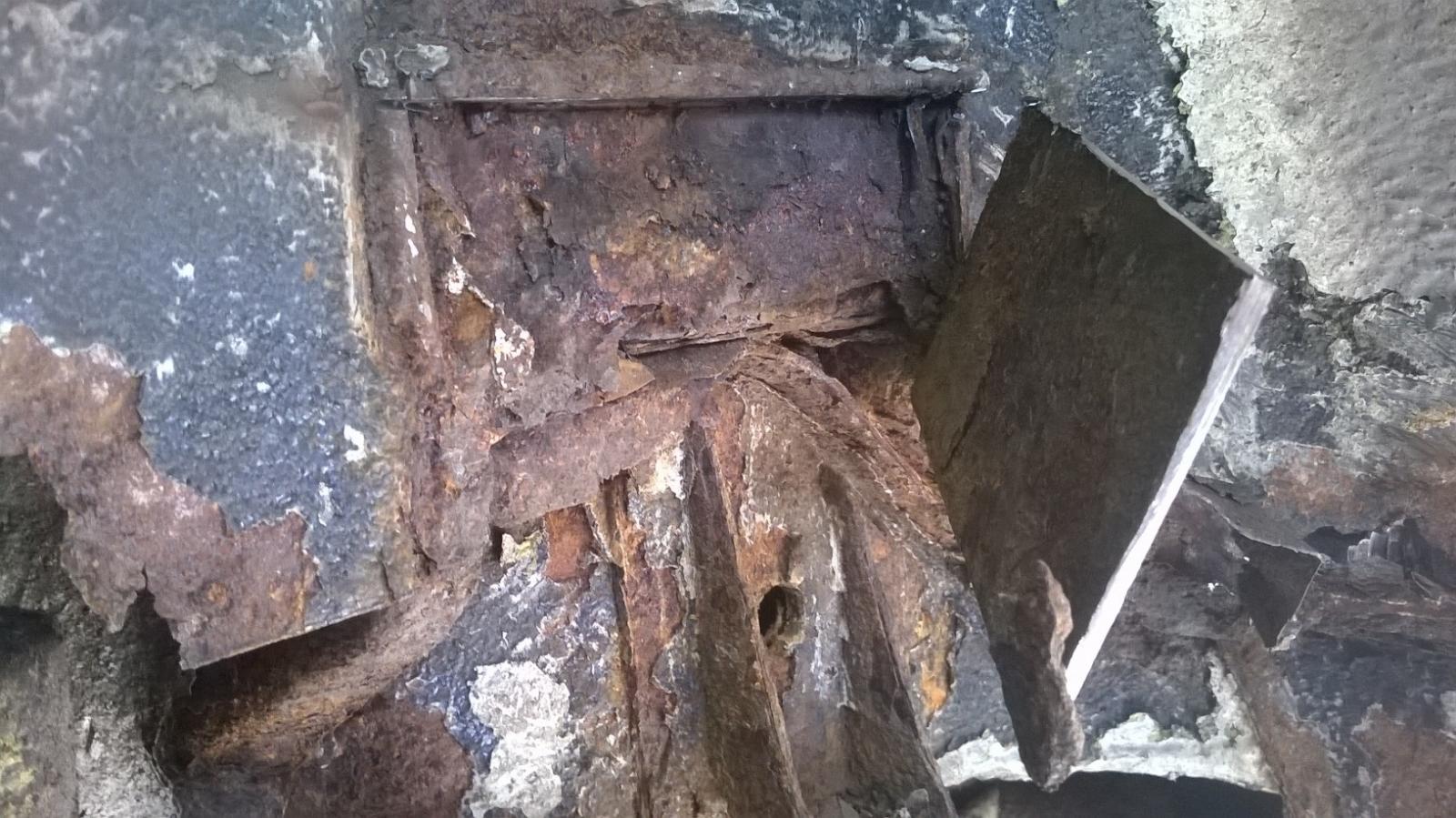

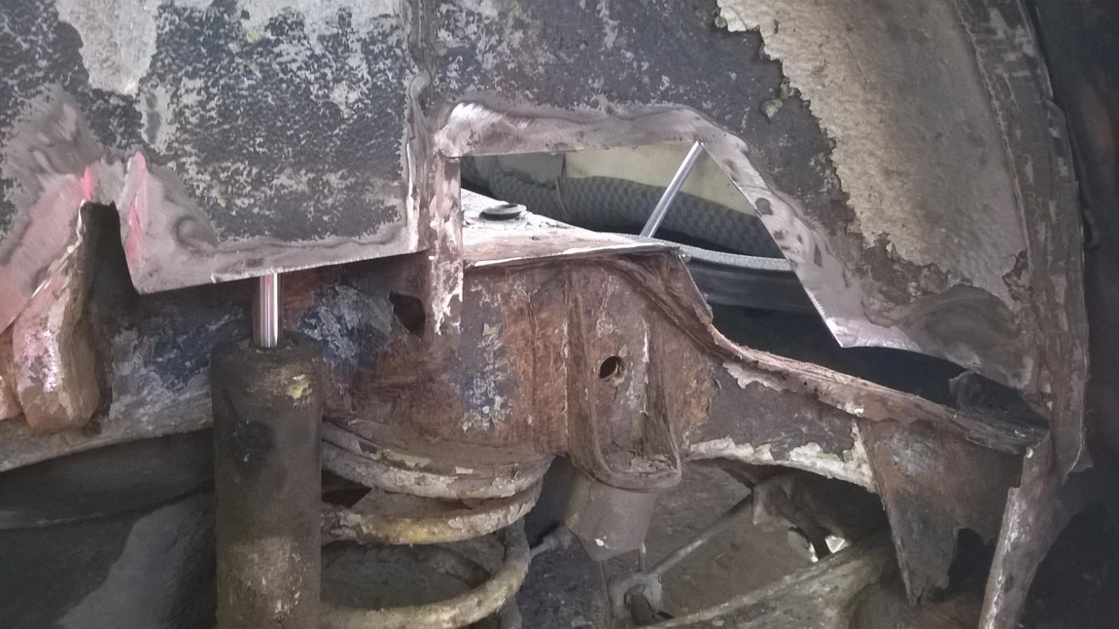

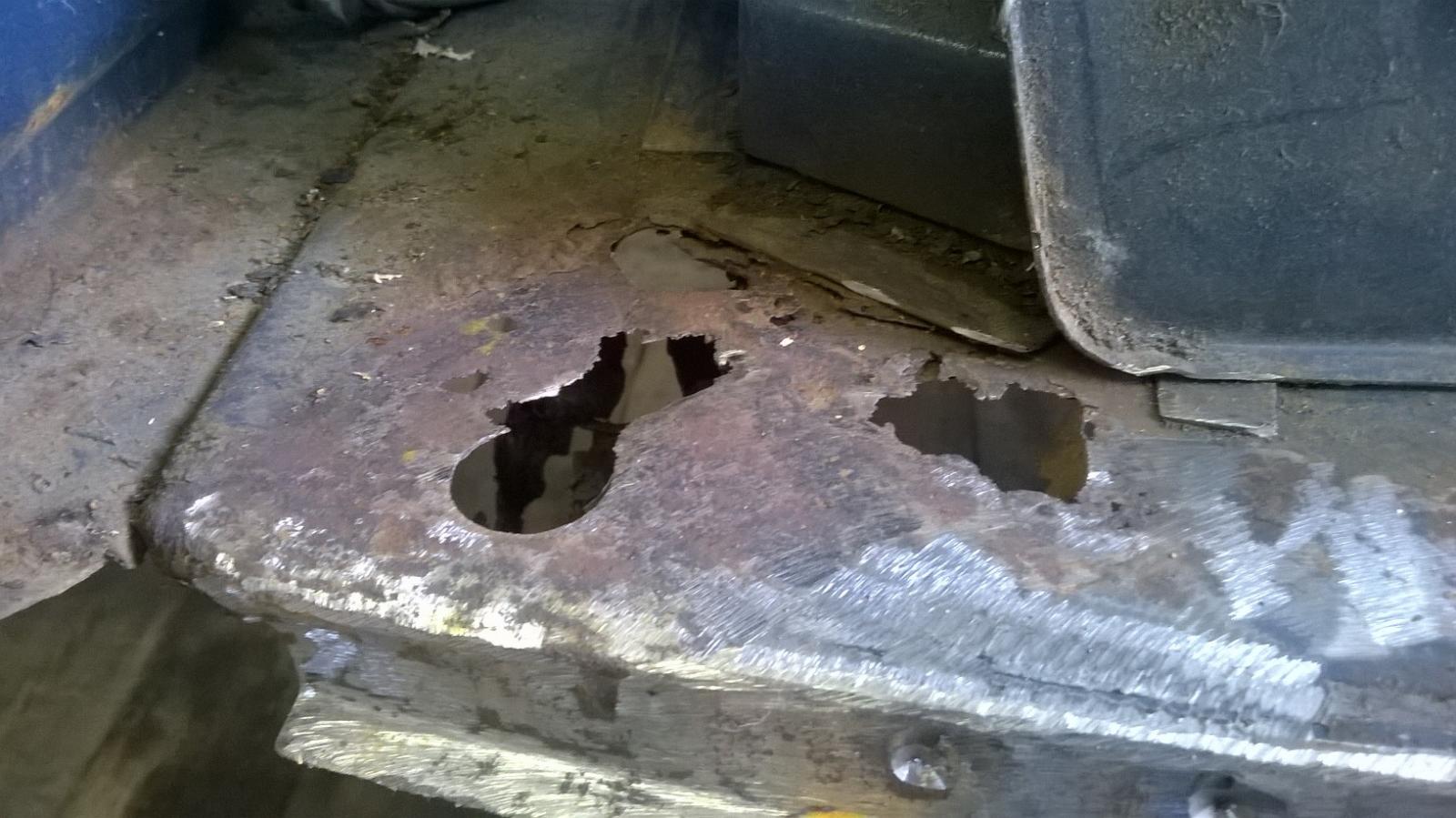

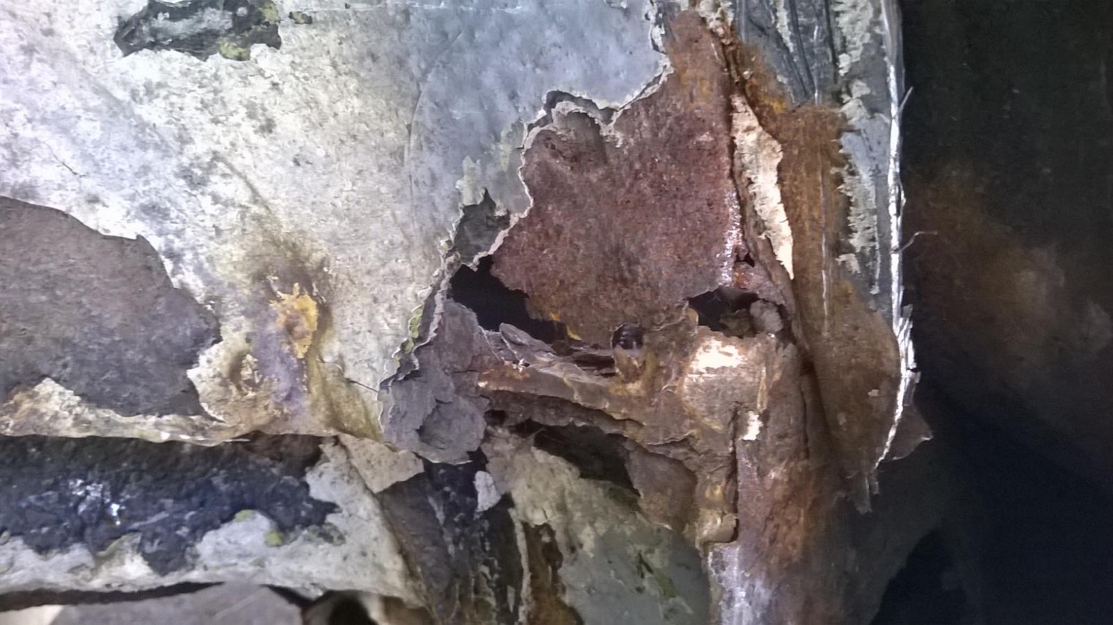

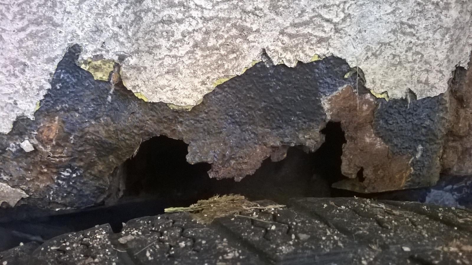

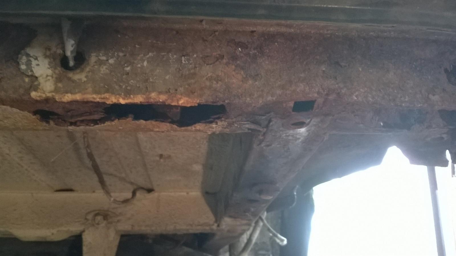

SambaS Posted June 22, 2015 Author Posted June 22, 2015 So four days down in Talbot rehab... Never straightforward with this car. The plan was to put the new quarter on and paint in the four days but we found so much extra rot that had to be addressed that the quarter remains off, the inner tub remains off, and the majority of repair sections made up or cut out of a donar car are still to be welded on. Here are the extra curricular bits.. similar story to the work I did on the passenger side. Have to thank Simcat for all this work, I'm down here to learn the black arts. Rear corner of boot floor, where rear crossmember attaches. Section of inner wheel arch Further along inner wheel arch Very corner (front) of inner wheel arch Inner sill bracing panel Back side of inner boot panel / window lip More window lip to rear of rear door pillar An old MOT repair plate straight over the original rot, that I suppose served it's purpose

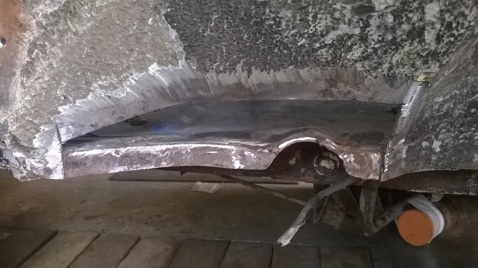

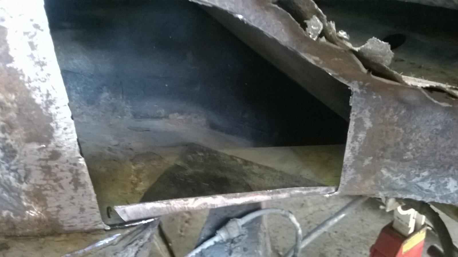

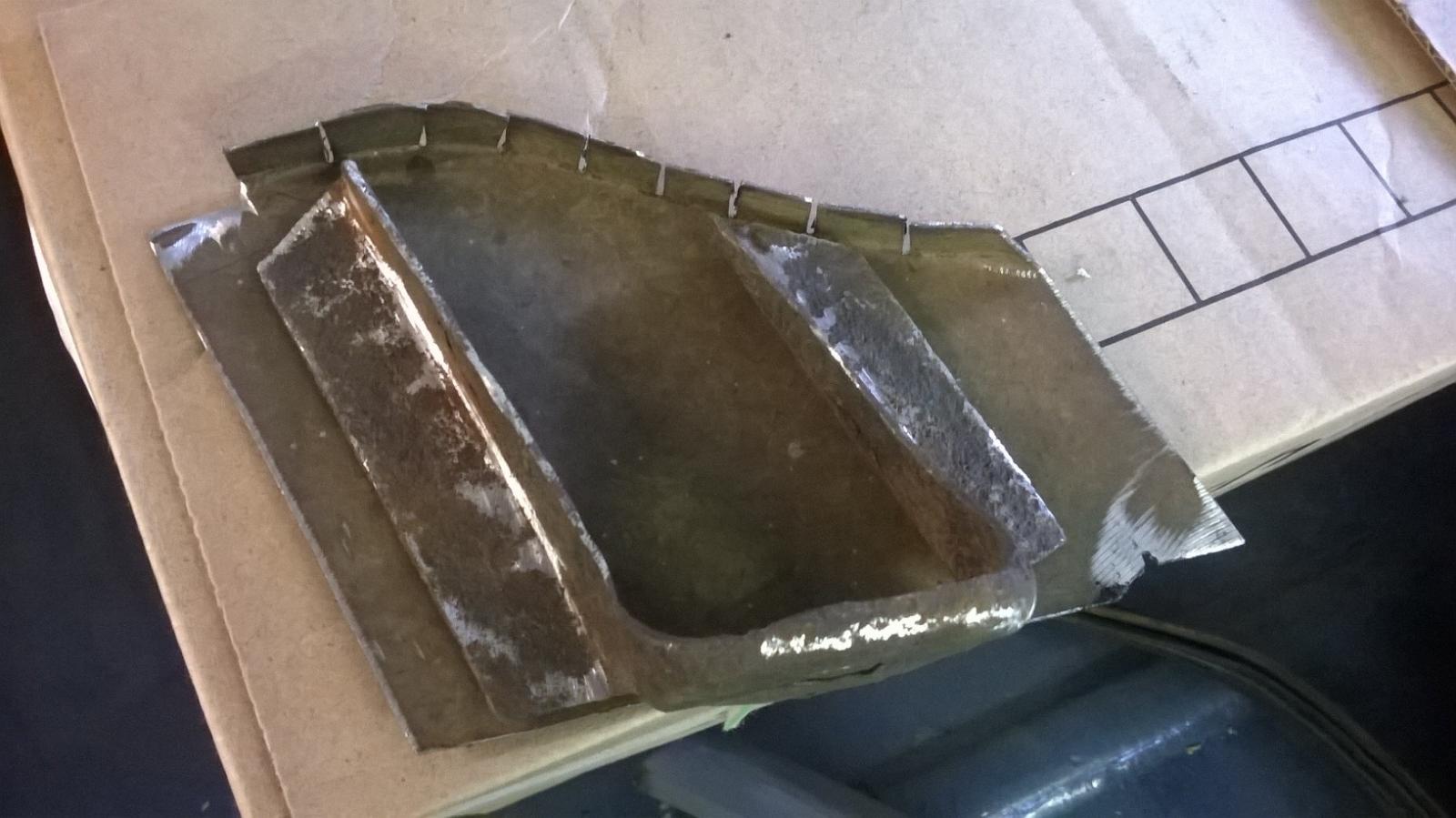

SambaS Posted June 22, 2015 Author Posted June 22, 2015 Inner wheel arch area cleaned up a bit! You can't even see any trouble behind the bump stop bracket until Stu stated cleaning up the pack rust from it between it and the chassis rail, pushing the two apart. MOAR! Rear crossmember.. this has both sustained a bit of an impact in the past, bending the bumper brackets and bumper out of shape, and also the crossmember itself.. which is rotten yay Crossmember chopped out.. looks straighforward in pictures. Wasn't. The bump stop bracket had rot behind it in the chassis rail so had to come off in order to repair the chassis behind... will it ever end? A new bit of metal ready to go in the rear chassis rail Tacked internally, seamed externally and sealed afterwards Repair section fabricated for chassis rail behind bump stop bracket, bump stop bracket cleaned up ready to refit. M'coli, Skizzer, Grundig and 4 others 7

Simcat Posted June 23, 2015 Posted June 23, 2015 We could have resisted prodding some of the suspect areas, especially around the bump stop mount, and integrity would probably have lasted another couple of years or so, but, with the quarter and outer wheelhouse removed, access is relatively easy, so it made sense to fix properly. Talbotman, Coprolalia, SambaS and 1 other 4

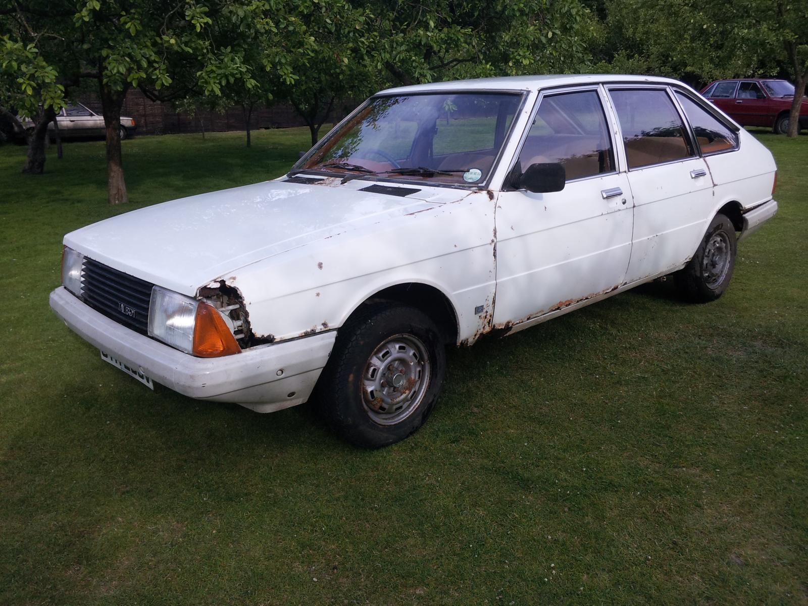

Simcat Posted June 25, 2015 Posted June 25, 2015 As it's already made an appearance on this thread, here are a couple more pics of the equally sorry white Alpine, currently keeping the LE company at Talbot rehab. A sorry pair they may be, but for both the only way now is up. After 24 years festering in a collapsing garage, this base model LS was hauled off for scrap, but cunningly managed it save itself from the infamous oval by making sure it's clutch slave cylinder stuck out. Thus thwarting all motion. Plan B involved ebay, and it's fate secured. Talbotman, inconsistant, Skizzer and 4 others 7
Simcat Posted June 25, 2015 Posted June 25, 2015 Some nasty crusty rustiness at the base of the passenger A pillar, due to the leaking garage roof. Talbotman 1
Simcat Posted June 25, 2015 Posted June 25, 2015 A tree was cut down on top of it, smashing the tail gate glass. The tailgate is toast anyway, but there's a dent in in roof that will need sorting. Quick fix for now - replacement glass and duct tape... Talbotman, Skizzer, Angrydicky and 1 other 4
Simcat Posted June 25, 2015 Posted June 25, 2015 Interior was full of rubbish from the collapsed garage, now cleaned up well. It's a 1.3, with 4 speed Simca gearbox, 54k on the clock. So, for now, secured, will be in the dry, and hopefully back on the road in due course. Vince70, Skizzer, Shep Shepherd and 8 others 11

Simcat Posted June 25, 2015 Posted June 25, 2015 I wonder what it would be like if the garage it was stored in wasn't in such a bad state of repair? Pretty much rust-free I imagine. There's filler in the front wings and tailgate, and a 'repair' to the bottom of the driver's door, probably done when the car was 8-10 years old, but yes most of the rot occurred when in the garage, or more likely shack - judging by the amount of compost we had to remove off the front before trailering down the M6! Shep Shepherd, Vince70, Angrydicky and 3 others 6
