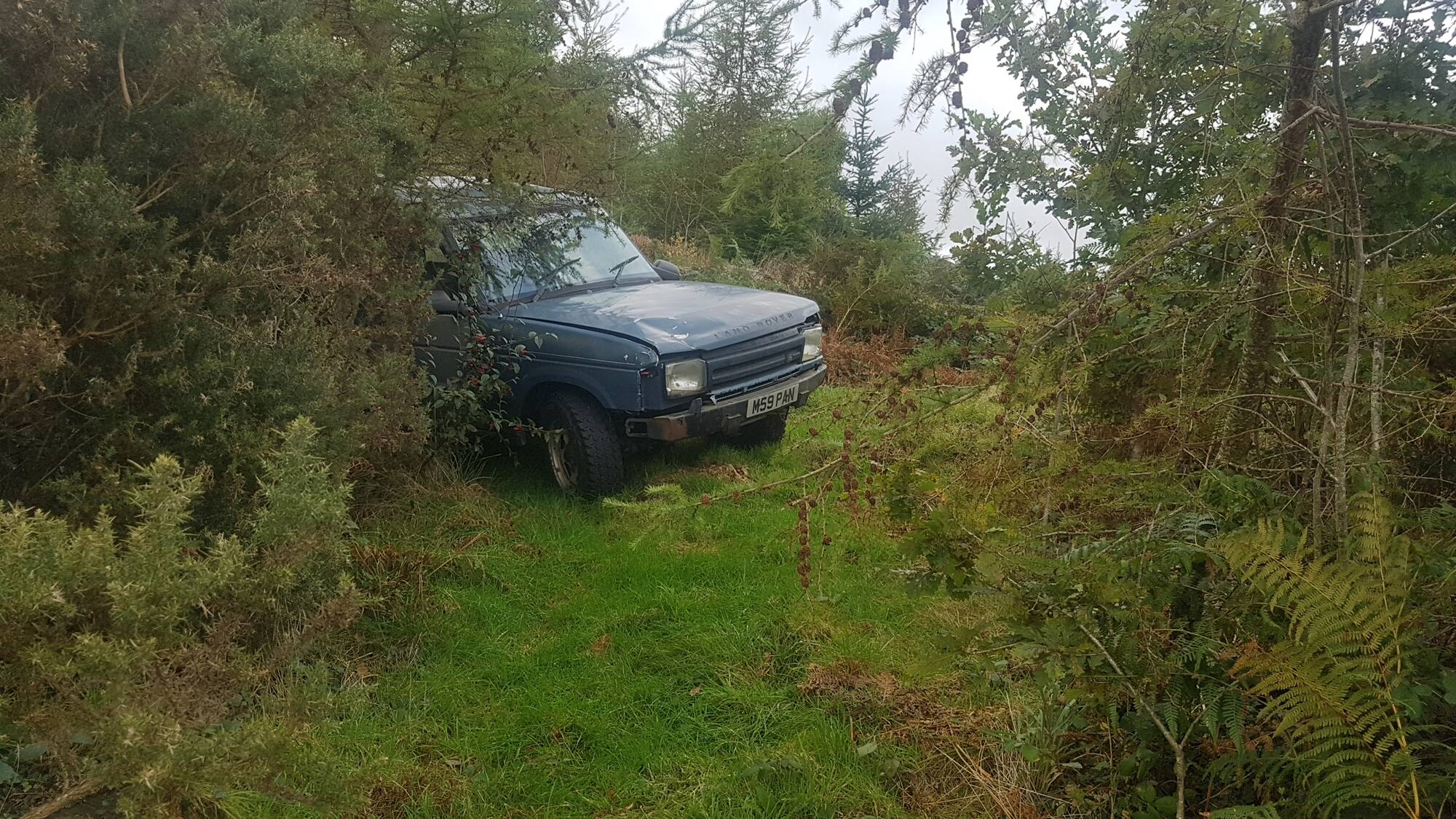

mat_the_cat Posted September 6, 2018 Author Posted September 6, 2018 I keep the battery on this topped up with a solar panel, but it was fairly elderly and undersized, so no surprise that it failed a few weeks ago. The puzzling thing was that it wouldn't even start with a jump pack - a quick check showed no voltage present at the coil. A quick bypass wire straight from the battery, but still no spark, and a check of the other coil terminal showed no trigger either I've bought a new battery to make fault-finding whilst cranking easier, but as yet haven't been able to spend time on it. Fortunately I collected all the wood we will need during the warm weather earlier this year, so not a top priority. Have a photo anyway! anonymous user, Lacquer Peel and AMC Rebel 3

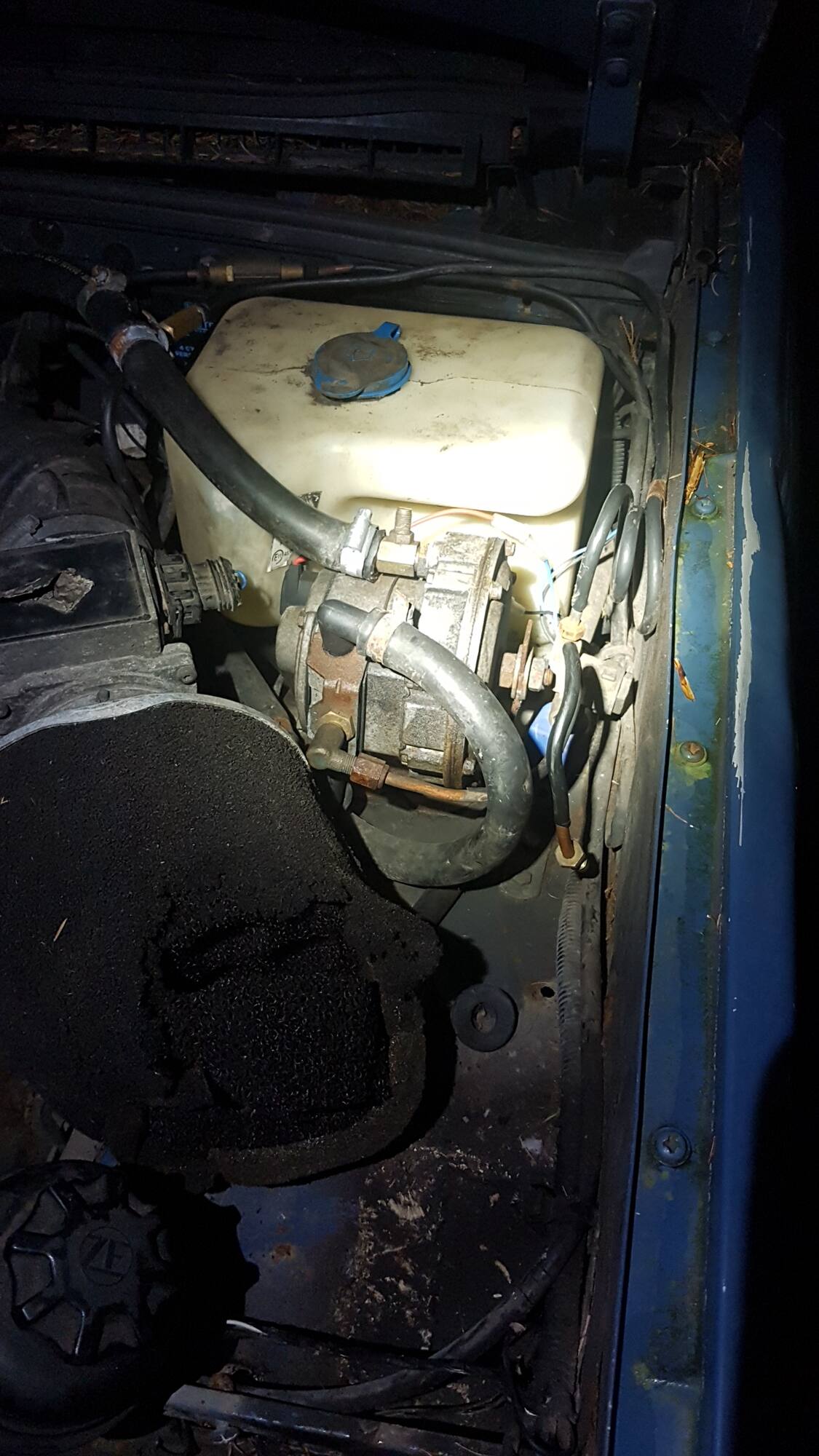

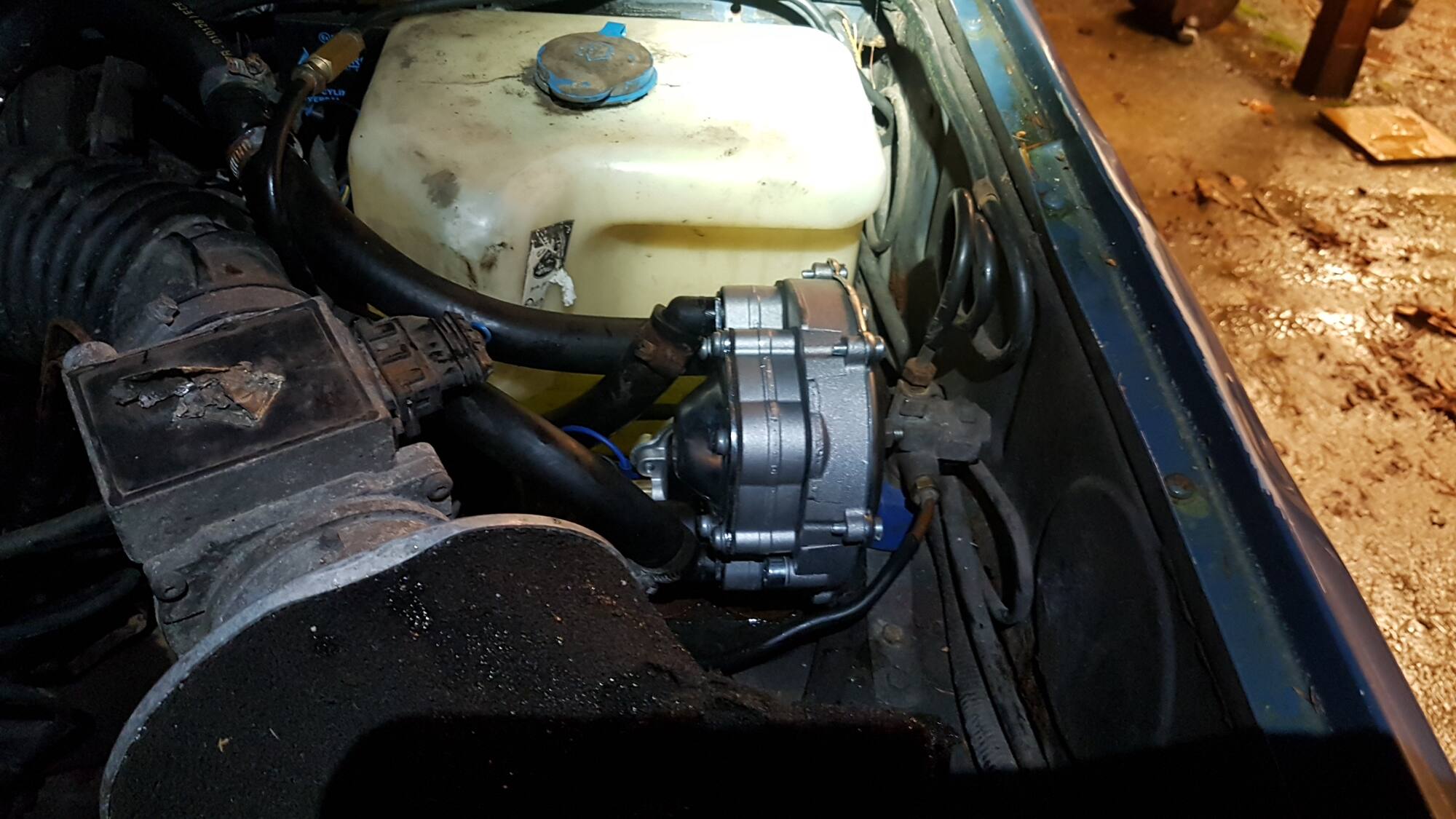

mat_the_cat Posted December 18, 2019 Author Posted December 18, 2019 We've been using this to shunt the Airstream around, so no rest for the winter. Until... A couple of weeks ago the engine just cut out. It would restart, just, but only run for a few seconds before dying again. I managed to lurch it out of the way by starting it at full throttle, and before it cut out shifting it into Drive. Diagnosis was a failed vaporizer, which seemed to be dumping huge quantities of LPG into the inlet manifold. This was a brand I'd never heard of (Groot) and I couldn't find a rebuild kit anywhere. Fortunately, a new one was under £50 delivered, and of an improved design too, having two-stage regulation for more consistent pressure control. Half an hour's work saw it in place and plumbed in: Getting it to fire took quite a bit of cranking, but once running quickly settled down to a fairly smooth idle. I still need to adjust the high speed running, but happy with the result! Tepper, catsinthewelder, Coprolalia and 1 other 4

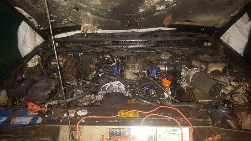

mat_the_cat Posted March 16, 2020 Author Posted March 16, 2020 Update on the green Discovery, which we still have. I was considering a swap with it, but after taking a look I found that storing it under a cover for 2 months had not been kind. The waterproof and breathable cover seemed to have turned into the exact opposite, and let the rain (we've had a lot...) in but trapped it from ever drying out! Looking under the bonnet revealed a crusty mess Battery was completely dead despite being on float charge, and sticking a new battery on produced smoke from the alternator. I did wonder whether corrosion has created a partial short inside, which has then flattened the battery and killed that too. Stripping it down shows nothing evident so far, but a fair bit of wear to the commutator. So I'll probably replace the whole thing given it's original. Then I've got to sort out a leak from the gearbox oil cooler, and investigate why the brake pedal goes straight to the floor. I'm guessing master cylinder, but have a feeling this will lead to a full on brake overhaul... Heidel_Kakao, Six-cylinder, Coprolalia and 3 others 6
Heidel_Kakao Posted March 16, 2020 Posted March 16, 2020 That's frustrating I really dislike that furry kind of corrosion, just something about it. It doesn't help you now (power of hindsight) but I have heard a few people mention ACF-50 as a good product to prevent corrosion but I imagine you had the impression that the cover would be beneficial rather counter productive. It definitely reinforces my intention of never using a cover on Cedric, I know how it holds up in the unit without a cover and don't want to take the risk of having a similar situation.
