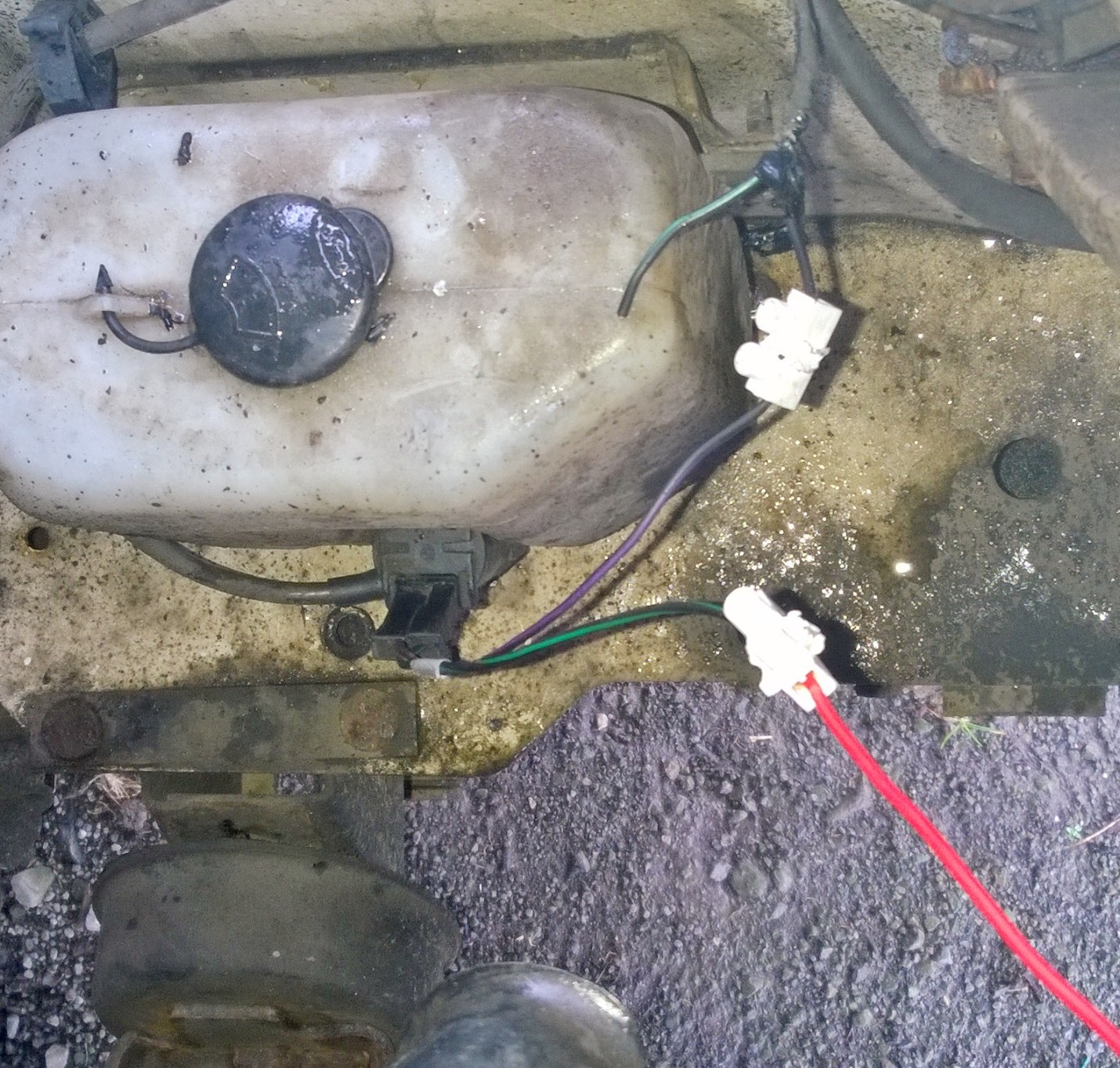

Checked voltage at pump and that is fine. Removed the pump and stuck it straight on the battery and that is cool. Cleaned and sprayed the switches till they sparkle. No joy.
I am just going to run a new switch as it is booked into MOT on Friday. I need it to pass so I can press it into service for house move.
Decided to bite the bullet and get wet fixing it.
It is just a temp repair to get through mot. Once we have moved will solder and heatshrink everything properly.
Simple job to test which lead was + /- then cut off the plugs straight into chocolate blocks.

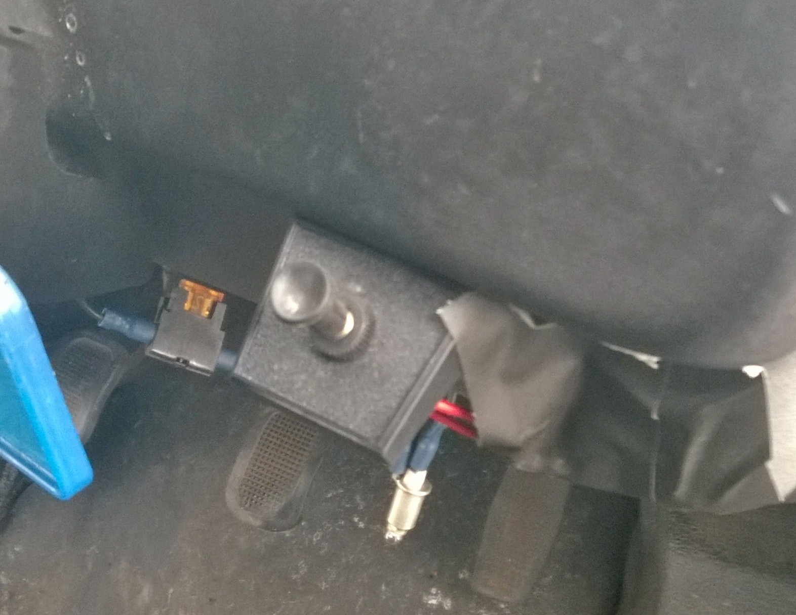

Ran a wire through engine bay into drivers side and fitted a pull switch. Apply gaffer tape and almost factory install*
The new wiper switch is a slightly different shape to the old ones so fitted with longer bolts and the cowling has been put on as best it could be.

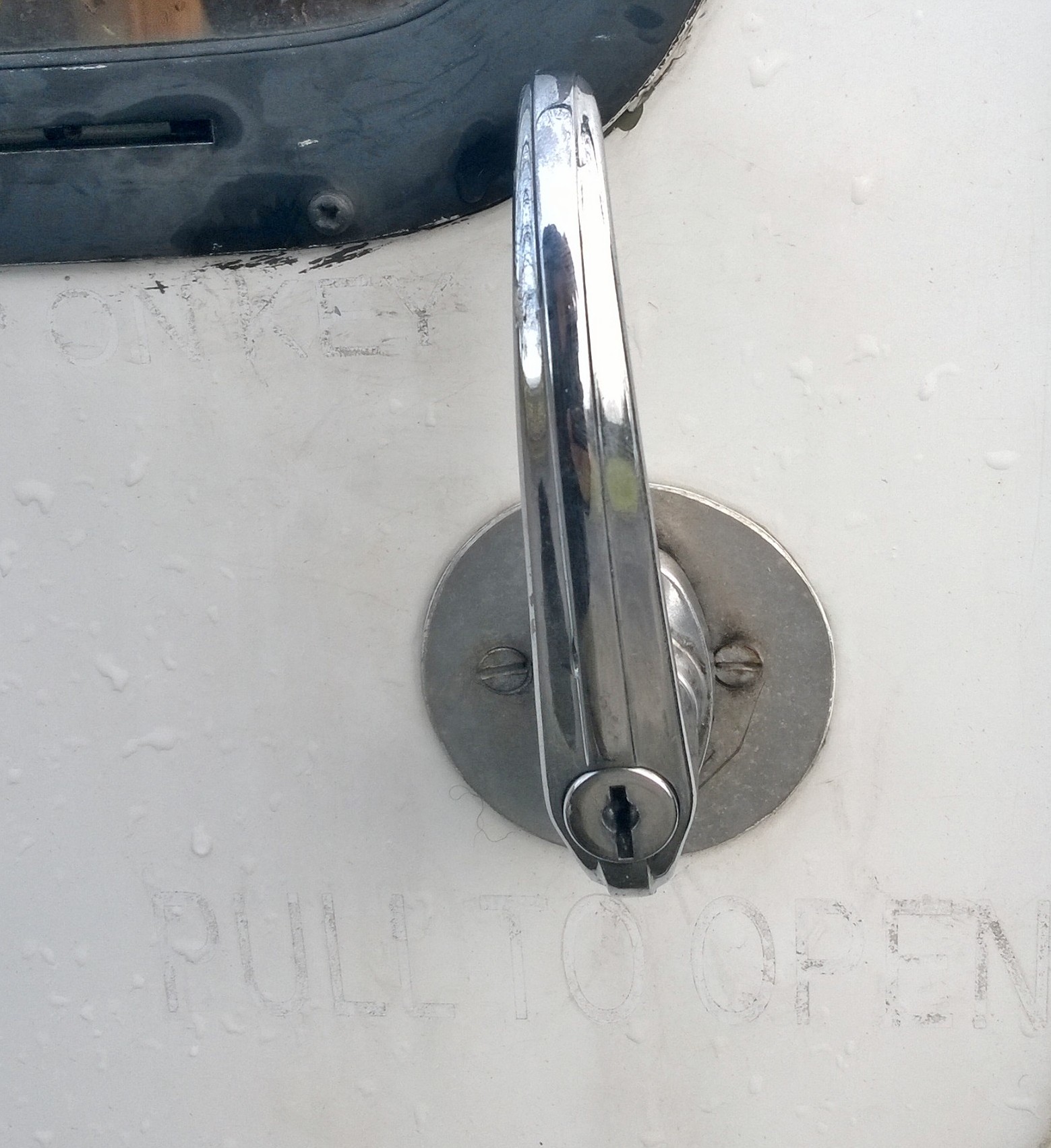

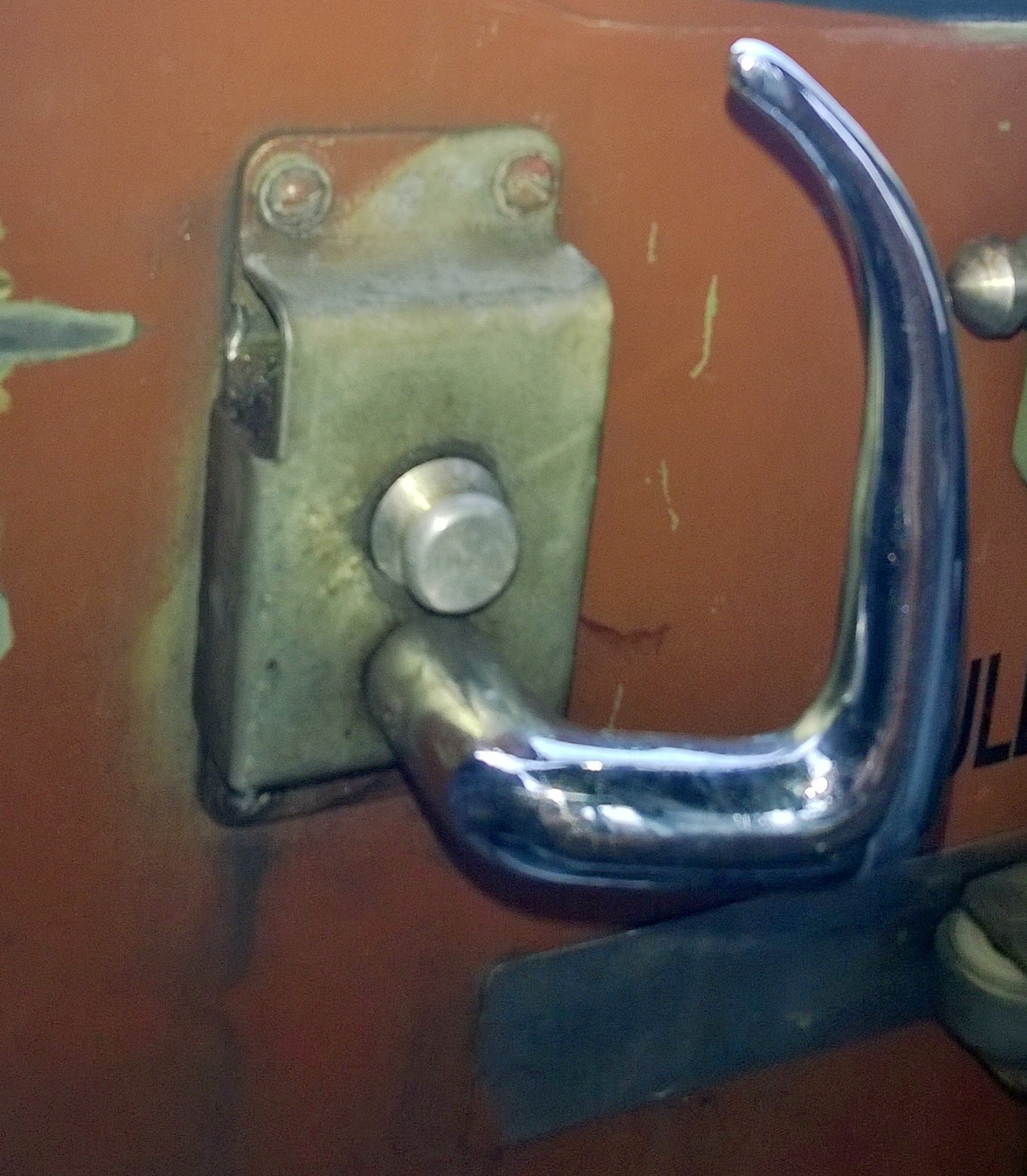

Stupid question time - what do you call this type of handle?
I haven't got a key to it and I think I need to be able to lock the van when I start using it.
Alternatively any ideas on how to lock the drivers door on sliding door which isn't flush?

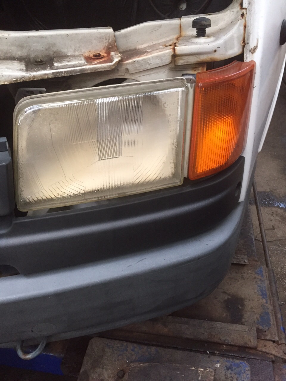

Both headlights are weak

Anyone got a clue about the door handle?

I need some help. The headlights the garage said they could get were the wrong ones and they are struggling to find the right ones.
I think they are square mk3. Are these the right ones? http://m.ebay.co.uk/itm/231488034522?
Or is there a way to clean the reflectors to make them brighter?
Those certainly look the right ones. Looks like the chrome in the reflectors has gone altogether.
