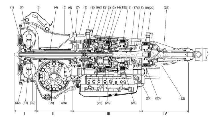

The centre differential splits torque equally between front and rear axles. This centre differential also has a viscous clutch in parallel. This is arranged to limit SPEED differences between rear and front axles. As this is a friction device it will overheat if massively abused by rear axle and front axle continually turning at different rates.
In normal use it's reputation is: reliable.
Just ensure tyres are all the same diameter. If you have to replace two only, put the new ones on diagonally, that will keep the front and rear axles at the same number of revs/mile. I am just about to get (edit -replace ) the car's third set of tyres, at 107,000miles
Automatics have a different arrangement, there is no direct drive to the rear axle, rear drive is brought in by a hydraulically modulated clutch controlled by software looking at wheel and engine sensors etc.
