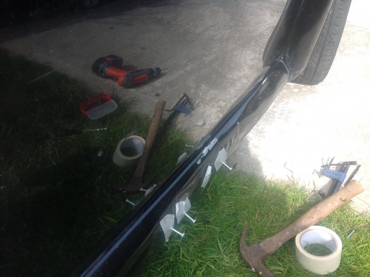

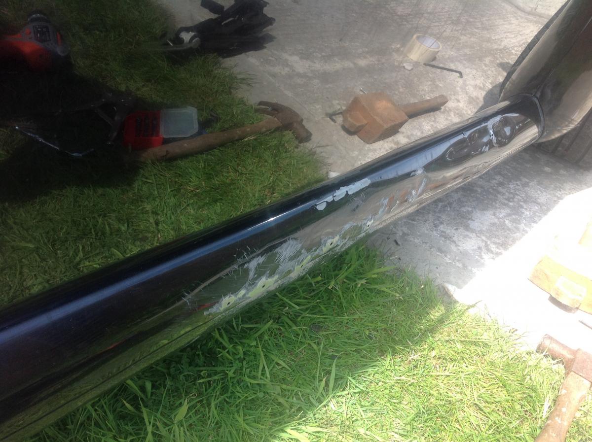

The sill is coming along a treat I should of done a before and after pic..
I found some holes along the length of the sill which I managed to get a long Allen key in and push the worst of the dent out then I drilled about 10 small holes into the sill and used a claw hammer and self tappers to pull the remaining dent out and managed to get rid of about 90% of the damage.

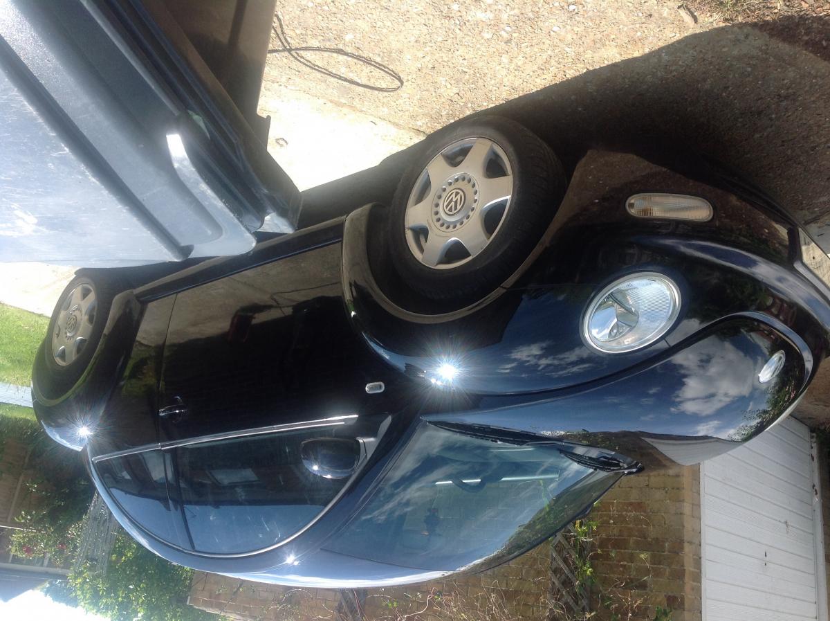

Thanks for all the help I finished painting the old girl yesterday and she really does look great...
I took your advice and can now see where I was going wrong..
The sill ended up only costing about £18 to do in the end as I had some old primer and filler knocking about and an old can of hammerite for the underseal.
I can't believe the results..post-9282-0-74657400-1404297065_thumb.jpgpost-9282-0-43564300-1404297104_thumb.jpg
