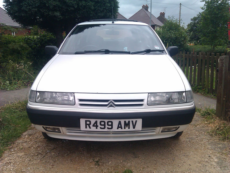

Today, I did something that many people won't understand.  I swapped the attractive Xsara alloys on the Xantia with some much less attractive steels and trims.  Mike also paid a visit in his silly red car.
There is method in the madness though.  I agree, the Xsara alloys looked great on the Xantia, they really did, but they weren't very me.  I wanted something a bit more me and to do that I needed to get the Xantia back on some steel wheels.  The fact that the steel wheels have Michelin tyres in the factory size rather than Westlakes in a low profile is, for me, a large bonus and while the wheel trims do look a bit Halfords they are Citroen original.  Note also the Xantia roof rack, front bar pushed back so it's more aesthetically pleasing to me.  The gains in MPG without the roofrack on the car are so minimal that it makes more sense to leave it fitted, I pull the front bar forwards if I need a larger roof rack.
The other lovely thing Moog brought me was the parcel shelf.  It makes a huge difference to how tidy the car looks from outside and reduces cabin noise considerably inside.
The new tyres are very, very grippy and the clutch feels better on these wheels than it did on the others.  The speedo also appears to read more accurately and it's slightly less effort to get the car moving.  In addition, the ride feels smoother and the wheels now fill the arches much better so all in all I'm much, much happier with the car as it is.
I'll be happier still when the Synergie wheel trims I've bought are delivered as I'll get all of the above and some sexy looking wheels instead of the so-so wheel trims look I've got going on right now.

Today, my Synergie trims arrived.  They do need a repaint to make them perfect, I'm just not yet decided on if they're going white or factory silver yet.  I am decided that I really like them.

I love the new trims on it Angyl, and do keep them silver please, because you can't paint the headlights white, that would be silly.
Would clear repeater lights be an option?
Yes, Saxo clear side repeaters are a straight swap so I just need to get a pair to tidy things up.  The more I've thought about it, the more I think silver trims is going to be the way I go, keep it looking properly factory rather than special edition.
