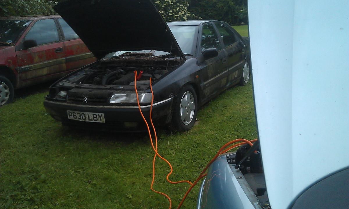

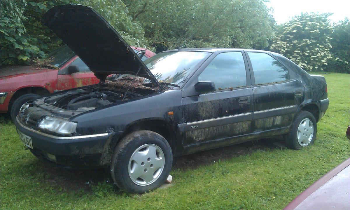

Round about a week ago, plans were put into action to sort out Le Oignon's ruined wheel bearing & sloppy ball joint, a plan which began in a field in Lincolnshire, just here:
It's only been 8 years since it was parked, it should start up ok, right?
Yep, a few squeezes of the primer bulb and a boost from the C5 and we have lift off!

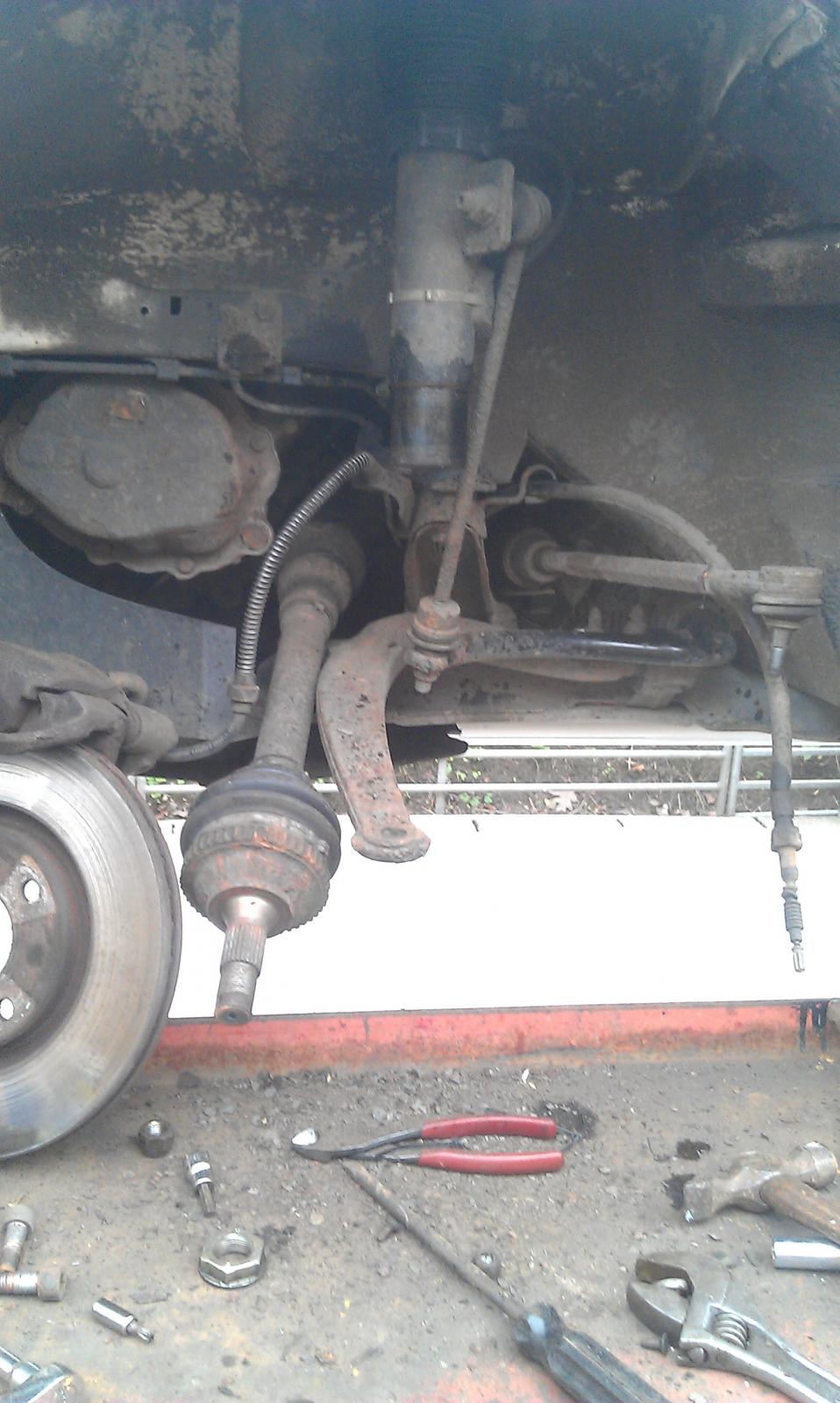

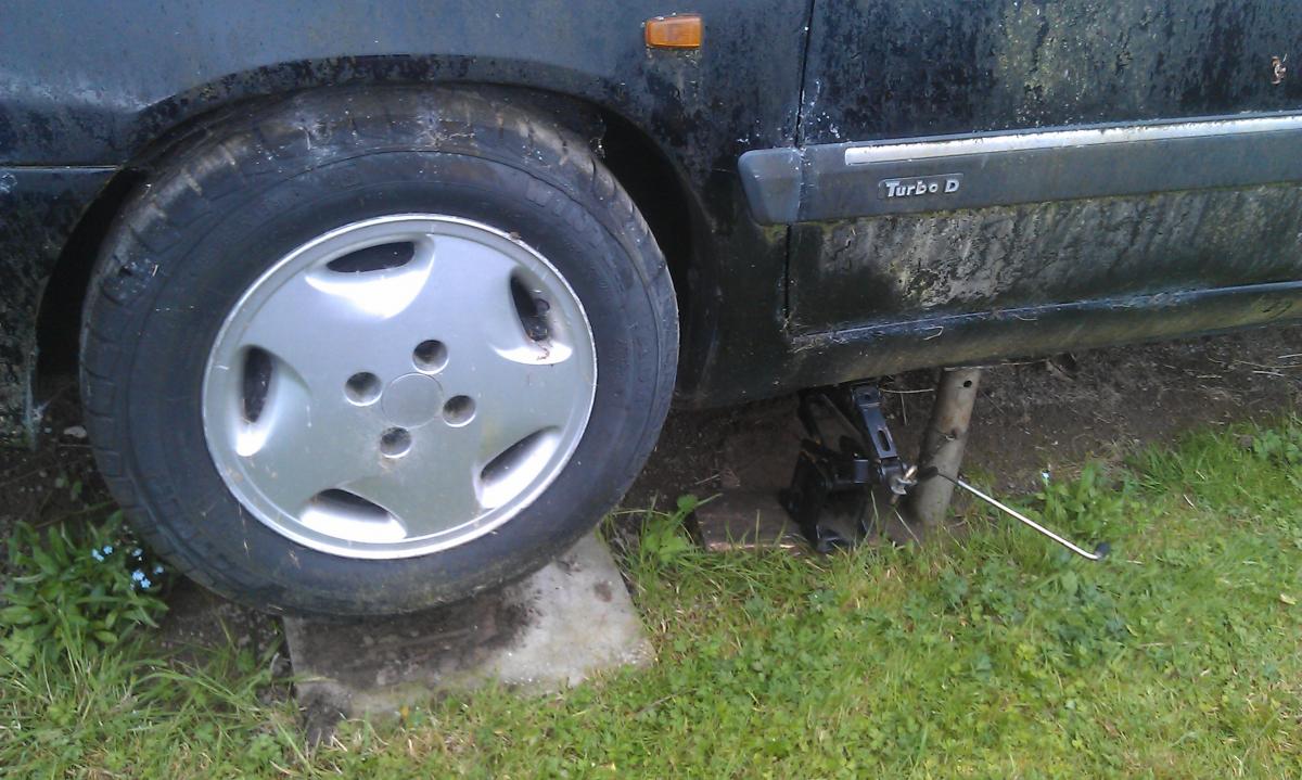

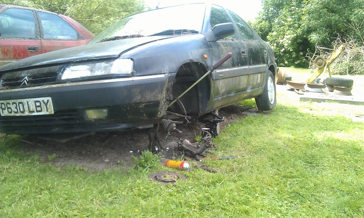

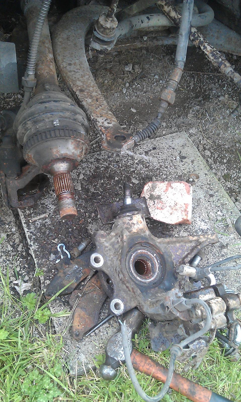

And so whe get jacking and get cracking:

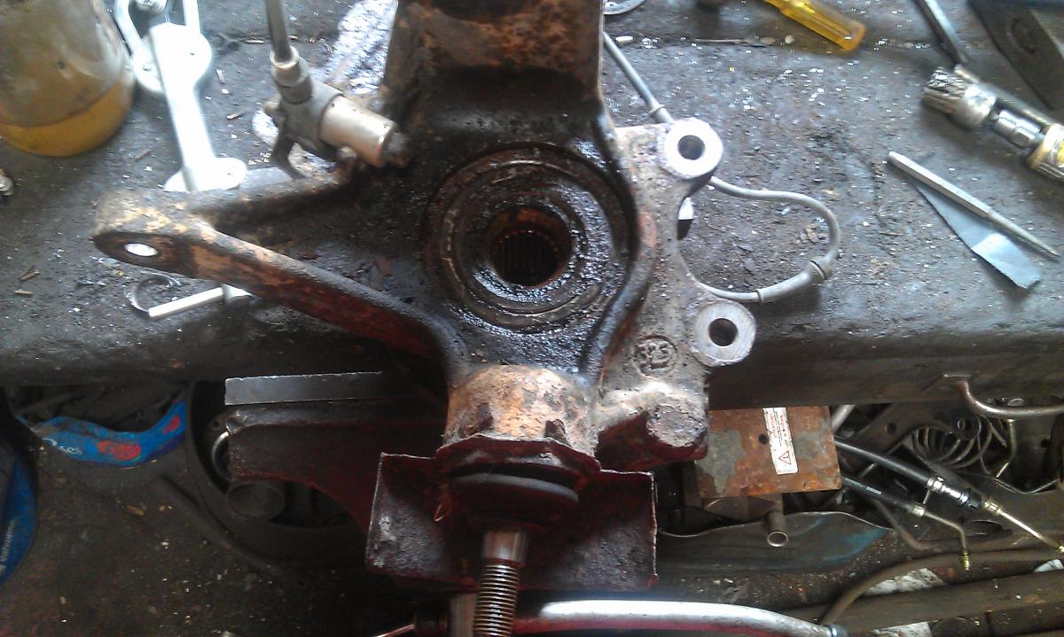

An hour is enough to release the hub from it's former home, nothing was too difficult and the bottom ball joint looks reasonably new, so we elect to leave it be.
Not so for the wheel bearing which is replaced as a matter of course:

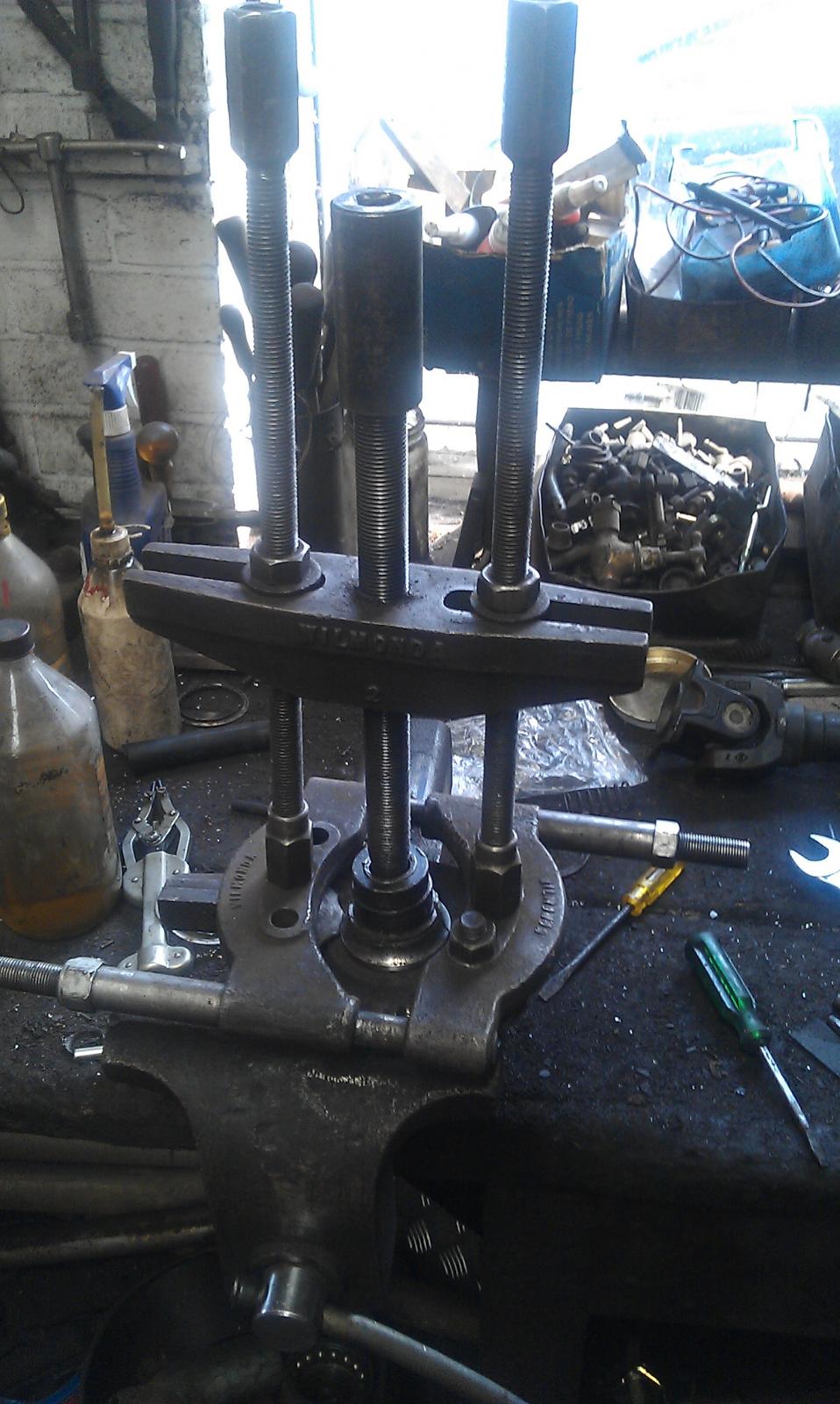

Acetylene is needed to release the old circlip,
Pulling the inner race off of the hub:
And all together:
