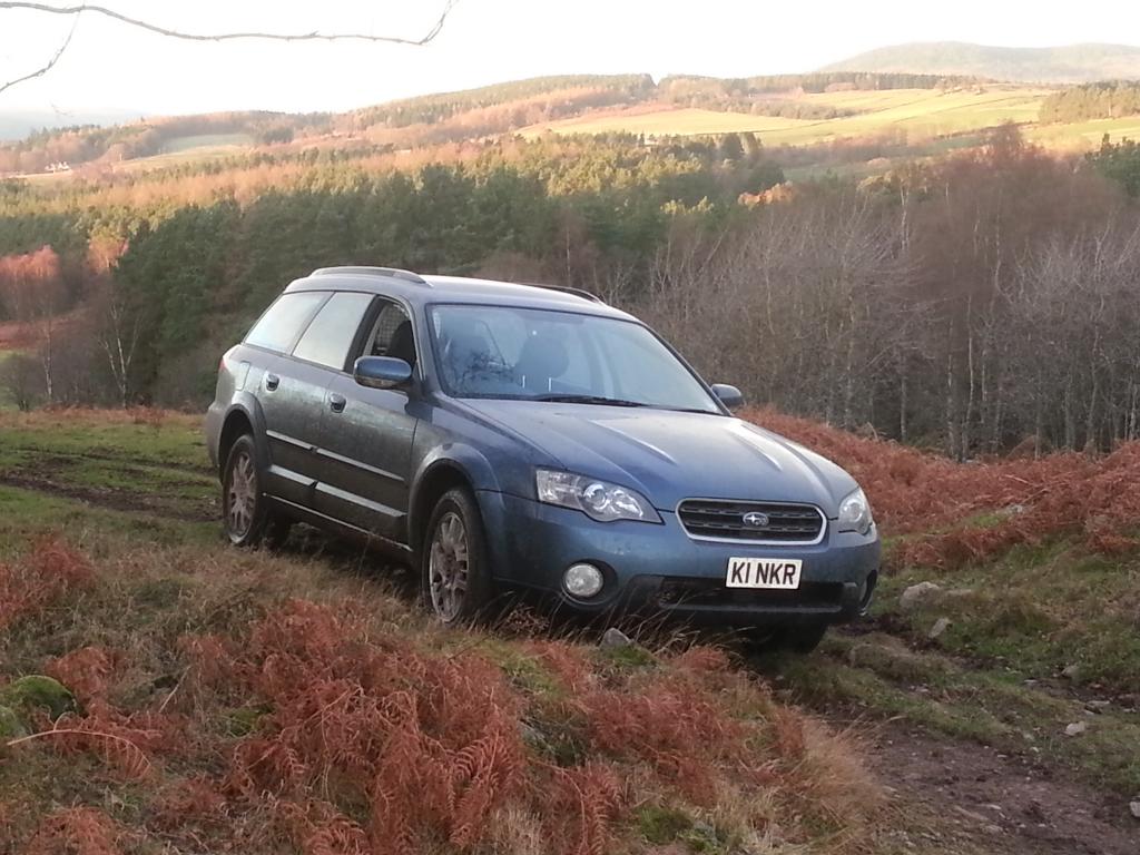

Subaru...lpg..... nah.  not had huge experience, but had a few...... none good.  something to do with burnt valves and poor starting, admittedly all these were the 2.5 legacy engines ones...but to my mind, not worth the hassle, I fi were you, you should look for a 2003 on 2.5 manual,. they will do 35mpg average with no issues, and 38mpg on a steady run, I drive like a twat every where in mine the eml light has been on for the last 8000 miles and in that time I have averaged 33mpg and on a steady long run will get 36mpg over a tankfull, also im running on the cheapest of cheap snow tyres.
the older pre 03 ones will struggle to get 27mpg even when nursed, and although good cars, are not a patch on the newer ones.(not a thing often said on here :) )
I managed to pick my 53 plate outback new model with 107k on it for £800, that was amazingly cheap, but bargains can be had, esp at this time of year.  Lee
There are 3 outbacks on autotrader under £2000, the autos are good, but 2 or 3 mpg less than manuals and no low ration, not really an issue, but I defrfo prefer the manuals. mrs kinkersaab has an auto and its fine.
