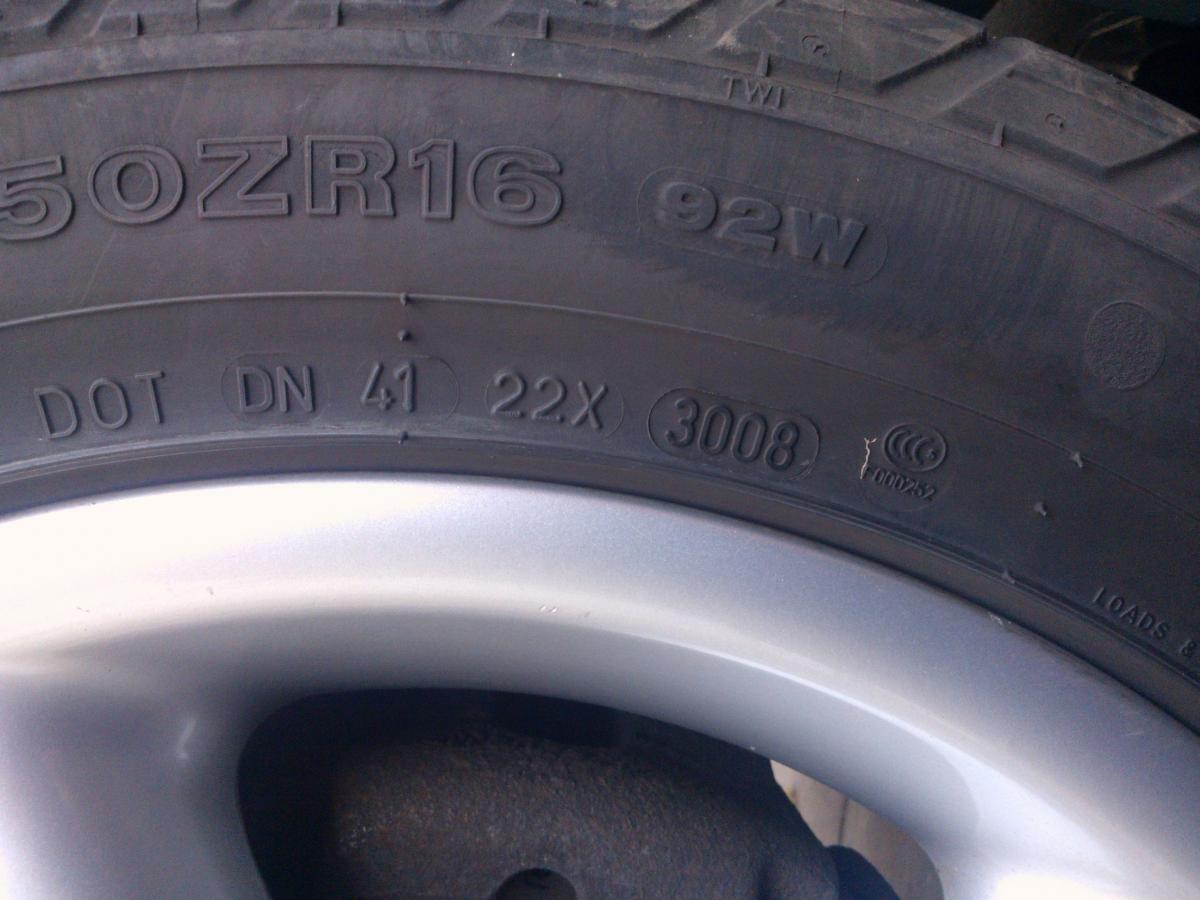

spike60 Posted March 10, 2014 Posted March 10, 2014 How old are the tyres? Most have a 4 digit code stamped on one sidewall after where it says DOT then a mixed letter numbers code. The one which tells the age is usually only on 1 side and something like 3008, which would be week 30, year 2008. 3 digits mean before 2000.This tyre would be week 30, year 2008.

stuboy Posted March 19, 2014 Posted March 19, 2014 How old are the tyres? Most have a 4 digit code stamped on one sidewall after where it says DOT then a mixed letter numbers code. The one which tells the age is usually only on 1 side and something like 3008, which would be week 30, year 2008. 3 digits mean before 2000.WP_000134.jpgThis tyre would be week 30, year 2008.that a ford wheel?
