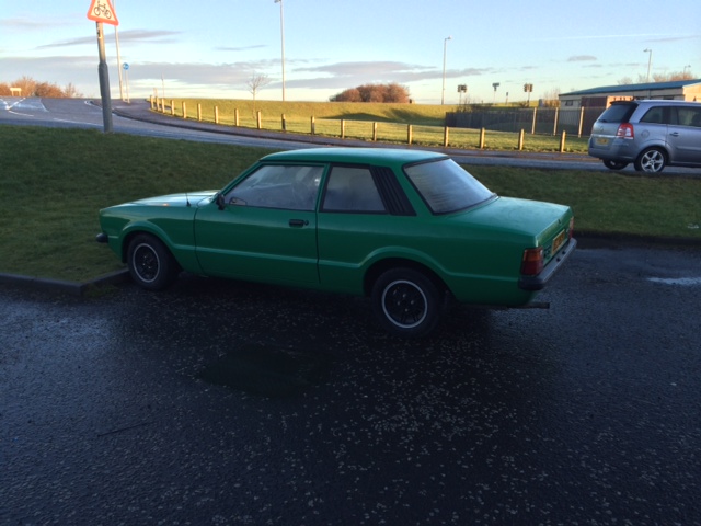

Seems to have worked so I took it outside!
I got one of those GPS speedo apps for my phone and it doesn't look too far out. My speedo was reading 33 when the phone said 30. Probably the best way to be as it means I should always be slightly under the limit if I go by the speedo. The brakes while better than they had been I.E they don't try to drag you off the road into a tree still feel a bit soft. I recon a bit more bleeding is required.

It's tiny next to an A4
It's exactly 2 inches too small for my lockup what a pisser.
