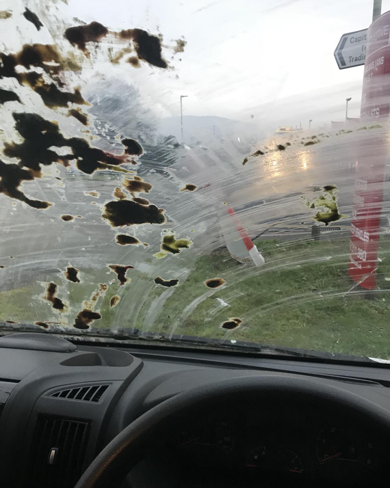

How about some examples of the worst condition cars you’re presented with to work on / for MoT etc?
I just dropped this state off for service, apologised and feel sorry for them having to chisel it off before they start on it!!
