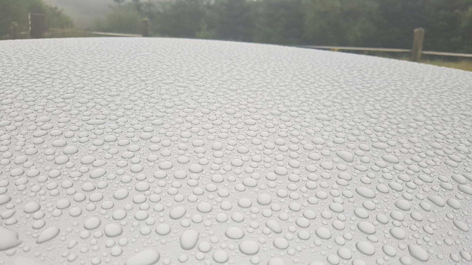

In other news the weather is as depressing as usual. Grey and rainy, but at least makes for nice beading photos if you're into that kind of thing!

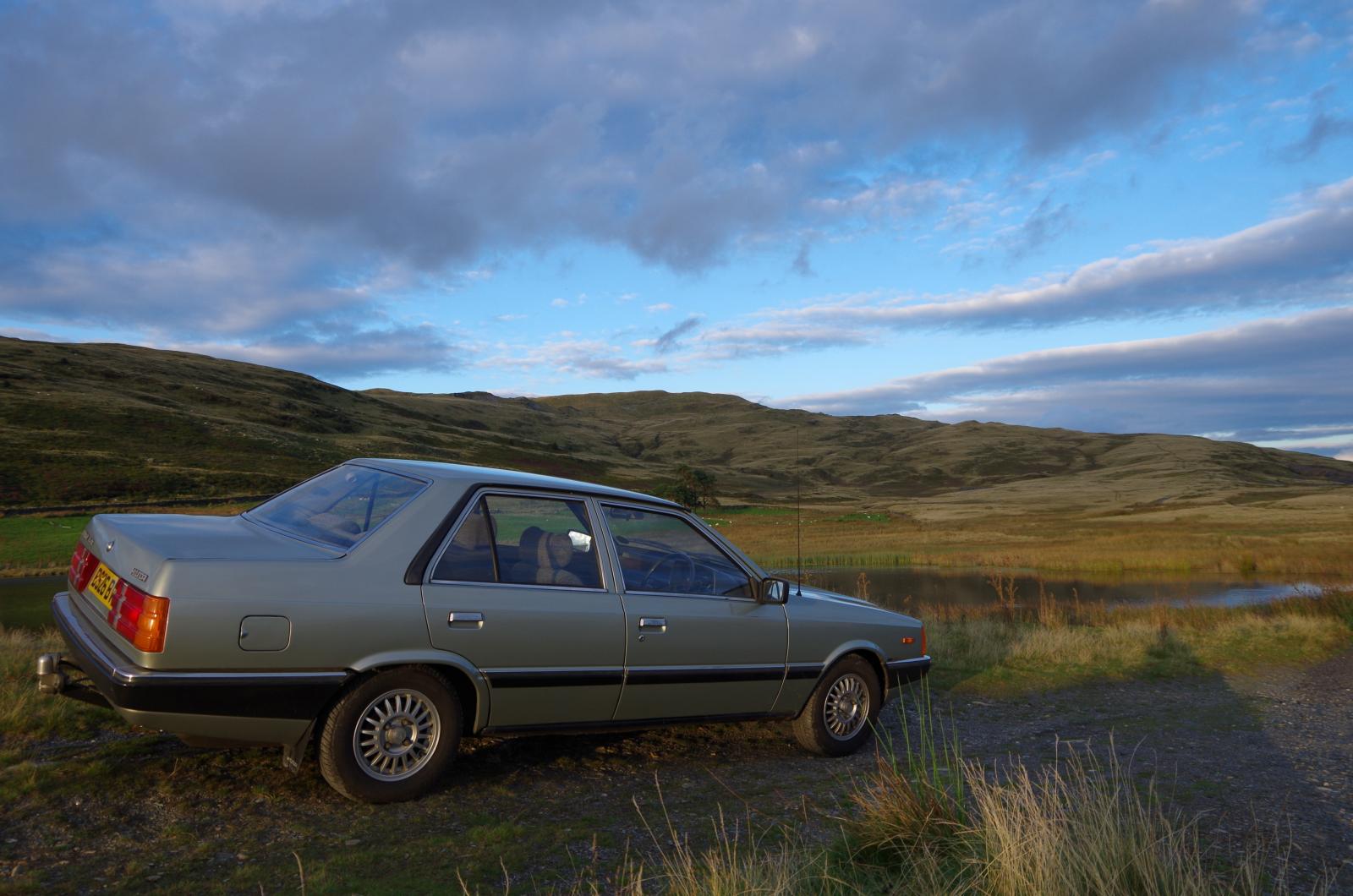

To celebrate I went for a little drive into the mountains, up a little-used track to a small lake which is a good spot for photos.
So much fun :-D
