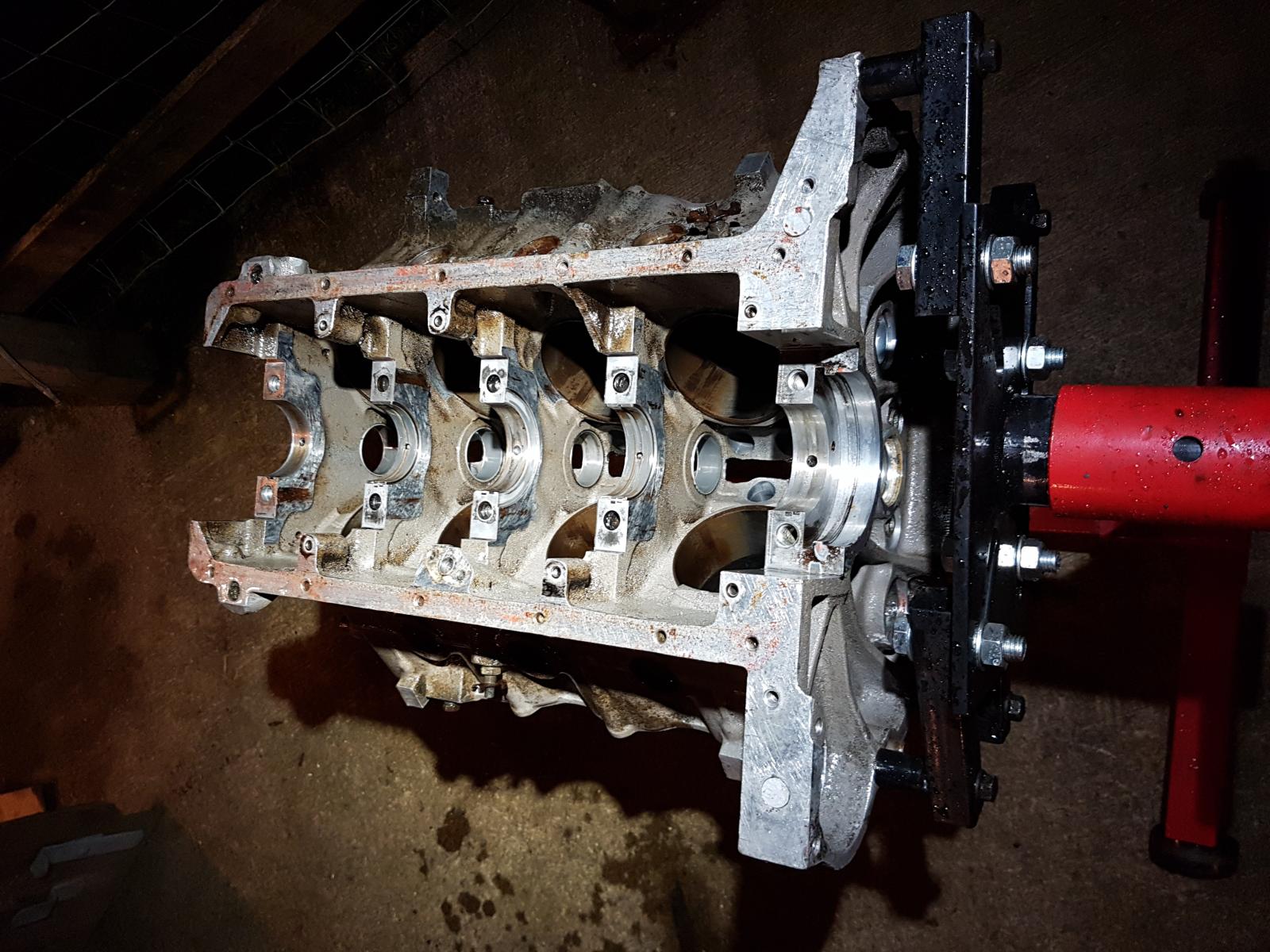

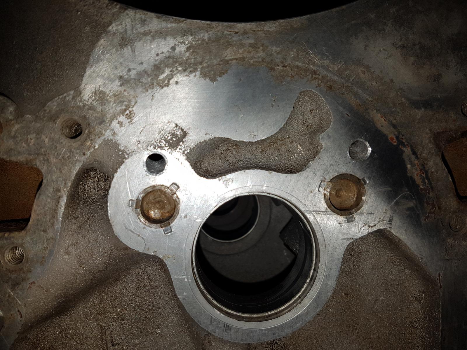

I've stripped it down to the bare block now, so here are the pictures to date.
This is why I dislike gasket sealant!
I'm now glad I'm doing a full overhaul!
That explains the mark on that bore at least.
Big-end bearings fairly worn too:
But main bearings even worse:
None of them have worn down to the steel backing of the shell though, so I'm hopeful the crankshaft is OK - not examined or measured it yet.
I'm taking the block and crank in for (hopefully just) a hone and polish tomorrow, so given the block a bit of a clean up. I will get them to give it a thorough clean afterwards too.

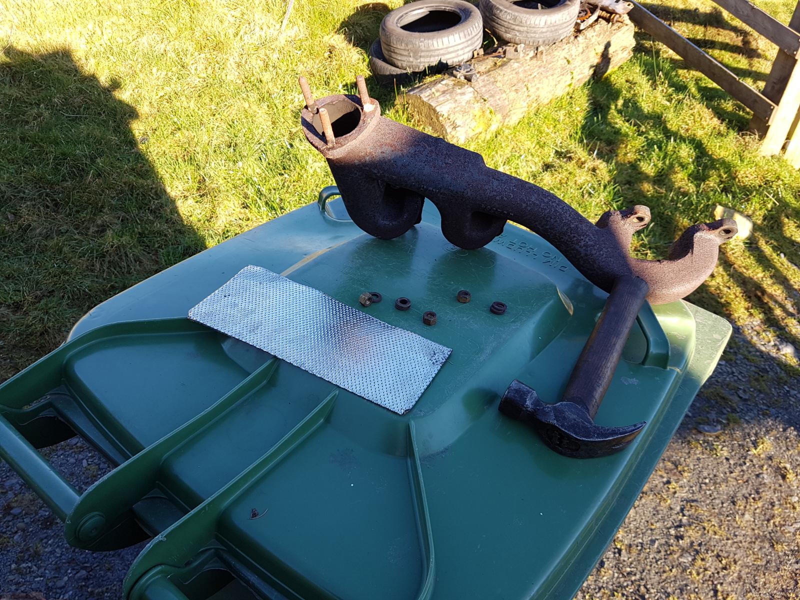

Not much to report, but the sun was shining this afternoon so I did some work outside on my mobile 'workbench'.
The company who did my exhausts had used paste to seal them to the manifolds, as I hadn't been able to find gaskets to suit them. They were originally from a P5B, being the tightest to the block manifolds I could find, and a larger diameter to anything the local factors had listed for a Rover V8.
The paste didn't seal too well so there was a light blow, which I mistakenly thought could be a cracked manifold. So I've decided to make my own gaskets for reassembly. First of all a tap with a hammer to mark where to drill:
Then slide over the studs and cut roughly to shape:
One side done!
MGB V8 manifolds are about the closest to the block ones I've seen for the RV8.
You're right, I did investigate those with a lot of Google image searching...
However the exit from those is in the middle, which is right where the front subframe is on the Stellar! Not an insurmountable problem, but I was keen to minimise any modifications to the shell, as well as wanting an easy life!
The P5B manifolds were a lucky stroke really, as I just found them via an image search, thought they looked about right and following the link they were on an old Retro Rides for sale thread. Much relief when they slotted into place.

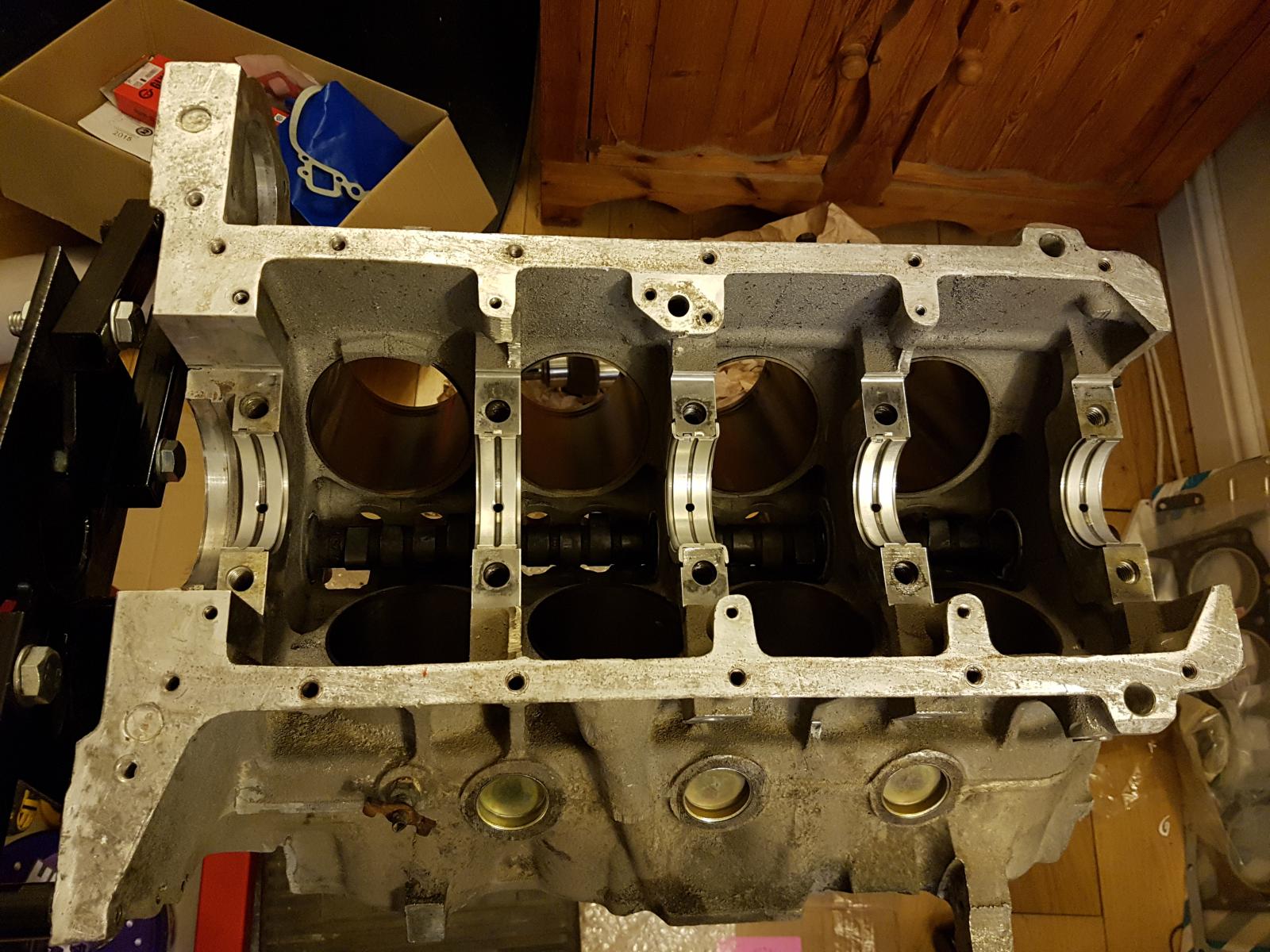

Update time! The bores are OK, and the scuff mark will apparently just hone out. More good news is that the crank just needs a polish :-) Slightly worse news is that the surface of the block shows some fretting from the HG shifting around, so that won't give the best seal on a new gasket. So I'm getting the deck skimmed to clean it all up - I'll need to get some material removed anyway to allow for the (thicker) composite gaskets I want to fit.

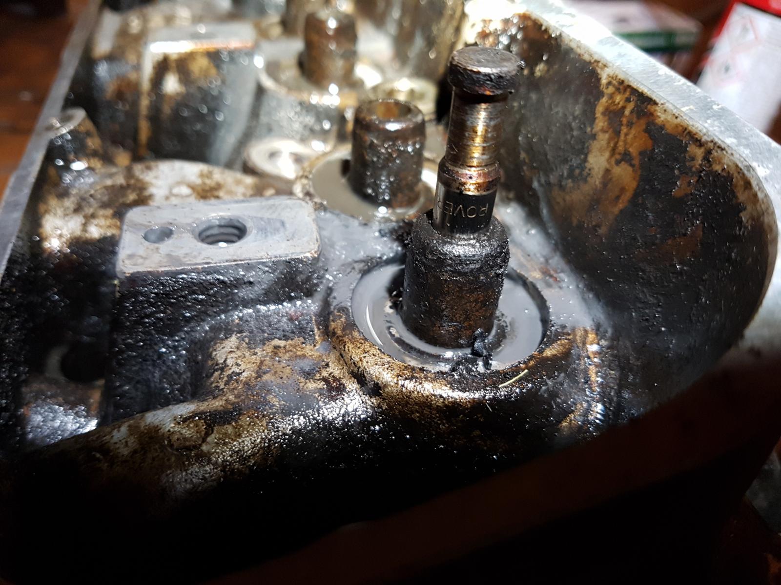

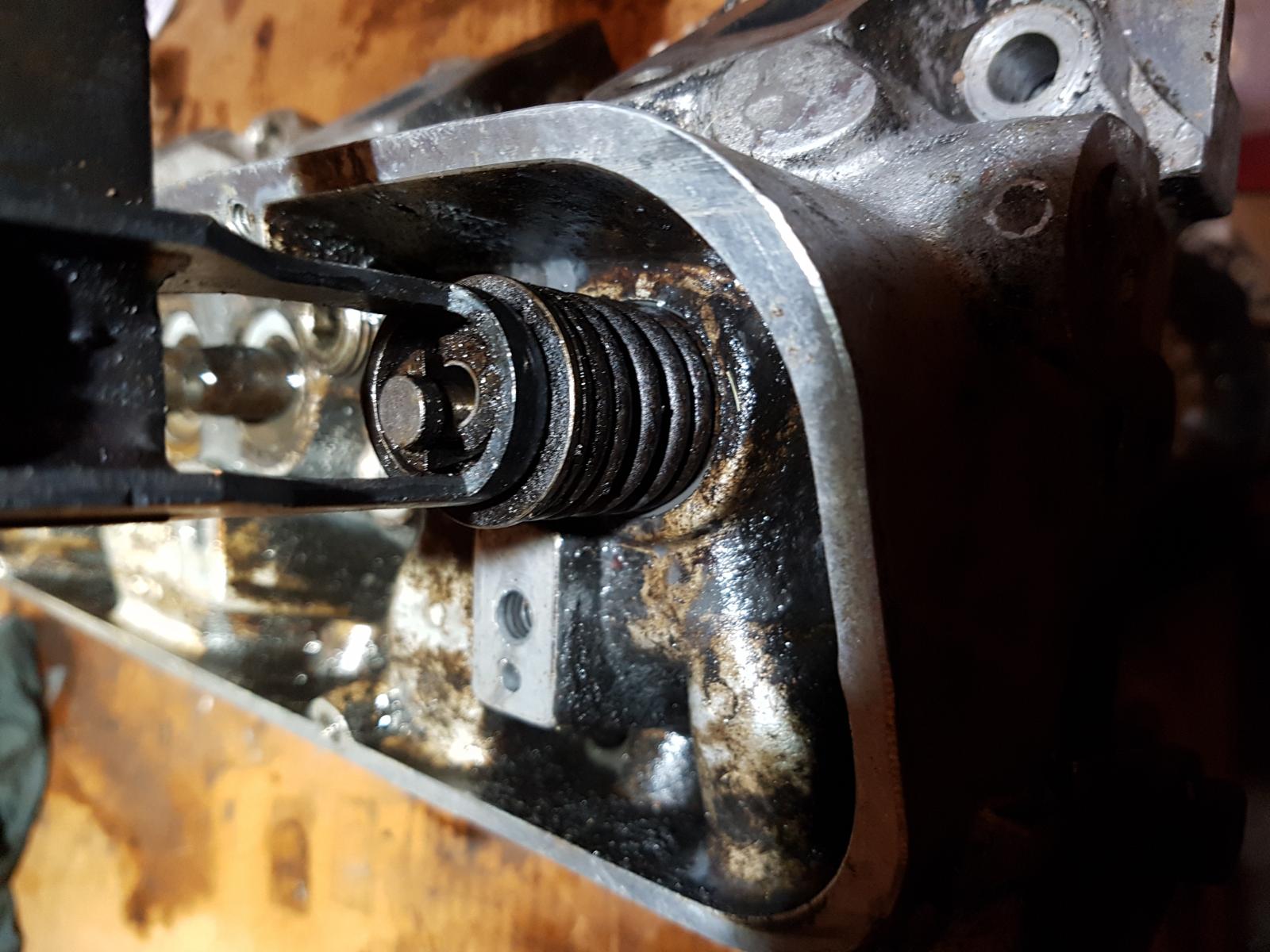

The heads are now stripped down; last valve coming out:
The valves and guides appear at first sight to be in perfect condition. No detectable side to side movement with the valve open, and sliding up and down beautifully. Original Rover valves too!
The only slight concern is that these are the early type of guide, with no valve seal fitted. Later types are machined for a stem seal, and rely on an impregnated lubricant rather than the engine oil. I've read that you can get the early guides machined to fit the seals, but to my logic that sounds a poor idea as you'd be running the different material with next to no lubrication.
As it was showing no signs of burning oil, I'm inclined to leave alone and just clean up/relap the valves. Still need to measure the springs, which I'll replace if needed.
I've cleaned up the heads this evening, and they are now sat by the fire to dry out.
I've also taken the file to some of the rough cast edges on the oil drain holes. It seems a good idea to get oil back to the sump as fast as possible, especially given that my oil capacity is lower than standard as I've cut and shut the sump to clear the crossmember.

The block and crank are ready, so I'll be collecting them this Friday and dropping off the heads for a skim. As well as parting with cash for lots of shiny bits!
The only unknown at this stage are the pistons. To me the ring groove appears too wide - certainly there is a (relatively) large gap with the old rings, although it needs to be measured with new rings. However, I'd imagine the aluminium would wear more than the rings so am expecting the gap to be similar with new rings.
Which means I'll likely need to replace the pistons, unfortunately :-(
It begins!
I picked up the block and crank today :-) I've left the pistons there as they'll put them through the parts washer, but they reckon that visually they look to be OK.

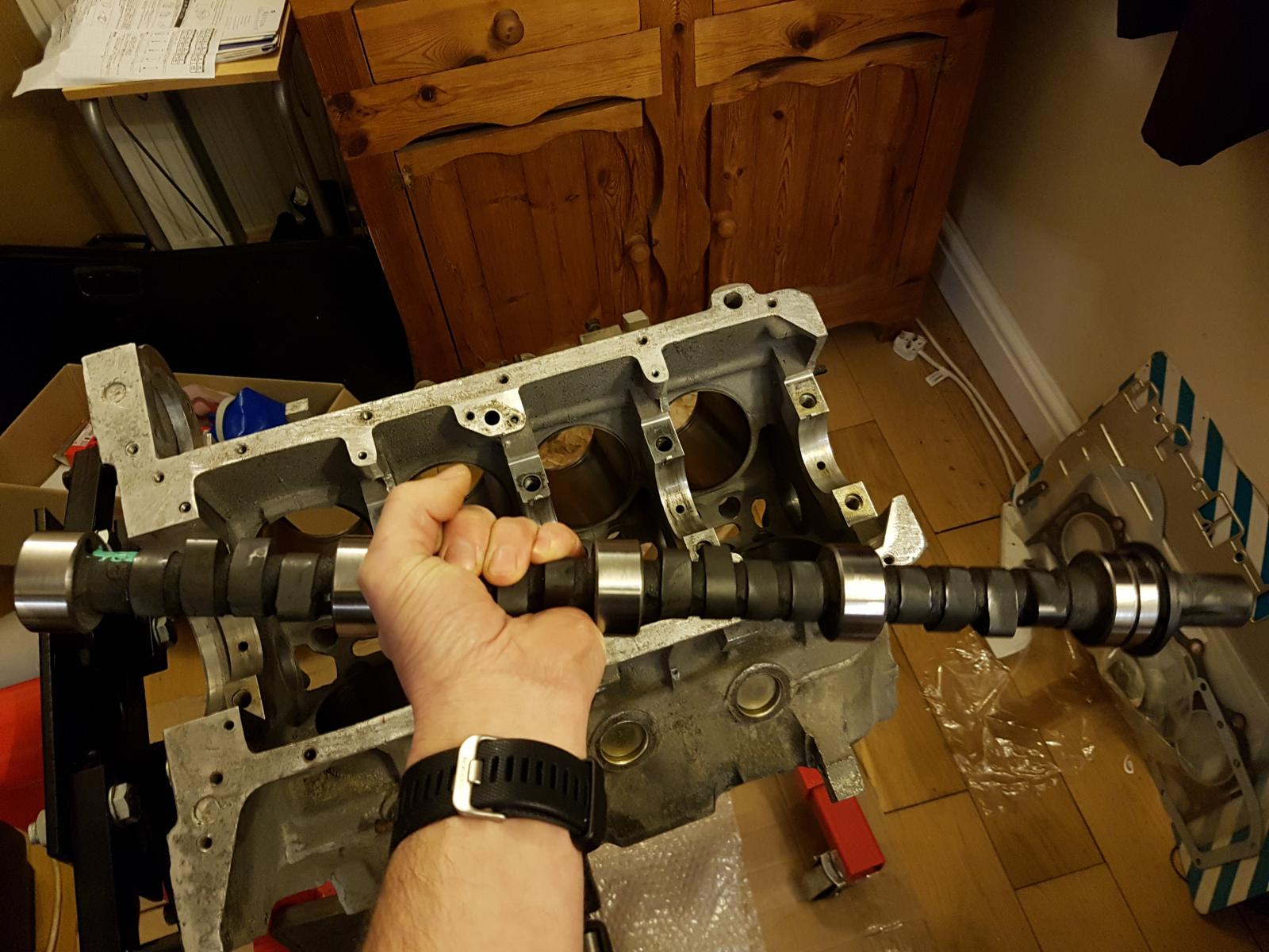

Had quite a productive evening tonight, as first of all I drilled the holes in the valley to allow oil to drain over the timing gear:
Then put the camshaft in after smearing the journals with assembly lube.

Ace. Because I've watched Roadkill Garage, I know things about breaking in camshafts. Not very much though. How do you do it? And how do you avoid trashing the rest of the engine? Isn't the drill to take it to fairly high RPM straight away?
As I understand it (and I'm far from an expert!) the idea is to bed the cam lobe and lifter surfaces together, but avoid idle speeds - as this is where (splash) lubrication is lowest but also forces on the nose of the lobe are highest. 2k rpm is a figure I've read, but good to vary it slightly.
The new cam has a phosphate coating on the lobes, which helps the oil stick to it, and also acts as a dry lubricant if required.
http://www.phosphating.net/manganese-phosphating.html
I'm also going to be using plenty of assembly grease on it, but haven't coated it yet as that will just attract dust.
Hopefully the rest of the engine can take 2k rpm for 20 minutes without damage! I'll obviously be priming the oil pump with a drill prior to cranking.
Pack the oil pump with vaseline, then it'll prime a lot more easily.
