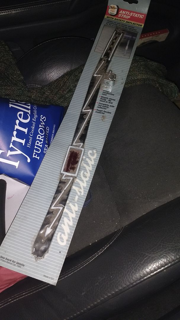

It's looking gr9! But imagine what it's gonna look like with this Mutha hanging off its arse end!
