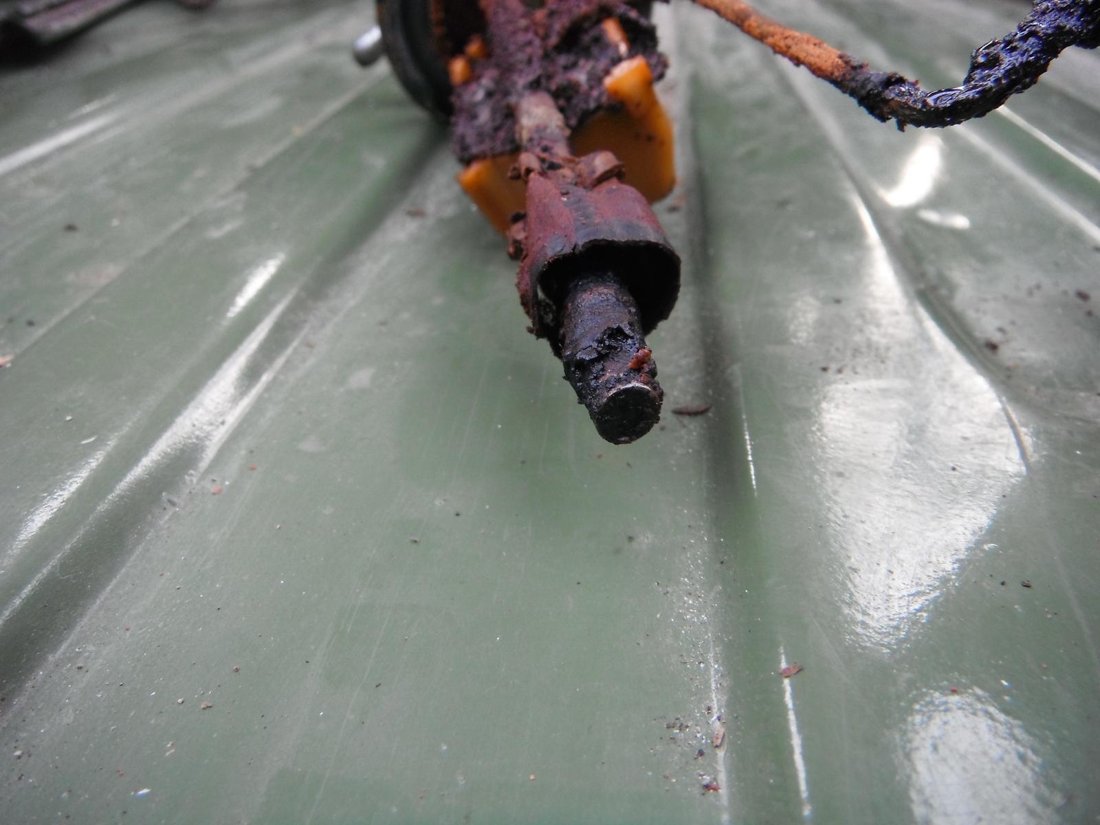

Another day, another failure to get the car running.  Sorry to disappoint there.  However, I do at least know what was causing the issue with fuel not getting where it should.  Because absolutely nothing was coming out of the pipe I did what I should have done ages ago and pulled the pipe off the sender and removed it from the tank revealing immediately the problem which is a missing filter bag and a completely clogged pick up line as well as lot of sludge.
I know, I know, I should have dropped the tank and flushed it all through and checked this before even trying.  I didn't, this is the result.
It didn't look like rust, so I let it all dry out before doing anything about it and it now looks like it's covered in what I assume to be refining sand.
I'll clean it up as best I can so at least it can be used to suck fuel up if not tell me how much is actually in the car.  The fuel gauge has worked, once, while I've had this car so I'm hopeful this can be salvaged.  It will of course need a new filter bag too since that's either dissolved or rolling around in the bottom of the fuel tank somewhere.
With the sender out, I checked that there is definitely fuel in the tank, which there is, you can just make out the reflection of it.
Bought a couple of fuel filters, the only ones the shop had, connected one to the fuel line and dropped a length of hose in the tank then connected the electric pump to the other end to see if it would pull fuel through.
Unfortunately, the fuel line that runs the length of the chassis has a blockage in it somewhere.  Mike's going to bring the little compressor home so we can blow the line through back towards the tank to hopefully clear it and we'll retry a start with the current fuel filter set up.  If the old sender does clean up and work then that's great, I'll get it refitted.  If not, I'll look for a new one in the new year, I shan't have the funds for one before then.

Right then, I had a go at cleaning up the sender to see if it was salvagable and I think it is.  Once it had dried out, most of the grime was quite powdery, sandy stuff and could be literally brushed off with an old toothbrush and no cleaning agent.  There is some surface corrosion to the mild steel components but nothing terminal.  The tattered remains of the old filter bag completely disintegrated so I need to find a replacement but other than that, it's all good.  The blockage in the pick pipe was quite minor too and cleaned out with welding wire, I then ran some water through it to check it was flowing freely, which it is, followed by some WD40 to make sure it was all dried out.  The rubber sealing ring is still supple so should be reusable and the float is free moving and submerging it in water didn't result in any bubbles coming out or water going in so I assume they're both good.  The float arm moves very freely now too.  Usefully, the little square of orange you can see to the side is a removable panel that slides out of the main body of the sender so you can clean out all the sediment from inside it.
The float tang and the resistance wires (at least I assume that's what they're called) are all in surprisingly good shape with no corrosion to speak of and what corrosion you can see in there is just on the steel backing plate and looks worse than it is because of the flash and things still being a bit wet.
This stands a fighting chance of working I'd say, which I wasn't expecting when I pulled it out of the tank.  I'll get the multimeter on it tomorrow (it's not here at the house) to see if it is actually doing what it should.  If it works, the only thing I'll need to find is a small replacement filter for the pick-up pipe.
