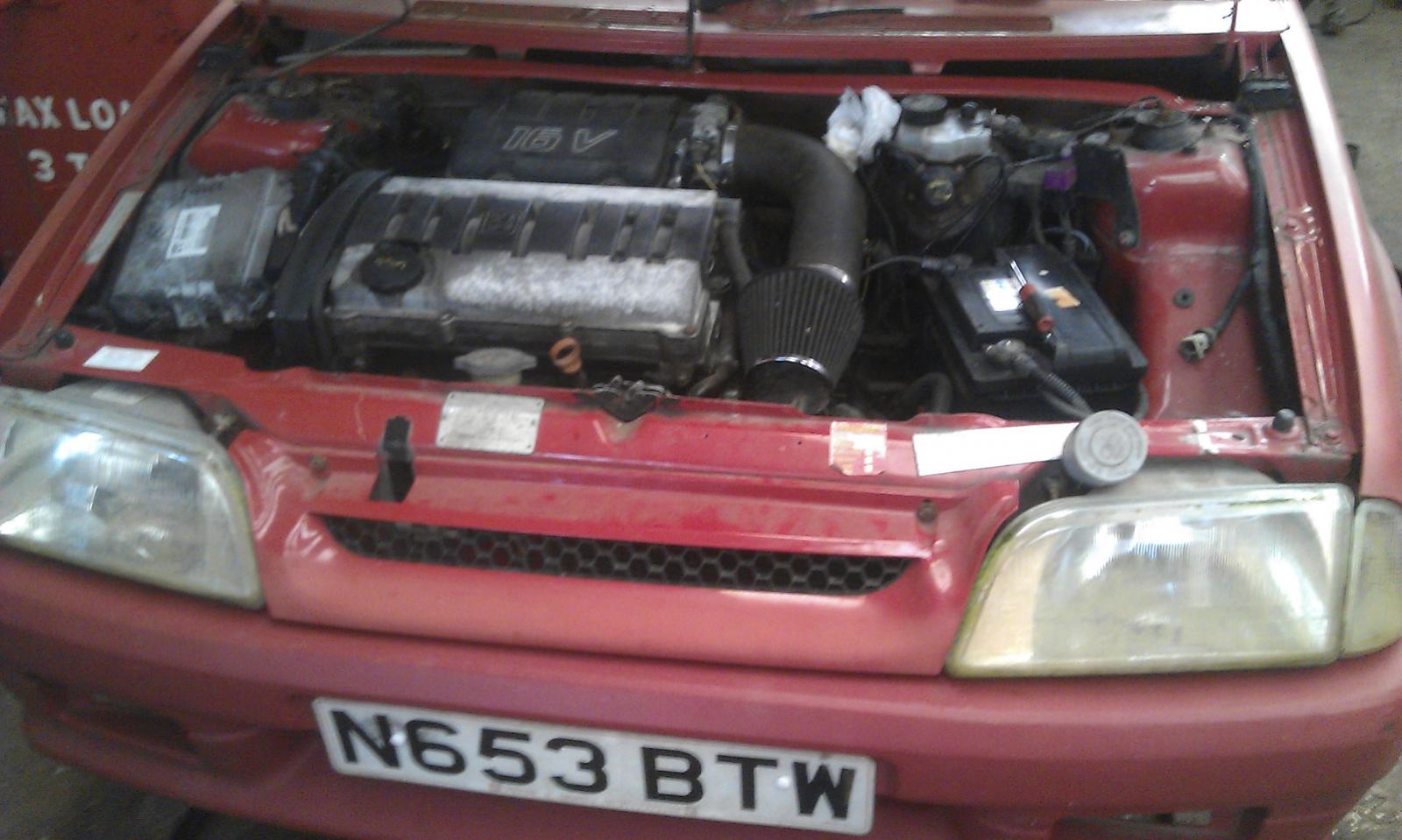

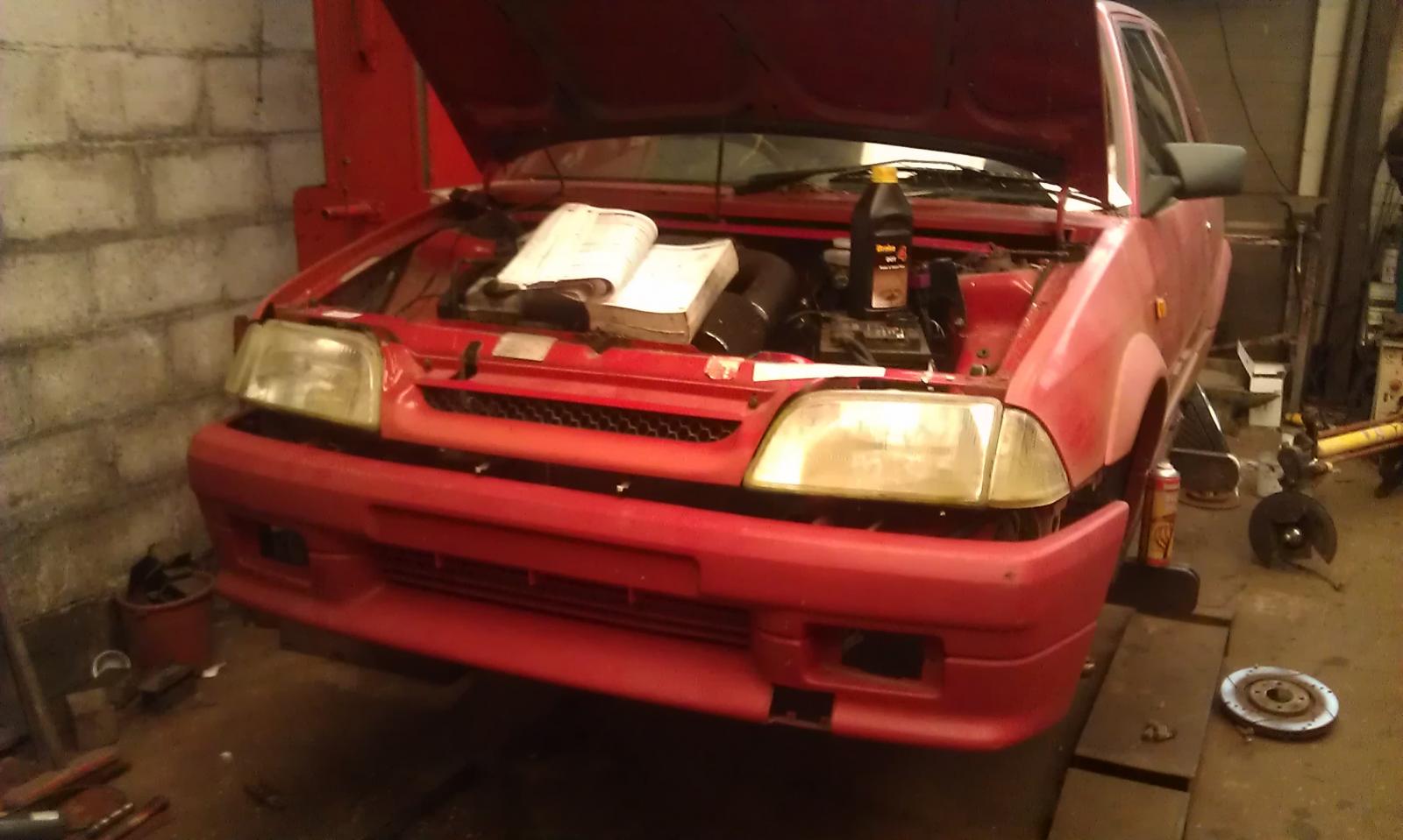

Newer front bumper on, new cambelt fitted, just waiting on some washers for the new belt housing bolts before the start up.
Makes a bit of a difference, no?

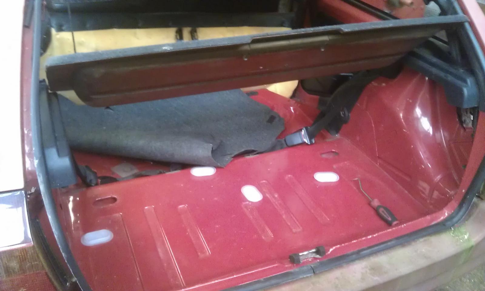

The boot floor is probably is the cleanest of paint on the car just now, here I have been tightening the axle mounting bolts up with the weight back on the wheels.

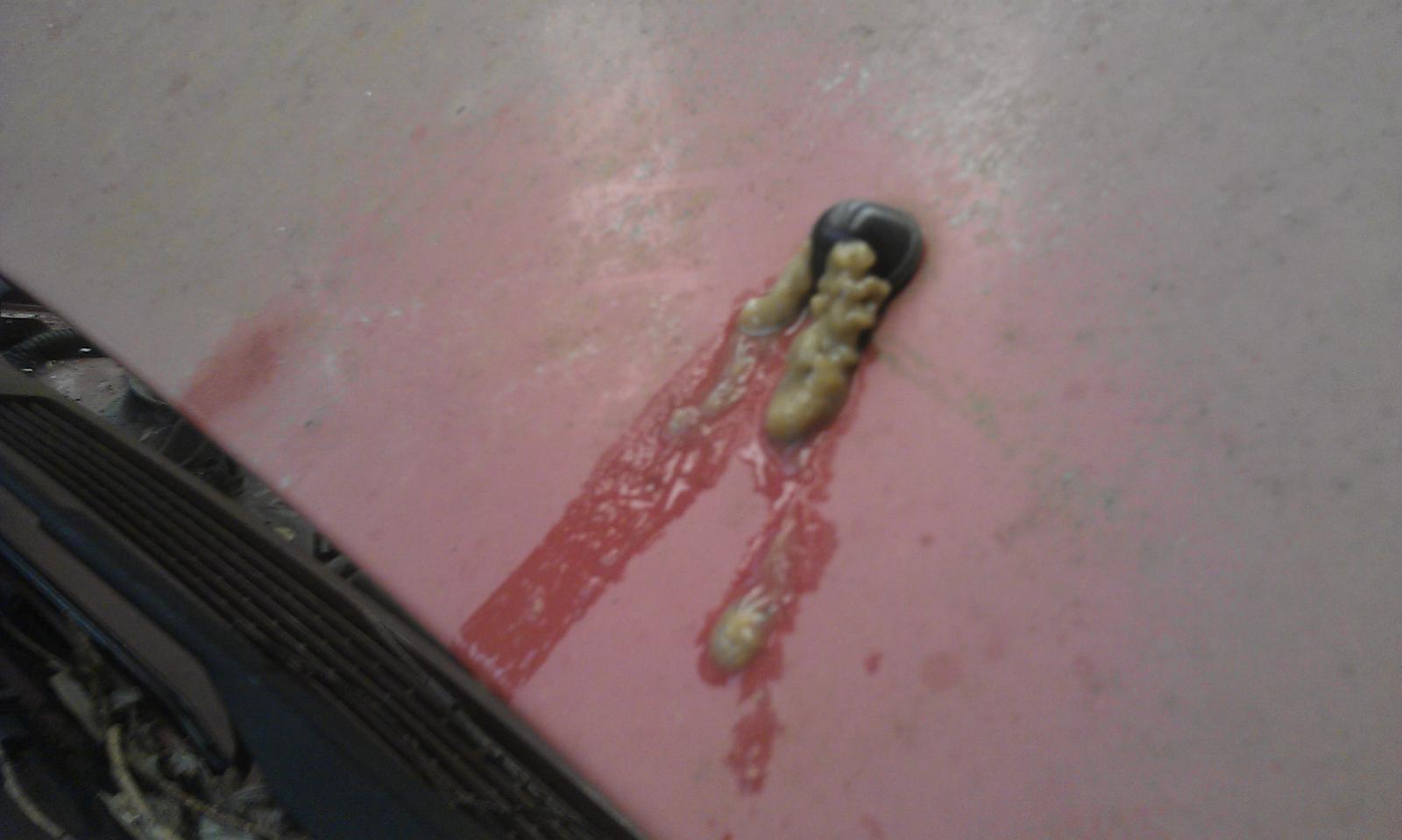

..ok? yeah, this is what happens when screen wash sits in the pipes for 7 years:

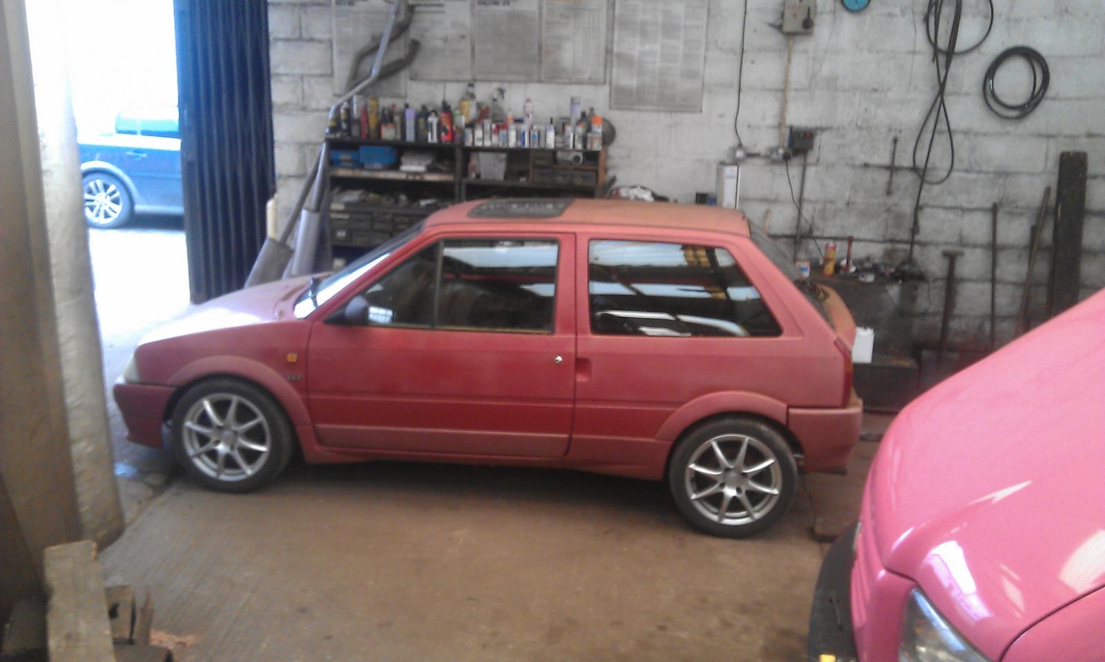

On the plus side, we get a look at the car's new ride height with the back axle swapped:

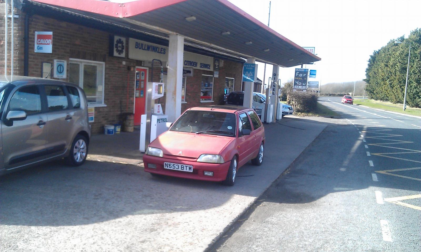

So this happened.
It's legal, lethal and Audi baitable.

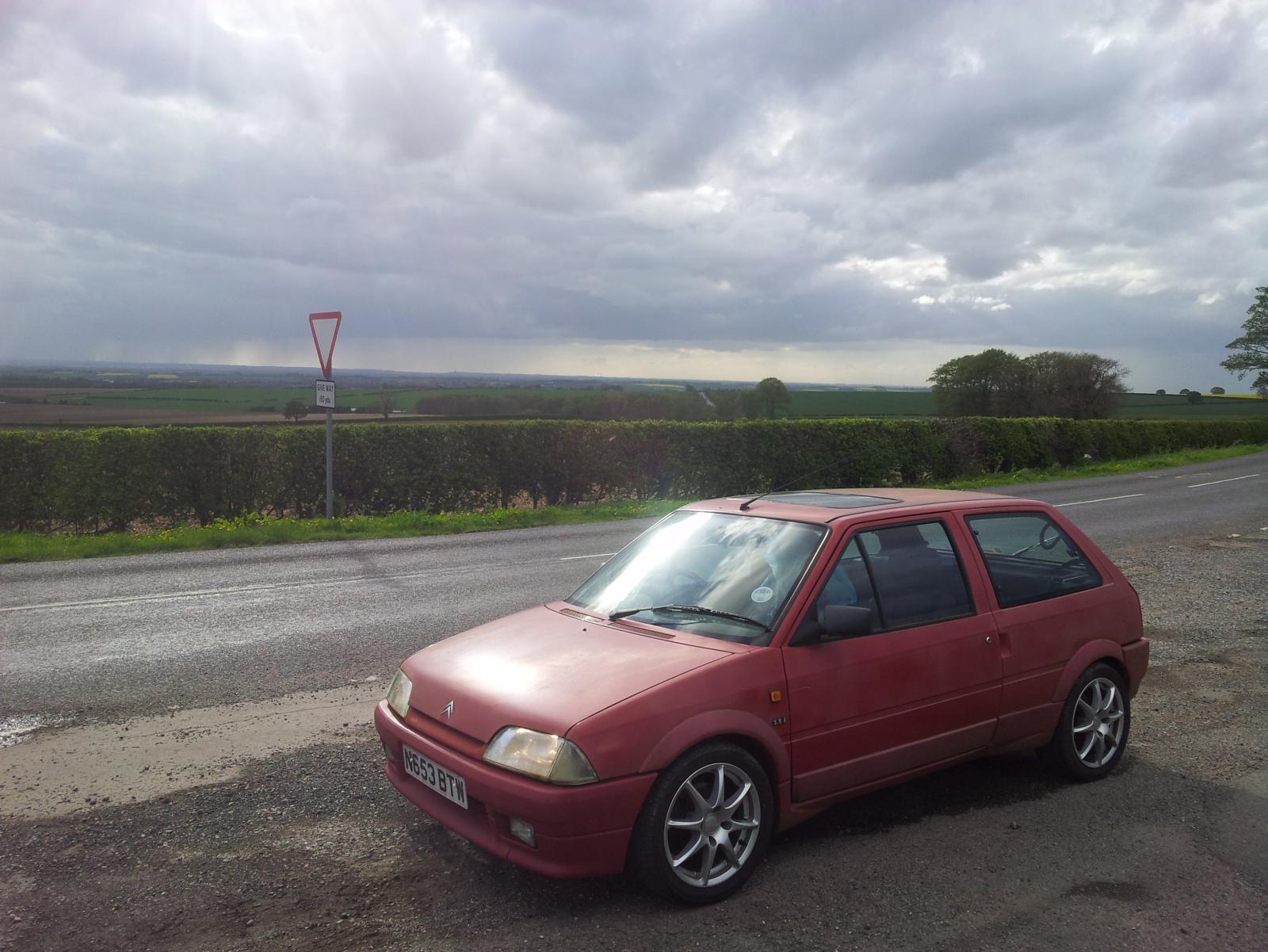

After over 7 years, it's back.
Well done, that is superb work. I hope you get to the bottom of thw whine, or just turn the wireless up a bit.
I love sleepers.
I know it's not the point and not my motor, a set of steel wheels to make it look more povo spec would really lure in the barry's...
I don't normally like aftermarket wheels, but they really suit it IMO!
Thanks chaps!

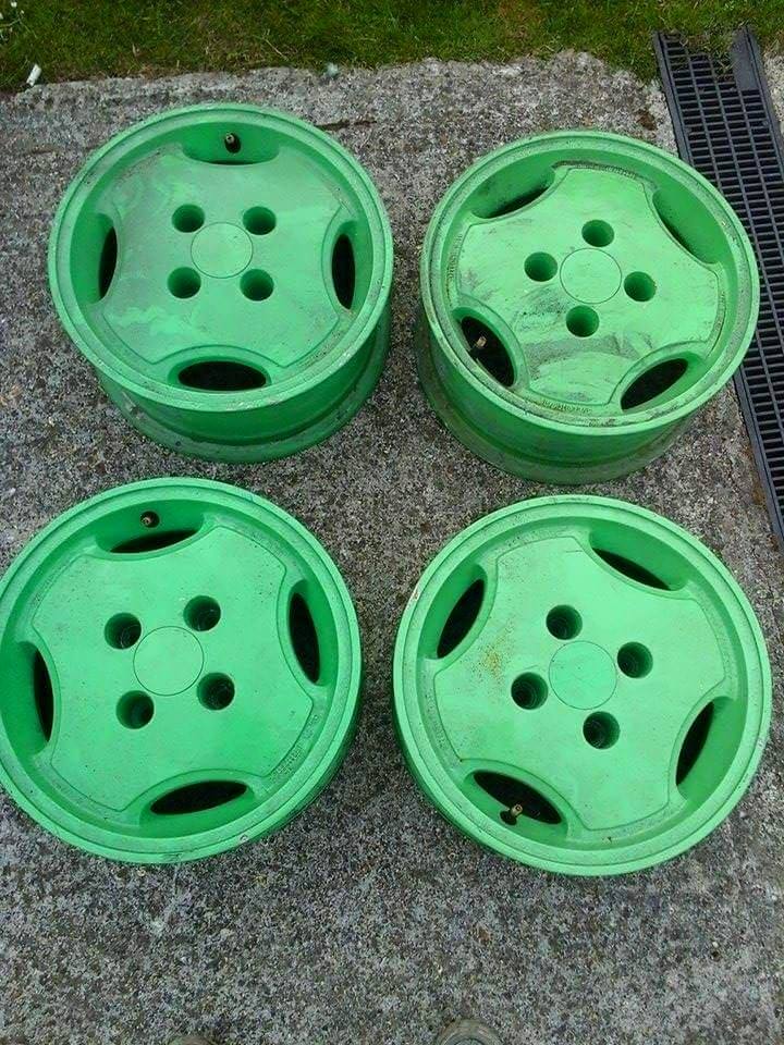

I'm hoping to find some smaller wheels simply because it rides so poorly on the 45 profile tyres, that and it's prone to tram lining with them on, I've got my eyes out for either some Berlingo van steelies or some similar 14" alloys to those already on the car.
Nice work-always good to to see stuff with a backstory get back on the road!

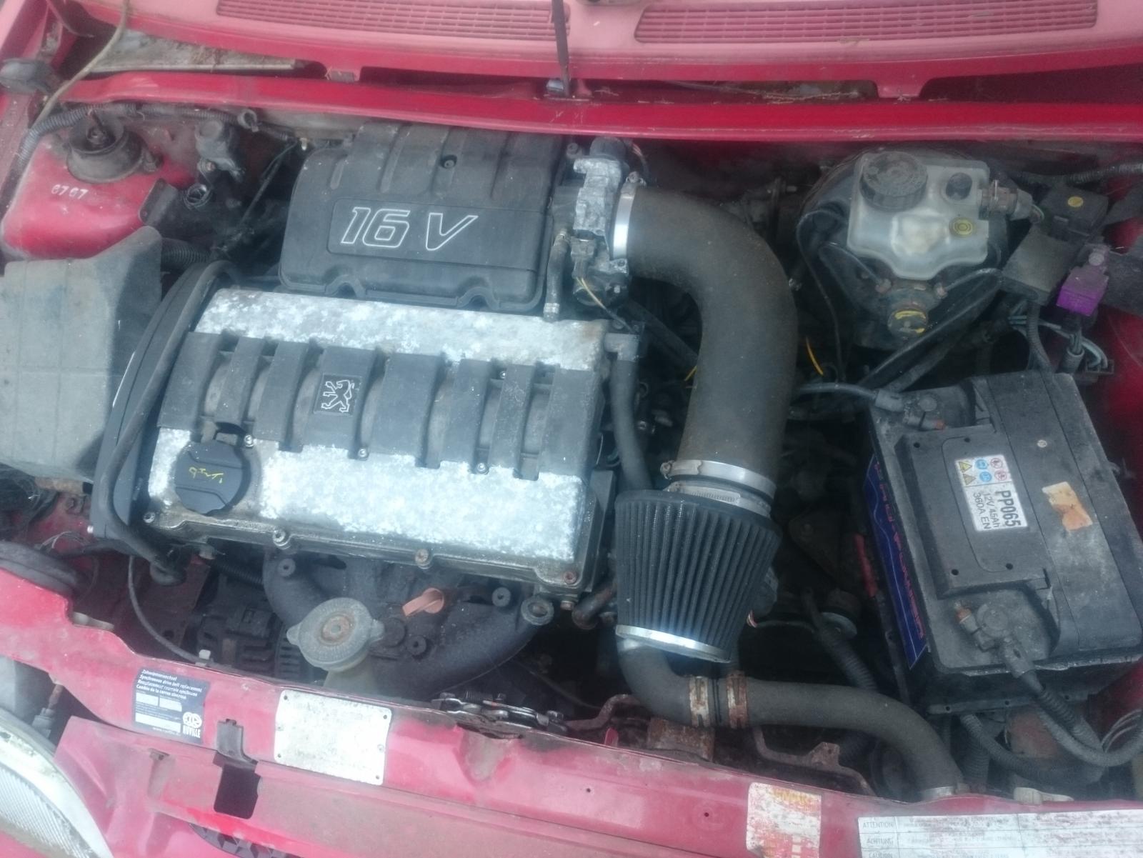

Anyhow with thoughts turning towards better weather(!), I have put in a bit if work on the ax today.
One of the problems with a fair weather car is you forget the niggles once it has been off of the road a while.

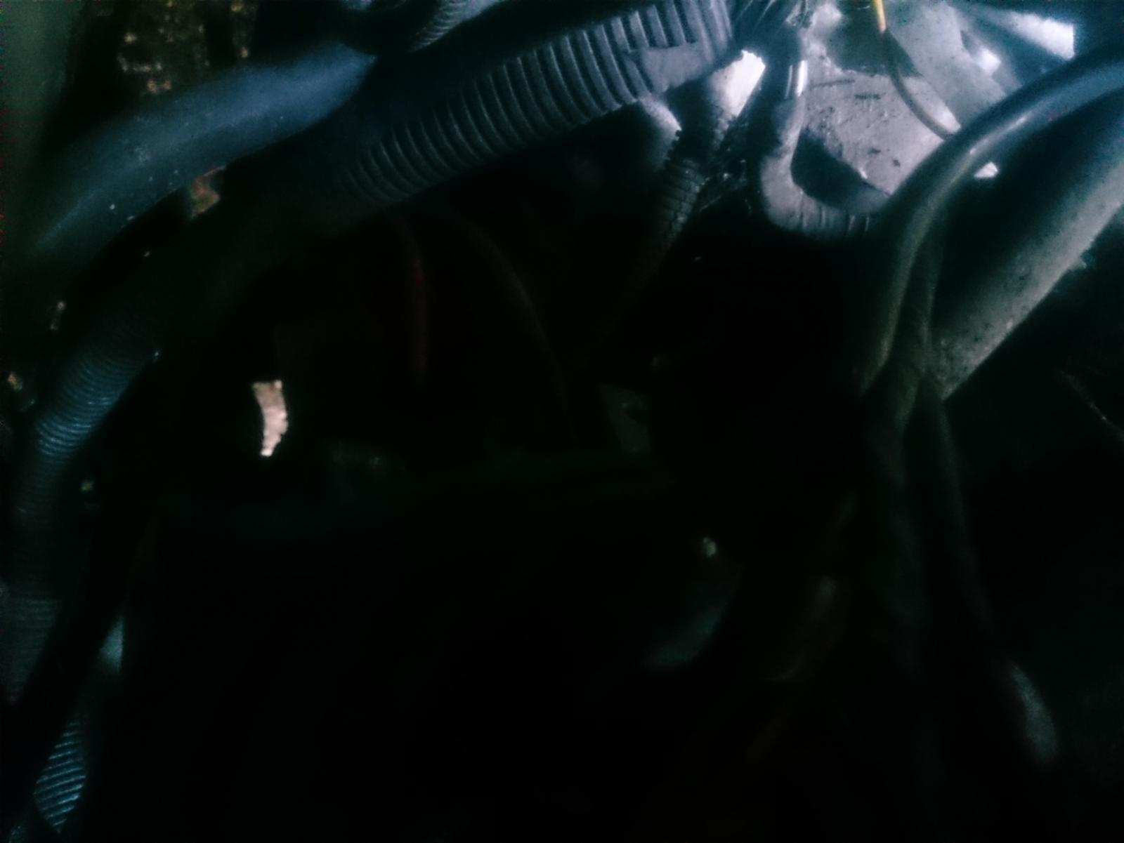

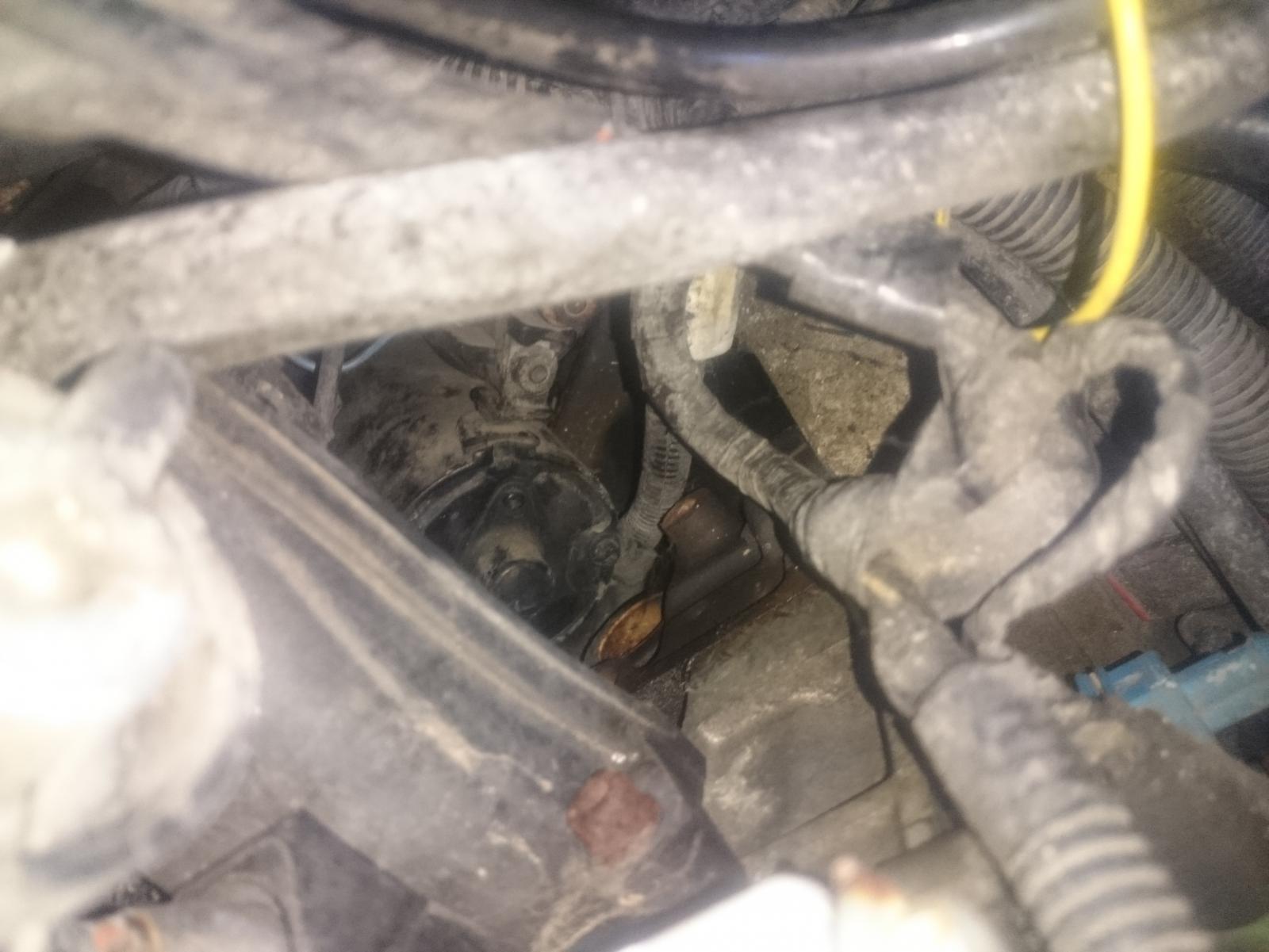

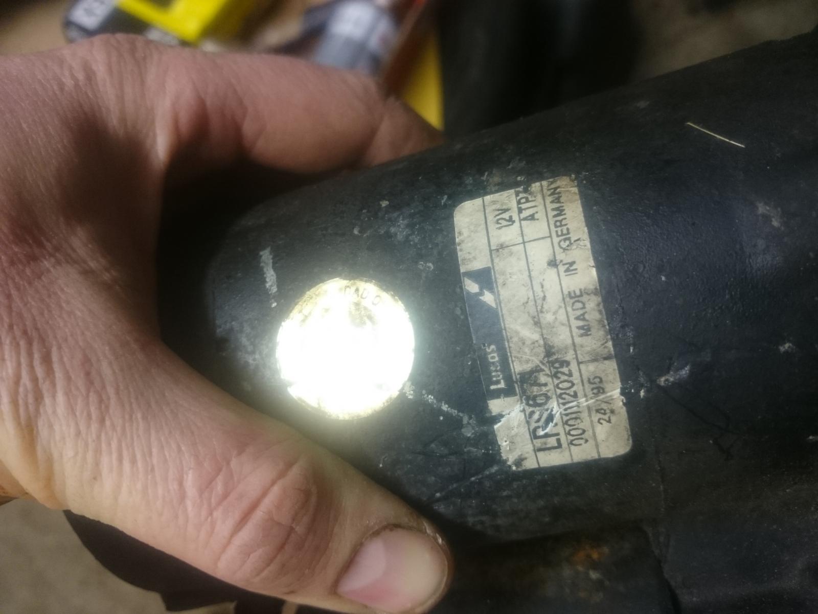

One thing I do remember though is that the starter motor was rather reluctant at times, and so today I made it my mission to get that off.
It's in there somewhere...
Hiding under the inlet manifold, deep in the back of the engine bay.

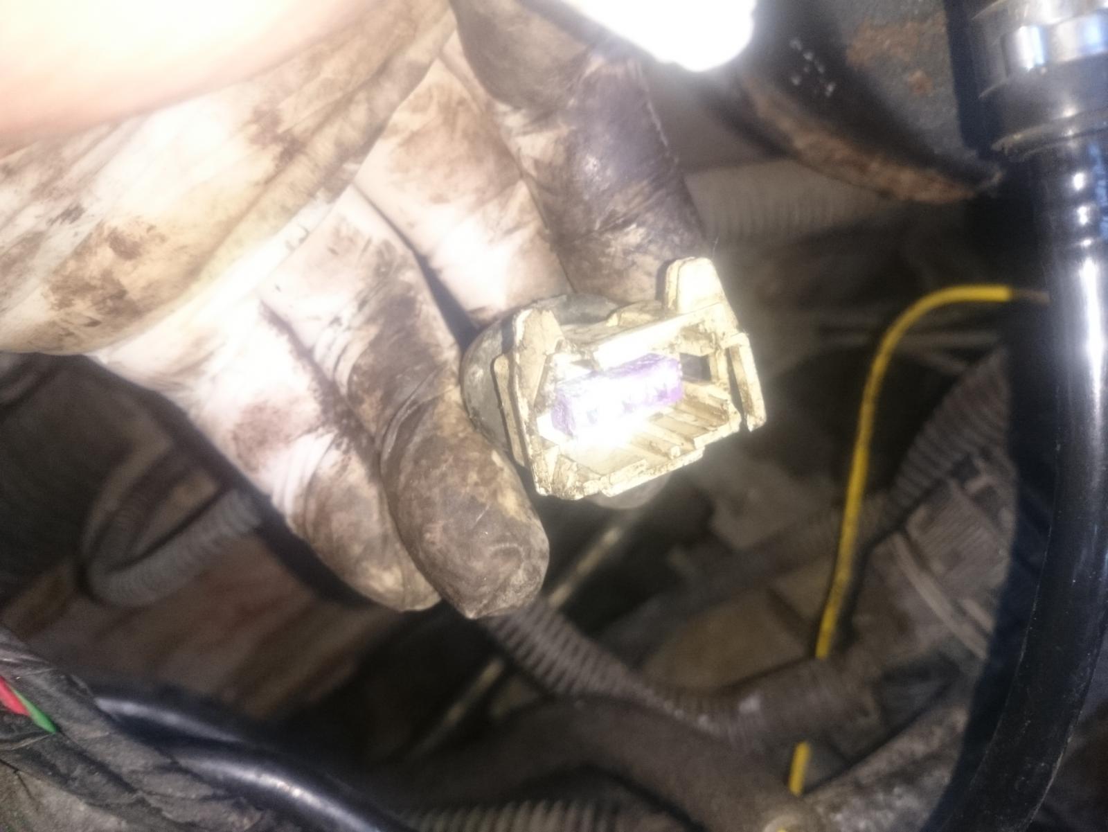

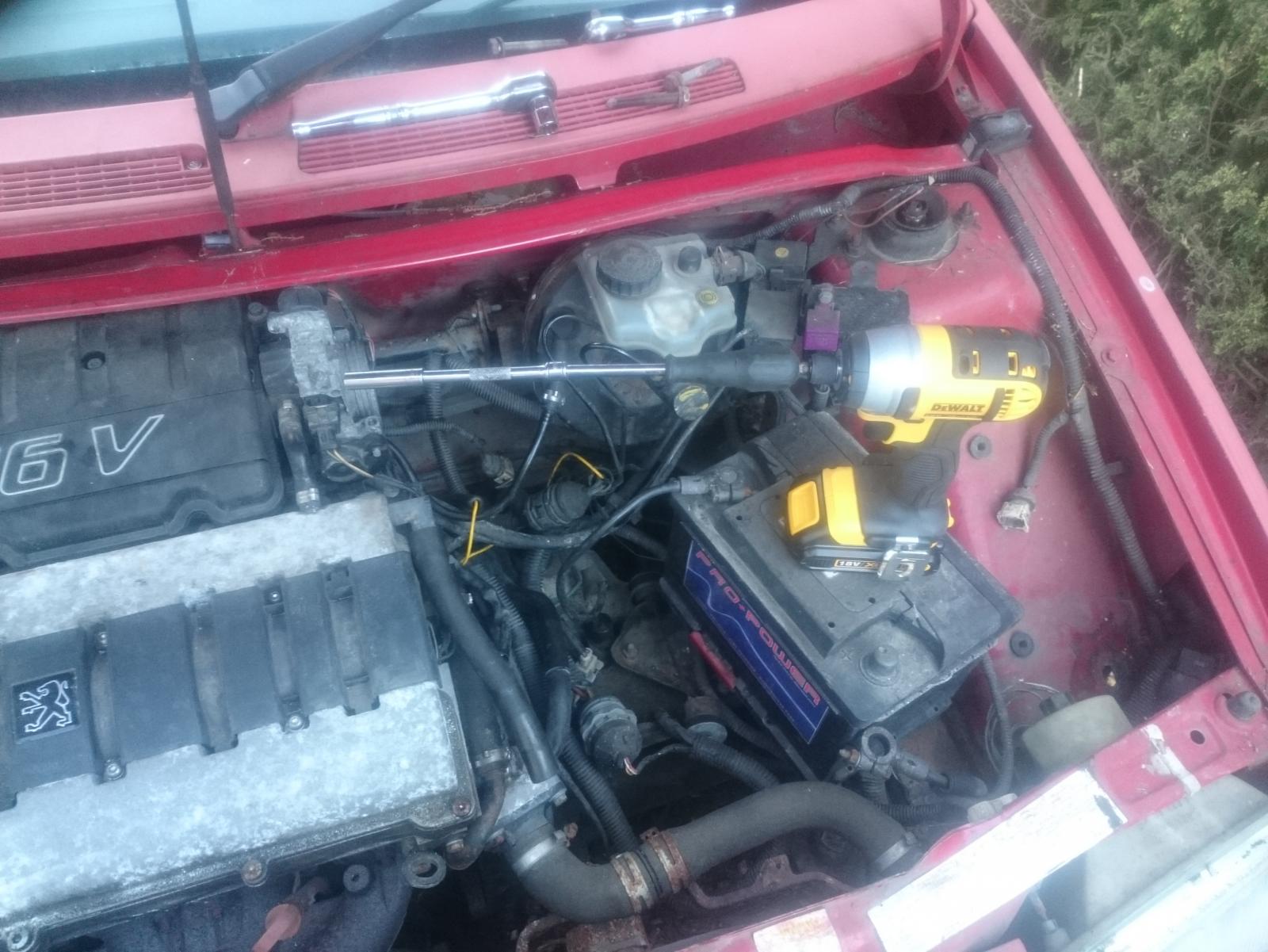

Three mounting bolts and the main feed removed, couldn't for the life of me feel the exciter wire though until I'd got the starter off.
Couldn't get the bloody thing undone by hand and so I employed the latest tool I bought a few weeks back. It soon had the nut freed off!
Also found that the speedo plug is well mashed, I'll have to find a suitable replacement for it.
Eventually wrestled the little bastard off, I'm going to research the number and see if a diesel on will fit.
I've also knocked up a bracket which will hopefully address the belt/pulley rubbing on the cambelt cover.
I'm going to try and rescue a starter from a scrapper at work, and then think about pulling the fuel tank off.
