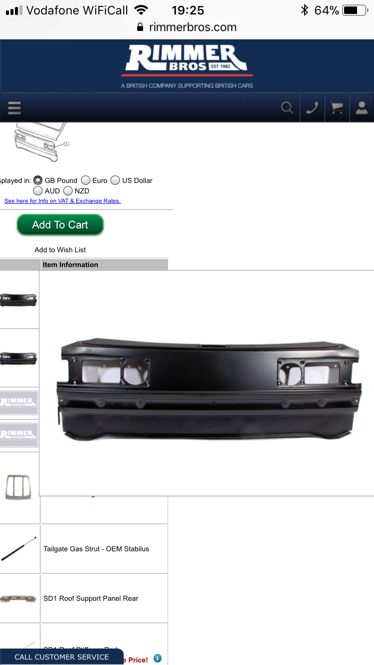

Skizzer Posted December 17, 2017 Author Posted December 17, 2017 Thanks for all the suggestions. I’ve tried Plusgas in the lock (always a good first thing to try); I’ve tried removing the vent panel that runs along the lower edge of the tailgate to see if it gives me access (it doesn’t);I’ve tried pressing down on the tailgate, pulling it up, both at once and all manner of wiggling things around, also trying to reset the central locking;I’ve tried lifting the rear seat base in case it helps with releasing the seat back (it won’t);The light units don’t have external screws (because David Bache was too much of a design purist for that) and I haven’t smashed one because I think the aperture will be too small and too far away, like Father Ted’s cows only more so. I will give the Plusgas one more go but otherwise next step is this: then this: I’ve ordered the panel anyway, because Rimmers are having a clearance sale on them (worryingly) and the one that’s on there is about 30% fibreglass anyway. In the meantime I’ll just be chucking stuff on the back seat and doing without the toolbox that’s shut in the boot. Coprolalia 1

Skizzer Posted December 17, 2017 Author Posted December 17, 2017 It would, but it is One of the best bits of the car, in fact, because it’s not made of low grade steel that rusts from the inside. Talbot 1
D Spares & Tyres Posted December 17, 2017 Posted December 17, 2017 If all else fails I would cover the rear screen in parcel tape then smash it. Should be easy enough to find a screen. Certainly easier than cutting up the rear panel!
Skizzer Posted December 17, 2017 Author Posted December 17, 2017 Your logic is good, but breaking the screen won't help - all that would do is give better access to chopping up the parcel shelf, which I'm not going to do. If it did help, I could remove the screen non-destructively (with luck) by unsealing the seal. The parcel shelf is a substantial thing that sits between the tailgate lock/latch and the world above, and is held down by the tailgate frame and the immovable rear seat back. There are no access shortcuts that don't involve cutting metal, except possibly picking or drilling the lock if (big if) that's where the fault is. D Spares & Tyres 1
