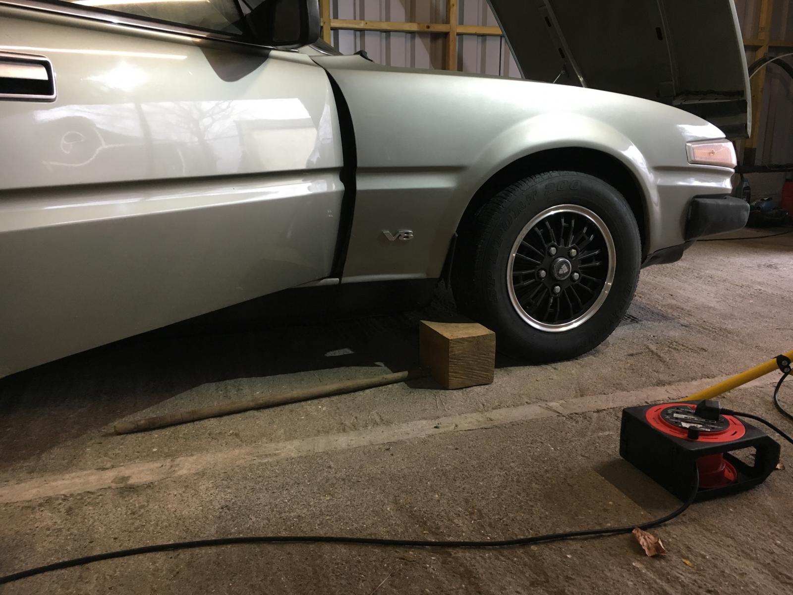

Skizzer Posted February 19, 2017 Author Posted February 19, 2017 FOOKIN' A. Thanks for all the advice: rolling it forward in 4th gear with the plugs out did the job in about five minutes, once I'd figured out a chocking arrangement to stop it rolling back to where I started from: That's the broom handle bonnet stay from the XJ-S, no longer required since I fitted some genuine BL gas struts. Until they start sagging too. Update shortly when I hit the next basic junior apprentice problem. (Shite fixing LIVE!) Angrydicky, mat_the_cat, Magnificent Rustbucket and 6 others 9

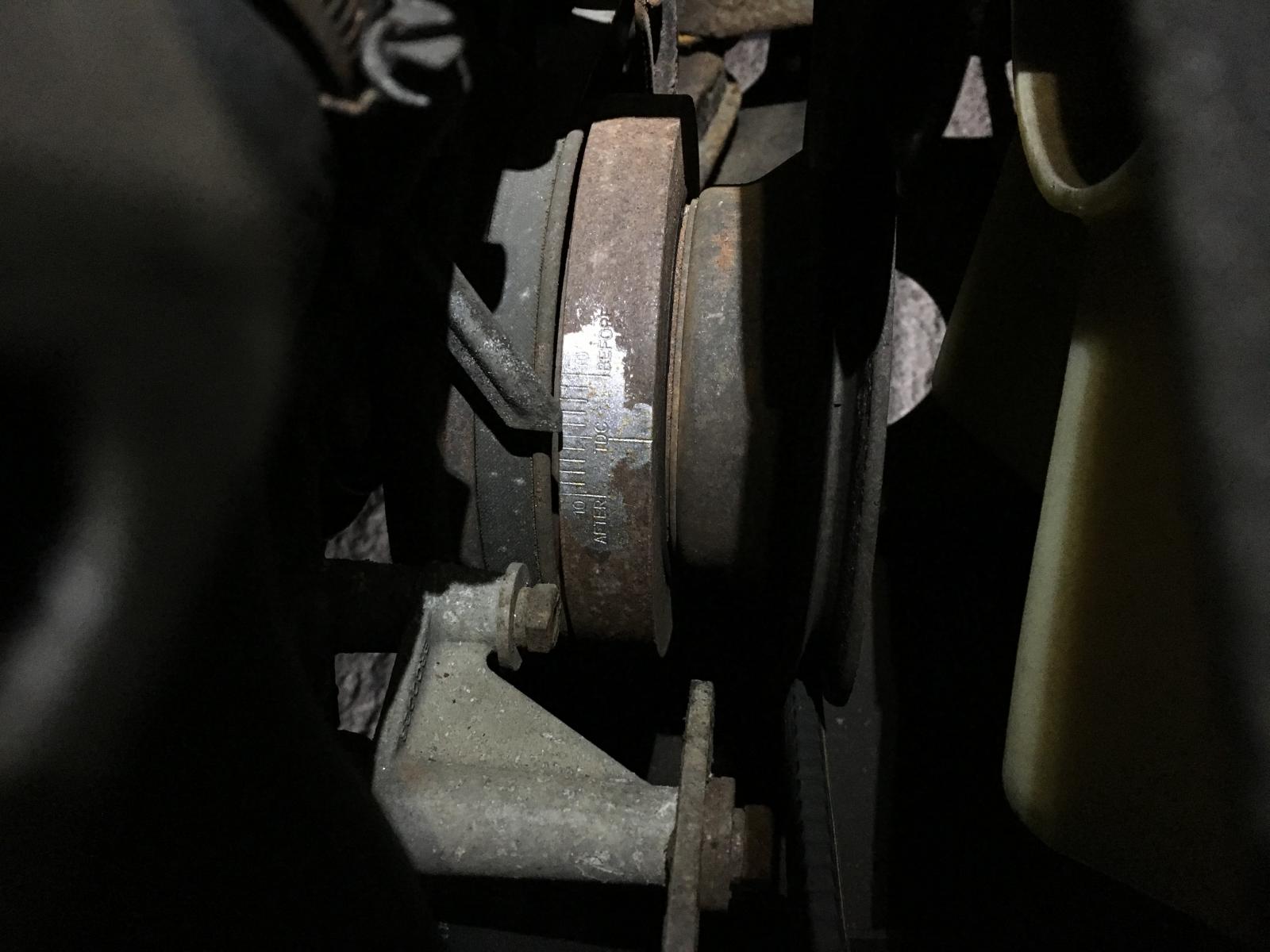

Skizzer Posted February 19, 2017 Author Posted February 19, 2017 Hmm, with crank pulley at TDC (see incontrovertible photographic evidence above), rotor arm is pointing at number 6, which is supposed to fire fifth not first. * sigh *
Noel Tidybeard Posted February 19, 2017 Posted February 19, 2017 time to play musical chairs with the leads
Conrad D. Conelrad Posted February 19, 2017 Posted February 19, 2017 Double check it's TDC on the compression stroke, not exhaust. alf892, Magnificent Rustbucket and Skizzer 3
Skizzer Posted February 19, 2017 Author Posted February 19, 2017 Double check it's TDC on the compression stroke, not exhaust. Ah. As long as i put it back the way I found it, all will be well though, right? We'll find out once I've soldered on some spade connectors.
Guest Hooli Posted February 19, 2017 Posted February 19, 2017 Yip if it pointed at 6 when you took it out, then point it to 6 again when you put it back.

Skizzer Posted March 26, 2017 Author Posted March 26, 2017 Finally spring has arrived and I had a whole day off work yesterday for the first time in ages, so I've been out and about in the Rover. First sunny weekend (Rover 3500 SD1) by Skizzer, on Flickr The timing is still a bit off following the distributor replacement. It idles ok but is a bit hesitant when pulling or cruising at low revs; then it's fine (joyous, in fact) from about 3500rpm upwards. Stale fuel won't be helping but first suspect is the timing. My Timestrobe (which belonged to my father and so must be at least 30 years old, probably more like 40) isn't lighting up the barely-visible timing marks clearly enough so I need to attack the crank with some Tippex to show up TDC better. Also the vacuum thingy on the new dizzy fouls the radiator top hose mounting so it appears it won't rotate far enough round. Are all Intermotor parts somehow wrong/broken/shit, or have I just been unlucky? RobT, Conrad D. Conelrad, trigger and 8 others 11
