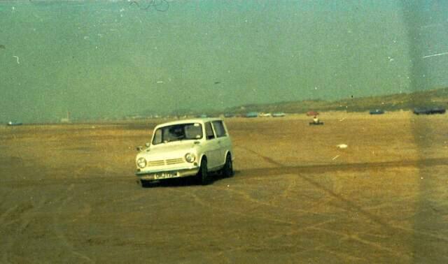

Here it is "driftin" on Ainsdale beach with all that extra power in the early 1980s:

In the summer of 1983, I finished my A levels and along with two mates from school, we took it on a 4500 mile road trip around France and Spain.  (Why go Interrailing when you can travel in style eh)?!
