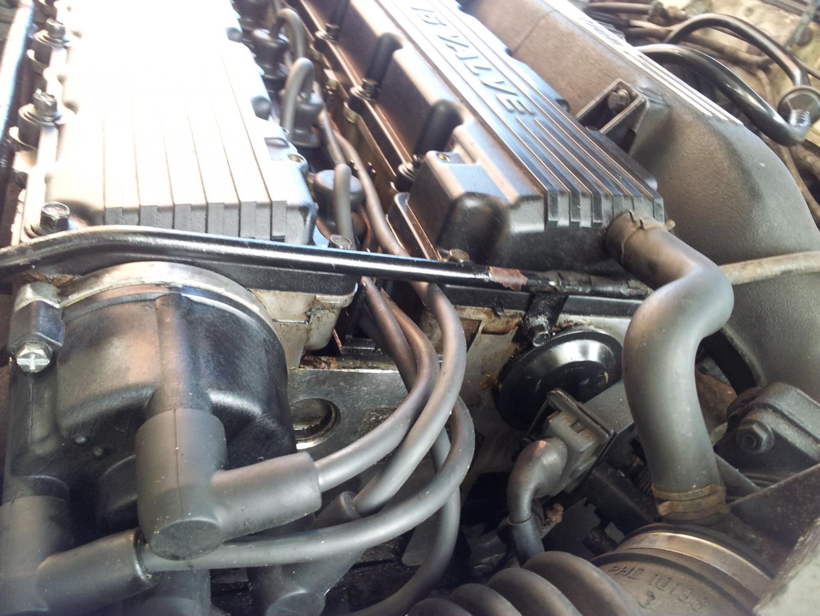

phil_lihp Posted July 29, 2015 Author Posted July 29, 2015 Right then, not time for the big mending session to start yet but there is unexpected work to be done; for the first time, the 220SLi is poorly. I haven't been using it much lately but I've been noticing for a couple of months that when starting from cold it's just a little bit hesitant, just not quite 'right' but nothing I've really worried about. However, very quickly over the last week this has deteriorated to a lumpy misfire from cold for about 2-3 minutes. If revved, it sounds fairly OK but the idle is unsteady and it bogs down on acceleration, then once it's got to a certain point it suddenly runs more or less fine. I did take a video tonight but it's too big to upload off the phone, I'll try again tomorrow. My first thought from some research online was the dizzy cap and rotor arm - I've never touched either of them. Tonight I took the cap off and it was a bit mucky but not terrible, I've cleaned the contacts on the cap and arm with sandpaper, then gave the whole lot a good cleanup with some brake cleaner so it's squeaky clean but it's made no difference at all. I will get these changed anyway at some point as they're past their best. Now I know the spark plugs aren't that old, the oil is reasonably clean as Essexman changed it a few months ago and it's on the midway mark on the dipstick, the plug leads *look* absolutely fine and it has had some decent long-ish runs lately together with a bit of an italian tuneup but if anything that seems to have made things worse. My concern is that the engine, now on 200,000 miles or so, might be showing signs of wear. It doesn't smoke (that I can see, anyway) but there is some indication on some forums I've seen that the T-Series is prone to sticking exhaust valves which can cause this sort of thing. Other than throwing a complete new set of spark plugs, HT leads, rotor arm and cap at it, what else might be worth looking at? I have my doubts about any of the ignition parts being at fault because it seems to be dependent on the engine temperature and I'd have thought if any of these bits were to blame it would affect it all the time. This is outside my limited experience and knowledge so if anyone has any suggestions on where to start with the troubleshooting before just replacing parts ad hoc, I'd be much obliged.
Honey Badger Posted July 29, 2015 Posted July 29, 2015 Do they have a cold start valve on the throttle body. Could be worth looking at.
mrbenn Posted July 29, 2015 Posted July 29, 2015 Any coolant loss? Might be worth pulling the plugs to check their current state.
phil_lihp Posted July 30, 2015 Author Posted July 30, 2015 No coolant loss, plugs will come out tonight if I get time, ran out of daylight last night. Cold start valve: maybe, can give it a cleanup but not sure how else to diagnose it. To be honest, to my untrained ear it sounds like it's running on 3 rather than over/under-fueling but I have been wrong before.
oldcars Posted July 30, 2015 Posted July 30, 2015 Do these have a vacuum advance? Could be perished pipe conections, happened on the reliant.
Mr_Bo11ox Posted July 30, 2015 Posted July 30, 2015 they dont have a vacuum advance as such although there is a vacuum pipe going to the ECU. Pulling the plugs sounds like a good idea to me, plus maybe cadging a compression tester and giving that a whirl, see what that tells you. Also start it up from cold when its dark and inspect all the HT ignition bits for escaping sparks. I fitted new HT leads when i had it but they must have done a lot of miles now so might be getting tired dollywobbler and oldcars 2
phil_lihp Posted July 30, 2015 Author Posted July 30, 2015 Do they have a cold start valve on the throttle body. Could be worth looking at. I think you might be on the money here, I went out to it tonight to pull the plugs, got as far as taking the leads off and then found that the spark plug wrench I need is missing, presumably still at my parents where I used it last. I put the leads back on, started it up...and it ran perfectly! For about 30 seconds, then settled to a lumpy idle again. I left it for 5 minutes to warm up and when I came back out it was idling smoothly again. I'll also take back my fears about engine wear, there's not even a slight puff of smoke at any point and no rattles at all from the engine, in fact it sounds lovely and smooth once it's warmed up. I went out for a test drive and treated it to £20 of BP Ultimate, then had a little sunset hoon and remembered why I like this car so much, it steers and rides brilliantly, goes like stink but at the same time is just so comfortable. This all confirmed that it's running absolutely perfectly once warm so it's just a cold start issue, not a particularly pressing one either so I'll get to it when I have time but for now I'll live with it, otherwise it's pretty much as good as ever. The leads look perfect but if they're that old then that's another thing for the list when I have some spare readies for it. They're nice Bosch ones so it'll get the same again when I do. oldcars 1
Mr_Bo11ox Posted July 30, 2015 Posted July 30, 2015 Yeah I remember now, I bought some cheap ones off ebay but they were total bollocks so I binned them and got some Bosch ones that fitted properly.
Noel Tidybeard Posted July 31, 2015 Posted July 31, 2015 they dont have a vacuum advance as such although there is a vacuum pipe going to the ECU. check it aint full of oil- because rover
phil_lihp Posted July 31, 2015 Author Posted July 31, 2015 It does but I think it's probably OK - when I left it ticking over for 10 minutes the fans cut in at the right point and it warms up nicely without getting too hot.
