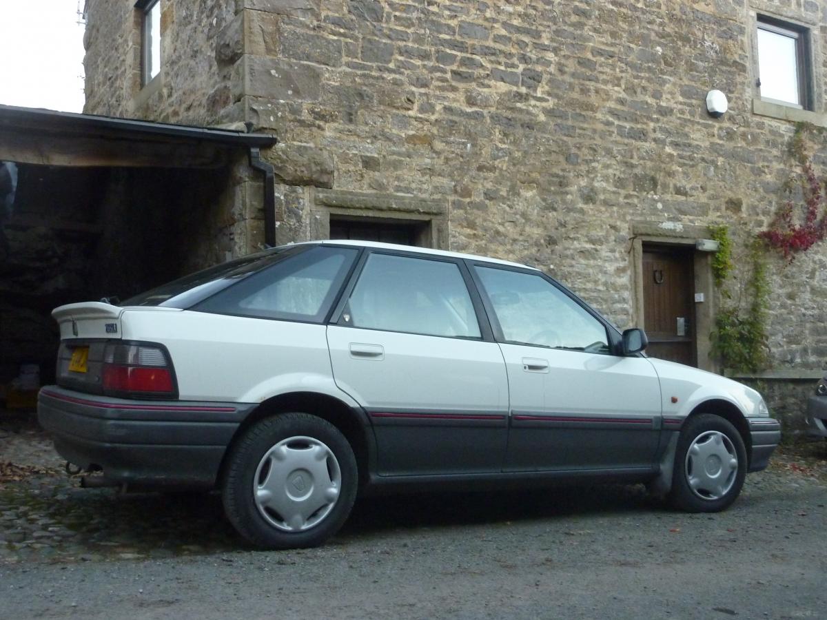

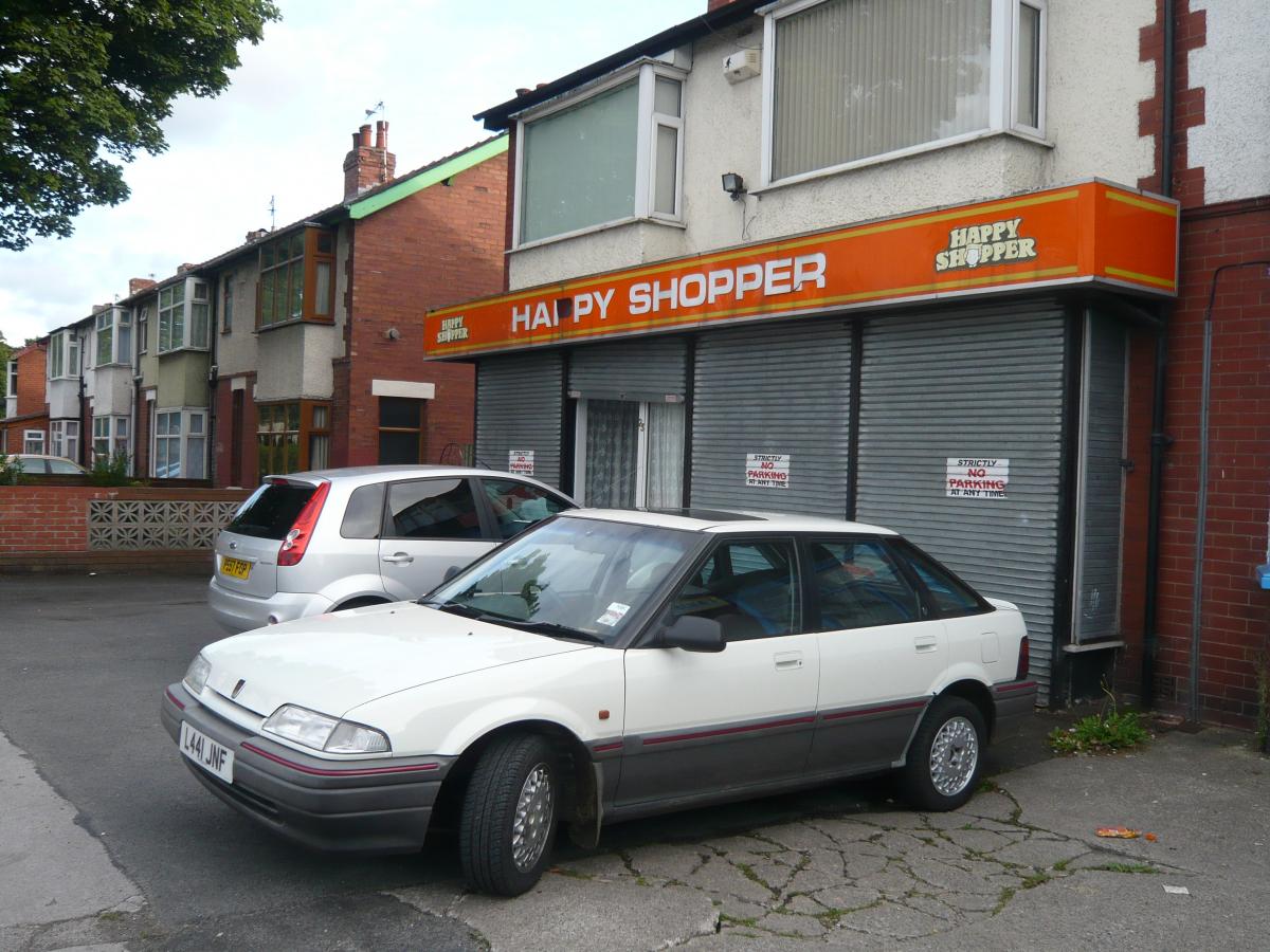

KruJoe Posted February 17, 2014 Posted February 17, 2014 ... Joe ... Rover hubcaps ... Yes, each of my three R8's came with a full set. The daily: The 214 breaker: The 'best' ones are the posh ones (like yours) which came on the red breaker from Chompy_Snake. Sadly for you I sent them off to Rover414 because he lost one, as you did. PM him, he may part with one or two - he now has seven! Or I could send you one of the less posh sets, but they're not in perfect condition. My daily is still on the povvo ones to confuse the Rover nerds... ...while I work out how to attach the centre caps on my GTI rimzorz. I just thought this page needed some R8 pics saucedoctor and Jim Bergerac 2
phil_lihp Posted February 17, 2014 Author Posted February 17, 2014 It does, and I notice we have matching primered rear N/S arches I'll PM rover414 and see what he's willing to part with, otherwise I'll come back to you, thanks! They're not the nicest looking trims IMHO but they are original so might as well stay with the right ones I guess. I actually think the povo ones look the best, strangely. Quite fancy a set of those mudflaps now too...hmm. Will keep an eye out for some of those on ebay when £££ are spare. Not incidentally, this proves beyond a doubt that the original front end is considerably better looking than the later chrome snout mine is wearing. Much cleaner and simpler.
