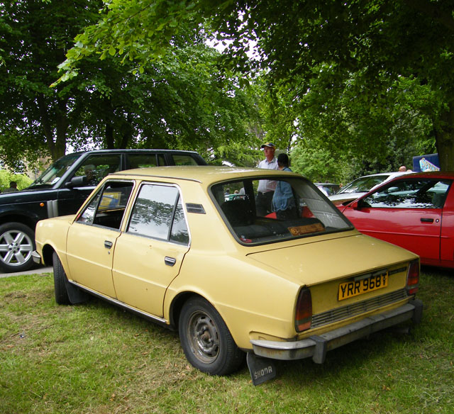

On account of the Skoda and the location I think you're who I think you are, but I might be wrong and if you are who I think you are then for some reason I thought you were called Kyle, not Ron.  So, are you who I think you are or are you someone entirely new who happens to be in Chesterfield with a brown Skoda?

He may well be who you think he is, although the person he is, has a yellow Skoda, not a brown one.
So maybe he is not who you think he is, but is someone different.

Well I say brown, what I actually mean is brellow.

Tis I indeed vulgalour man ! aproximatly 0 other people in chesterfield have a biege mk1estelle haha
