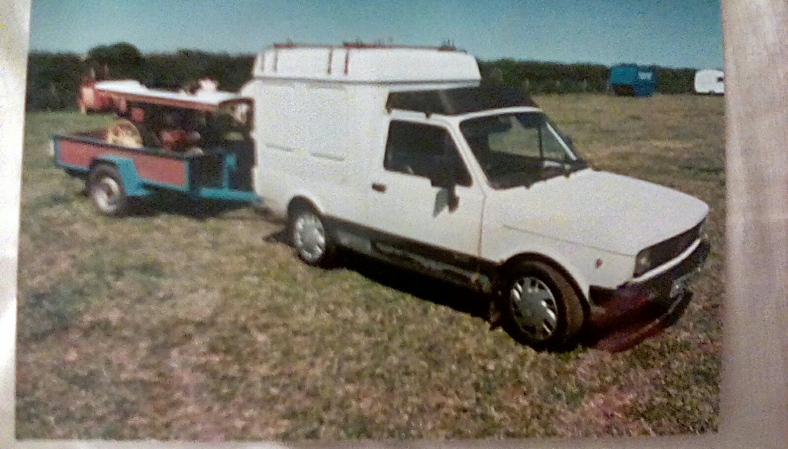

To keep the thread going,here's my dads Fiorino s promised on page 2 :-)
Great picture, Thank's for sharing that. I've got a set of them lookalike Astra MK3 trims too!

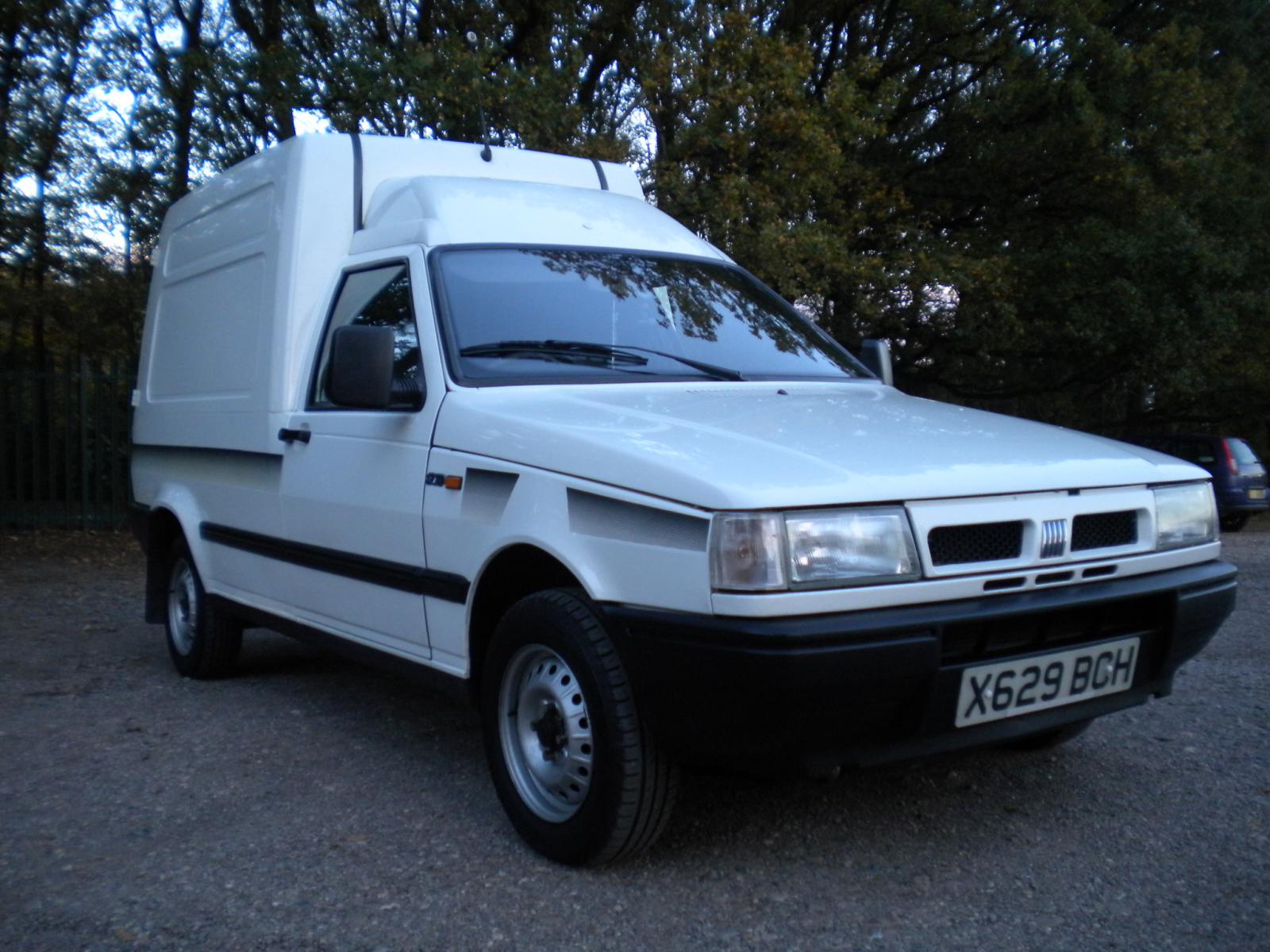

Thought I'd add a little update on our Fiorino.  :-D
Well since the last time I posted up about the Van over a year ago. Not too much has changed.
It's been through the Mot again back in April. Which I had replaced in advance the Front Pads and Discs as both were very low and a lower arm, as the bush had gone. Passed 1st time with just a few advisories.
Then a few months later the drivers door side scraper moulding fell off. It hadn't really fitted back right since the front doors were swapped over. Didn't have a spare one annoyingly and ebay etc was no good.
So my brother popped into a Fiat Dealer for me. The drivers side is NLA but the passanger side is. Taking a punt that both were identical, I got him to order the passenger side moulding at a cost of £33.
Anyway after having a right faff trying to get the moulding to fit correctly back on, so it wouldn't fall off when I wound the window up. Which involved a lot a flat plastic trim tools and a small hook. It's on and fits fine so well pleased with that little job.
I've also for the time being removed the roof bars, as they were rusty and leaving rust streaks down the sides. Plus we hadn't had the need to use them since it been back on the road. Just about got the bolt's out, as they have been in 17 years. An have refitted the original bolts in the roof that my dad had stashed in a old mint tin.
The Van's engine mounts have been on the to do list since we got the van back on the road. About September time I helped move some unwanted sand bags from my Grandads house. This was too much strain fully loaded on the mounts, so had to look into replacing them.
The left hand and right hand mounts were easily sourced through a Fiat specialist on ebay at £16.99 each. The rear mount proved more difficult to source, so had no choice but to get one through Fiat.
Trouble was they wanted £201 !
So my brother managed to get the dealer to contact Fiat Directly via email, and after a week they wrote back and agreed to reduce it to a RRP of a £124.
The Fiat Dealer ended up selling it to us for a £101 all in after vat. So not too bad in the end.
Also on the to do list was the dipstick tube holder seal, which is a nice and awkward job as it jammed right in between the engine block and the inner wing. I tried replacing it myself last year and quickly found out that the engine mounts would need to come off and the engine would need shoving over to gain access.
So I temporary sealed it as best I could.
As the sump had now joined in on the fun, the Fiorino was leaving it's calling card everywhere I parked it. So decided to not use it much till I could afford to get the mounts and leaks fixed at a garage.
I've just got the Van back today and they had also found that the oil filter housing had a leak from another seal, after fixing the first two leaks. Only another £7.50 from Fiat this time. So along with the gasket's and mounts. It had a oil and filter change too as they were due.
Also I replaced the Glow Plugs myself last month as they had packed up suddenly. Real pain of a job to do but got there in the end.
Fingers crossed that little lot should see it through for another 12 months.

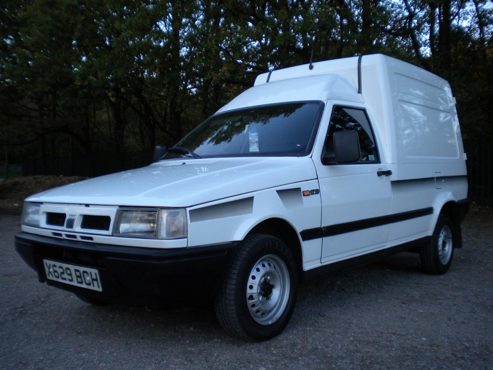

Here a few more photo's of the Fiorino taken this year.
Don't recall ever seeing one of those before.  It's a really pleasingly proportioned little van I think, and looks to be very tidy for a small commercial vehicle of that age that's not had a nut and bolt restoration done!
Super tidy
Thanks Mr B. The pictures do flatter slightly, as it doesn't show up all the touch up's to the paintwork as the paint chips easily. I can't complain though for a 17 year old Van, that has spent most it's life working in the building trade.
I did get asked last year if it had been resprayed, by a nice bloke who asked me all about the Fiorino in a brand new Range Rover. Who said the best Van he ever had was his Perkins Maestro Van.
I even washed it this evening to get all the Salt and dirt off despite the cold!
Cheers.  :-D  There is still a small number about including the Pickup version. But they aren't as easy to find as say a Citroen C15.
The extra height of the rear body certainly gives it an advantage over the equivalent Escort, which was one of the reasons my Dad brought it new. He could easily fit a Cement Mixer in the back sideways, and have just over half the load space left for anything else he needed. Which I tested out this year when we helped my Grandad lay a new base for a garden shed.
The Van's only none original panels / paint are the front doors as previously mentioned due to rust. The rest has just been touched up due to stone chip damage etc.
The rear doors do need welding or replacing as they are rotted out completely but the plastic trim hides it well for now.
Engine and Gearbox are original on nearly a 168,000 as is most of the suspension and exhaust system. Hopefully I'm not tempting fate on jinxing that.
