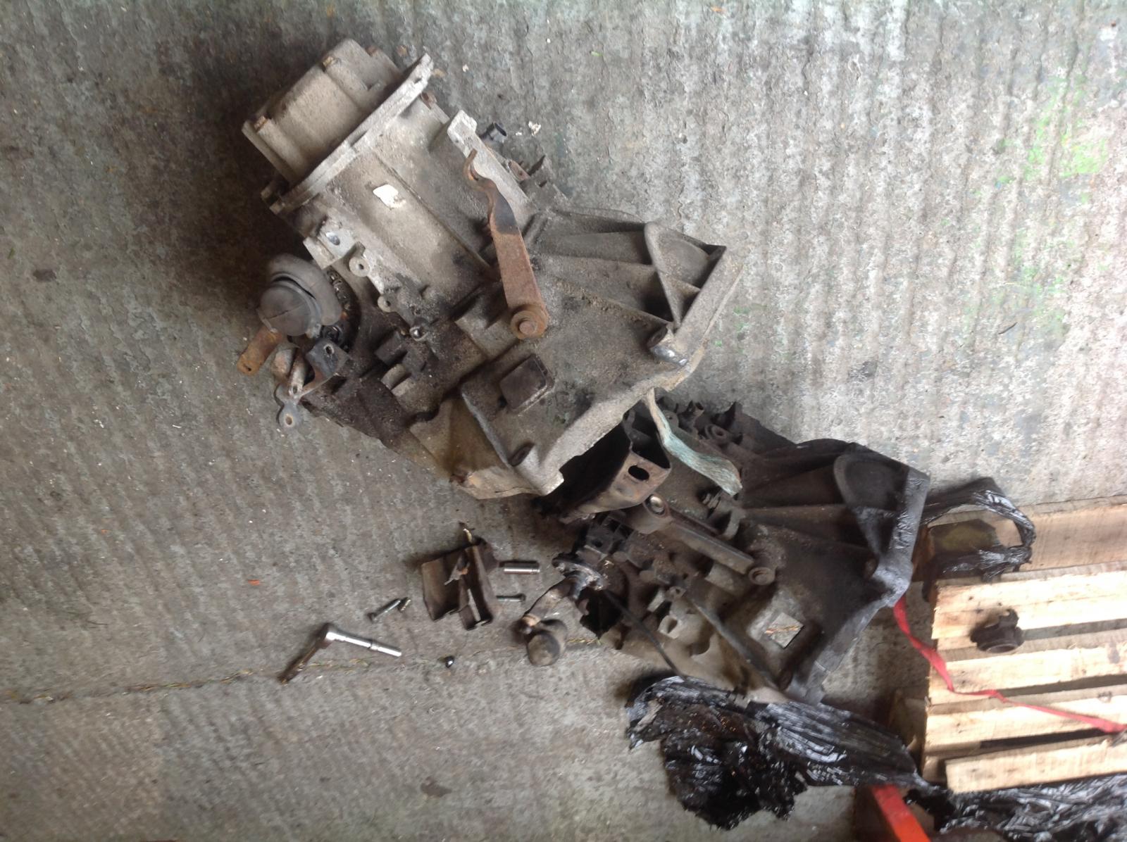

Here's the surprise.
1997 Fiat Fiorino 1.7 diesel gearbox, purchased from thief bay, doesn't fit my 1997 Fiat Fiorino 1.7 diesel.
All the bloody linkages are different, and I'm loathe to pull the box apart, so mucho budging, grinding, welding and assorted fettling yo fix it up.
Oh, and the clutch is borked. Completely. Happy days

If you're worried by the clutch cable, send the spare to Speedy Cables, based in South Wales someplace. Easy to track down, anyway. They'll make you up a copy pretty much overnight, although they aren't that cheap!
I just intend to use mine as a parts hauler, and a learning curve on diesels,visible I know nothing about them, and I've a truly obscure diesel to start on next summer.
