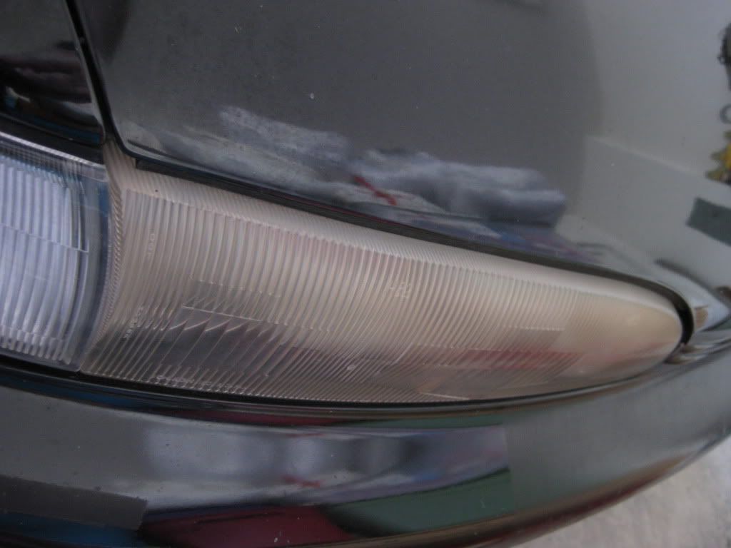

I had to clean up the light units due to UV damage last year as well - the lights worked just fine at night but the look of the car wasn't great.
Original state after 10 years of Florida sunshine (under our ownership):
Using a bit of elbow grease got them back up to this condition:
